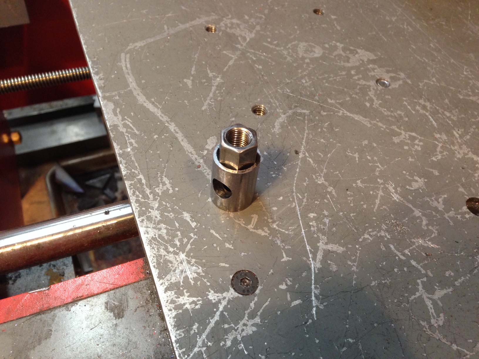

Wonder what others would do here.
My first bit of advice after reading these 5 pages is to use the tools you have as opposed to tools you don't have. Your MIG is perfect, and fits the above recommendation. It's much more efficient that way. :D Good reading though, lots of subjects mentioned.
But back to the title subject,,,,,
Don't jam it all the way into your counterbore, leave a little room to true it up in case it 'pulls". I'd tack one side. A good tack on a corner. Then screw it on and watch it rotate to decide if it's as straight as it needs to be, bend it straighter if necessary. Then weld up the opposite side and go all the way around. Nothing sequential is necessary beyond tack, inspect, weld. 3 steps.
Setting the MIG at 1/8 would be the MAX I'd use for this part, it's 1/16" thick. The little part barely has enough mass to absorb all the heat at a 1/8 setting. I enjoyed the comment where some fella advises about "not enough penetration". I make stuff like this all the time and the only recommendation regarding penetration is to do a test-weld first so you don't melt that pretty little thing. If you are unsure about wrecking it start at the next lower setting, like for 14ga, but 1/8 can work. Doing a couple test parts will tell you what setting you need.
Don't worry about it being "strong enough" just 3 welds (on 3 flats) is far stronger than it could possibly need to be. And could look nice too.

Where are you coming up with "1/16 inch thick?" Please look at both photos. Try some of the things suggested, like tempering or quenching with used oil- then critique.
/ Welding a Small Part #45
Fawken I admit I'm making assumptions. If this item is made of heat-treatable steel (like spring steel) then yes it can be tempered. If it's mild steel then it can't, although it can be surface hardened with some home shop processes, perhaps dirty oil works, and you are right in assuming I've never tried it. Haven't needed it, but I am interested.
My assumption that it's mild steel is because OP was able to drill a fairly large counterbore (the 1/16" thick welding area). Folks with home shops usually find heat treatable steels difficult to work with and their posts often include details related to that difficulty.
Also yeah its thicker than 1/16, that 1/16 lip will burn back and disappear, and your weld will move down the part from where you start, which could be dicey if you want a pretty weld. But in any case the heat has nowhere to go on this small part so you don't want to weld too hot. You can penetrate to (or disrupt a little) the fine threads of that 3/8 nut easily. You may need to run a chaser thru it.
And on that note, using 3 (or 6) short, quick welds is safer than what I wrote earlier about welding all around. With regards to penetration you should worry about "too much" (not "too little"). Often in these small parts welding I have a good idea how it will go, but then I know a lot more once after the first tack.
As said I'd recommend a couple mockups first if you're unsure. I've seen the finish quality that Pat likes, and it's very feasible for this part to look nice when done. It's all good experience (which you will have, shortly).

I try to keep track of what steel I am using. And I have read up a bit on quenching and tempering in the last couple days. The nut is Grade 5 which I understand to be 3-4% carbon and is tempered. So would benefit from quenching and re tempering. The tube is 1026 ie 2.6% carbon, on the low side for heat treating, but possibly capable of being strengthened a bit by quenching in dirty oil. So all in all I think it is worth doing.
On process. I started gas welding at age 14 and I know I could do a nice job on that part. Maybe I am the last known gas welder.
I guess I was really looking for feedback on MIG technique. Still learning MIG - I have satisfied myself I can do .120 - 3/8. This is smaller, so I thought it worthwhile to ask for advise. And I got lots of very good advice, thanks again to all.
If I blow it up I will just use another dollar of material and 30 minutes of time and make another. If I make a glue stick weld I will clean it up and do it over.
I understand the value and purpose of TIG, and am appreciative of the guidance offered here. At some point I will follow up on the scratch start option. TBN is always an amazing source of expertise and help.

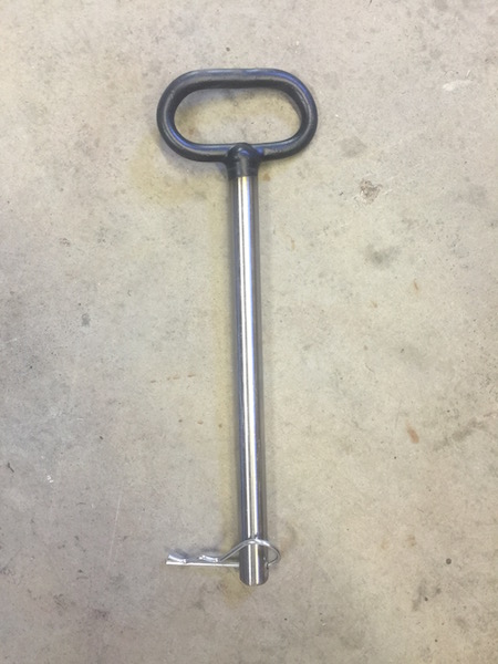

Don't know how this is relevant and not trying to hijack... but this I am sure doesn't deserve its own thread. That said, I just finished making a couple of 8in long QA pins for a project I am working on. I had to make my own because I couldn't find anything long enough off the shelf and I needed a close fit. I used drill rod for the pin and bent some simple 1/4in rod for the loop handle and coated with plastic dip. I think they came out pretty well MIGing it. Curious if anyone knows the material for 'drill rod'?

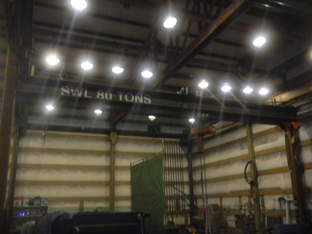

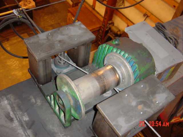

Drill rod is harder than the hubs of he!!. Even harder if you heat treat it.
I used drill rod in the fair leads for the power travel on my bridge crane. They have been in use for 12-years with 3/8" wire rope running on them. And they were not heat treated. ;)

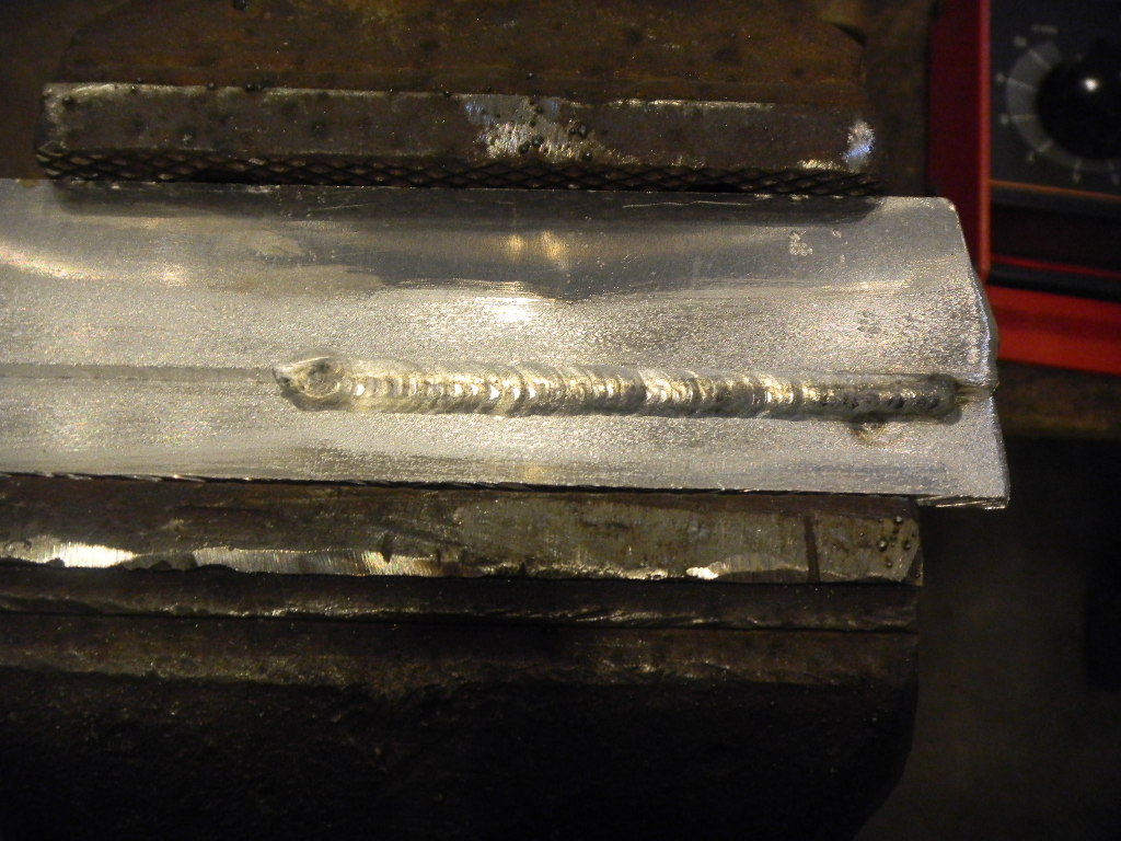

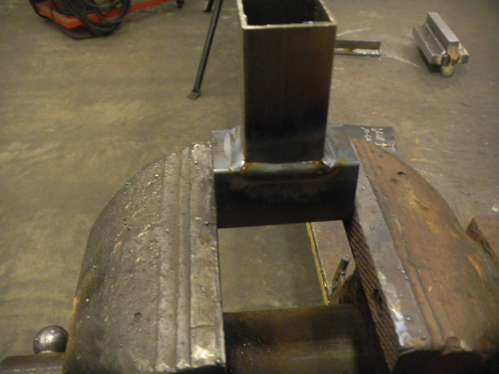

Here is a Mig weld I did with dragoneggs welder on 1/16" thick square tube.
Looks like 12ga 1 1/2" tube. Nice weld. I can make one just as pretty (after I clean off the slag) with my old 230A stick machine. In fact I made a 30'x7' rolling driveway gate for a guy in Mesquite out of that same steel last summer.
/ Welding a Small Part #60
Yep I made a couple tables for my wife's greenhouse using that for a frame and 5/4 eased edge cedar decking for the top. Haven't yet got welds spread like jiffy peanut butter on that gauge as SA did on his first try... Dang it.
