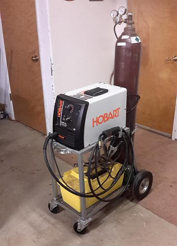

Oh, btw I bought one of the ones Arly posted for my little stick/tig - ended up spending hours "upgrading" the wimpy little wheels - it's STILL a wimpy little cart if you don't live on a pool table...

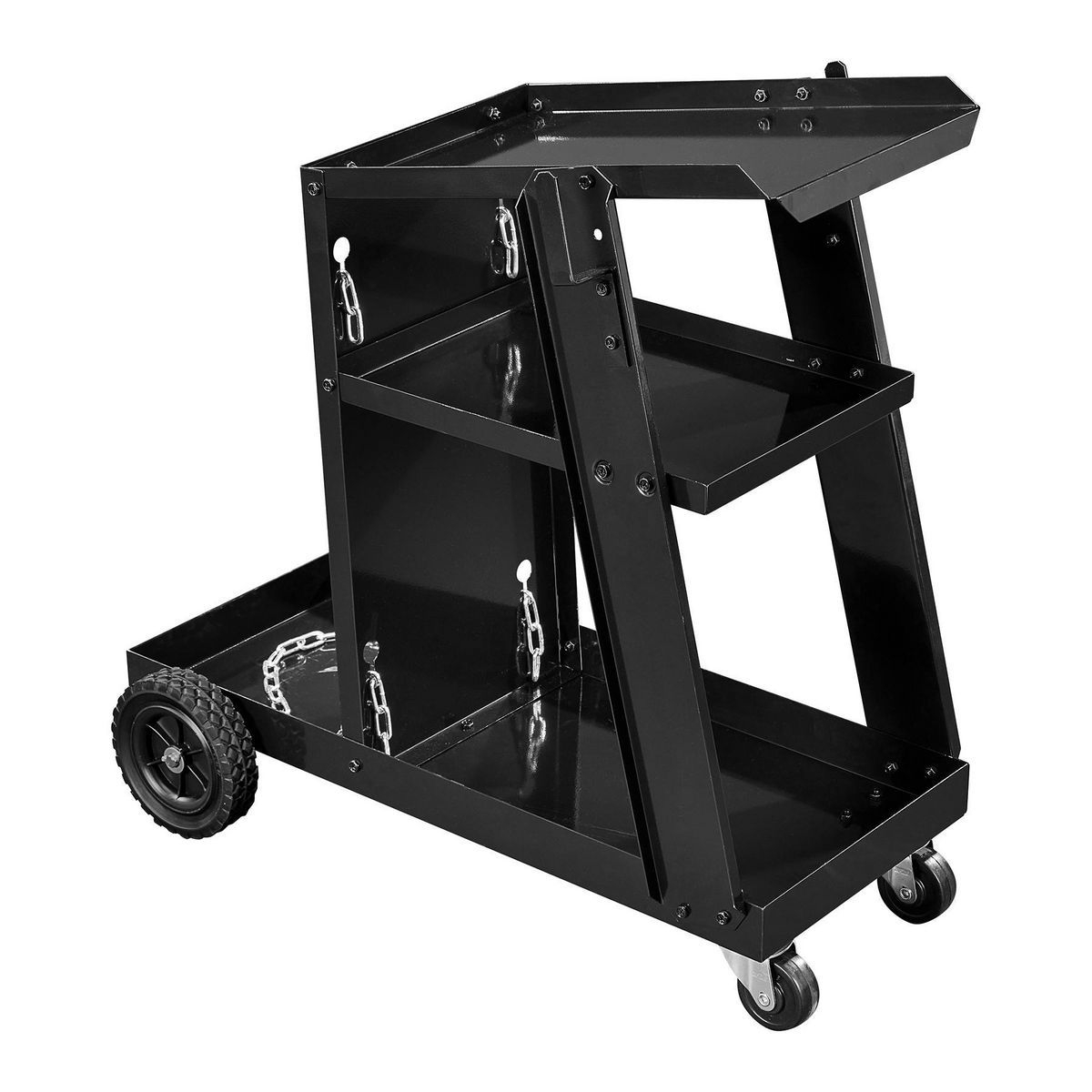

Looked @ the big Vulcan cart & almost pulled the trigger (have a never expires 20% off coupon) until I noticed the Bottle placement. If you have tall bottles, prevents opening most MIGs for spool changes/setting ref's/polarity changes without moving things around. So you lose top real estate to two machines instead of 3. Adding shelves on the bottle side to stack MIG/TIG, cooler & Plasma would work if your leads are long enough or turning the MIG "backwards" on the other end works too (only a problem if your tanks are tall enough to interfere & you want 3 or more machines up there). Would be almost perfect IMO if the Bottles sat behind the cart, but then you'd need to attach more casters under the bottle shelf since getting "tippy" would be an issue & the tanks & chains might interfere with the TIG filler tube storage unless you move those as well. For what its worth, until I get my dream shop built, I'm floor space challenged so multiple carts involve moving things around to get the "right" machine & its cart out of its parking lot & It ALWAYS winds up being the one furthest from being usable.
/ welding carts #13
The Other option I've looked at is adding a bottle shelf to one of HF's Yukon 46" mobile workbenches. The way they keep raising the price on the Vulcan cabinet, it would be $70 cheaper & closer to ideal to modify the Yukon which is about the same size & has a drawers or cabinet style. Pretty decent box, I use one on my back porch next to my smoker for food prep & cooking tool storage.
/ welding carts #14
If you only need 1 MIG welder on a cart with storage, this might do it, but I have NOT looked at them or had any experience with them.
ps. the torch/gas welding cart is garbage. The lip on the bottle shelf makes it harder than it has to be to lift in big bottles & the wheels won't hold air. You're better off with a decent wide dolly & length of chain. Tack on an ammo can for tips/cleaners/strikers if you want all-in-one storage

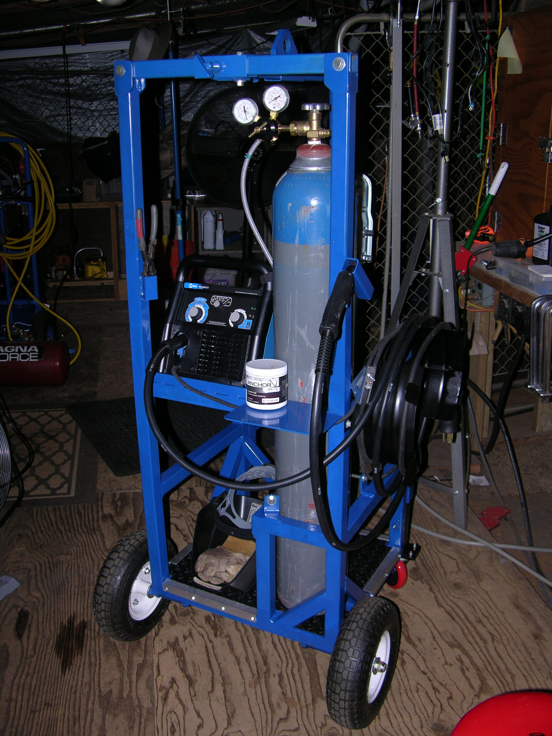

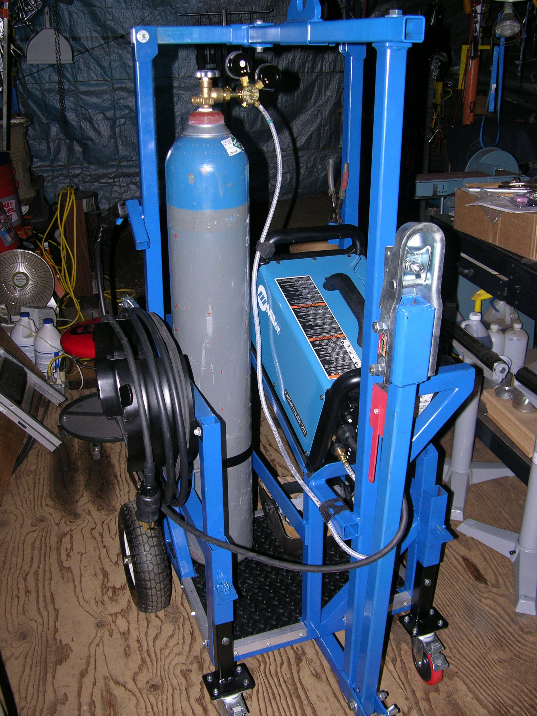

I built myself a MIG welding cart when I bought my Lincoln SP125 Plus MIG welder. I welded it up out of 1x1x1/8 angle. I used 1/4" plywood for the shelves. I do have some sheet metal I could make shelves from but I guess I'm just too lazy to make 'em. It is quite similar to the cart in the picture. I used 4 inch casters which are OK in the shop but are still a little small for a gravel driveway. The structure that holds the bottle is lower than the rear wheel axle centerline. I did this because the rear wheels on my cart are pretty large diameter and I wanted to keep the bottle as low as possible. I use the upper shelf to store the hood and the lower shelf for storing wire, tips, hammers, and other welding related accouterments. The only thing I want to add is some sort of cord, ground cable, and whip hanger system. I really think that each cord or cable needs its own hanger.
