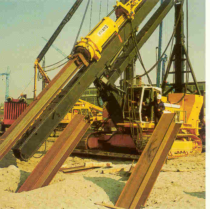

Far as the magnetized pipe, an easy way to counter it is an AC welding machine with 6011. With a DC only welding machine couple tricks. First thing I'd do is wrap the ground lead around the pipe 4 or 5 times. If that doesn't work change directions of the wrapping. If that doesn't work, heat the weld zone to a dull red with a torch. I've spliced about a bazillion H-piles after being driven. All the corners in a H-beam will give you arc blow on the best of days, but after being driven they can be a nightmare to weld.
Out of interest. Why are H beams driven at an angle as in the pic? What sort of construction is this?
/ Welding drill stem #12
I don't know what they're building in that picture. I found it on the Internet. When I was doing this kind of work there was no Internet, if I would have known I would have taken more pictures of the jobs I was on.:laughing:

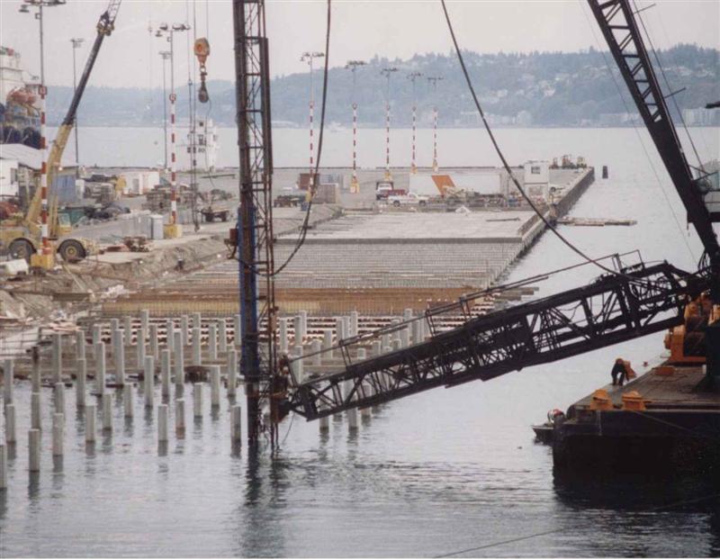

We drove batter piles for container ship docks in the abutment, for the impact of the ships bouncing against the dock. A lot of it is done for uplift in earthquake zones also.
You can't see the H-piles in these pictures, because the time the pictures were taken the beams were already to grade.

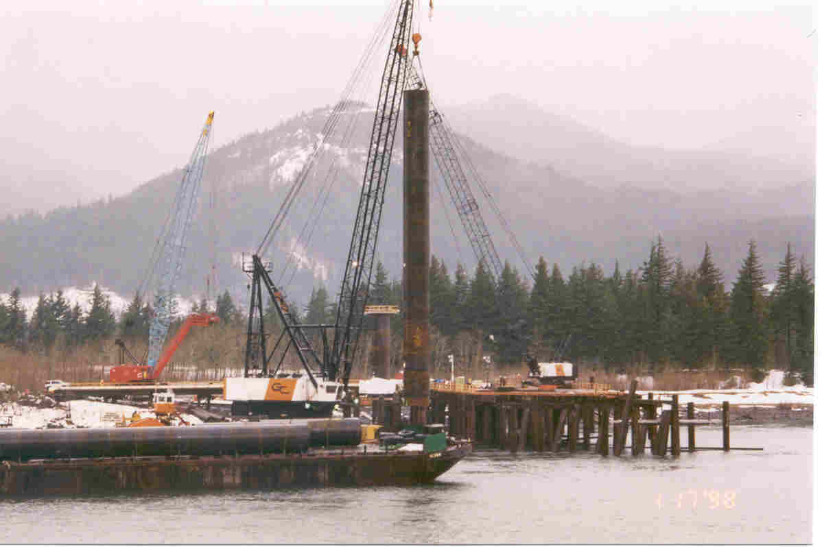

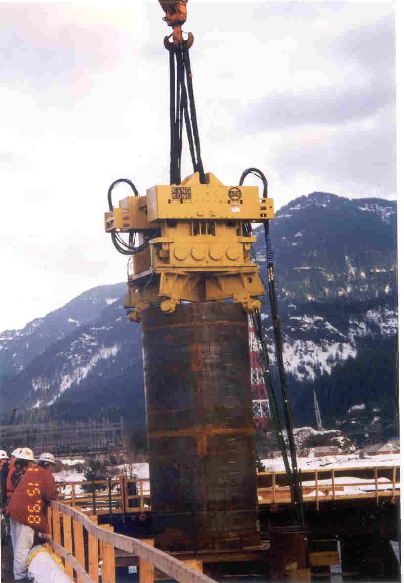

Tent stakes? I like that!:laughing: Here are some pretty big tent stakes.

Wow, those are massive tent stakes....:shocked:
/ Welding drill stem #17
Yea, I understand they are for a tent that needs to be big enough to cover all the BS coming out of Congress these days! Ought to be at least as big as one of the pyramids in Giza.
/ Welding drill stem #18
Biggest I ever drove. 10-feet in dia. All of them had to be welded on to. Can't remember all the lengths, but the ones farthest off shore were driven over 200-feet into the river bottom then drilled out, and filled with concrete.
/ Welding drill stem #19
How do you "drill out" massive H beams that have been driven 200 feet down??? Are you saying that the steel was literally drilled away and then concrete poured in its place or was concrete poured around the steel? I have always wondered how the concrete got "attached" because you typically just see steel being driven.
