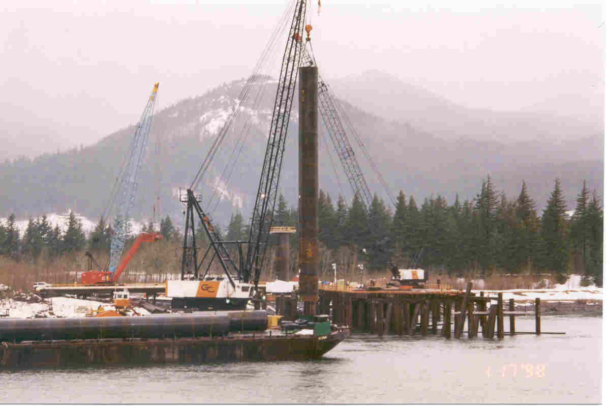

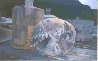

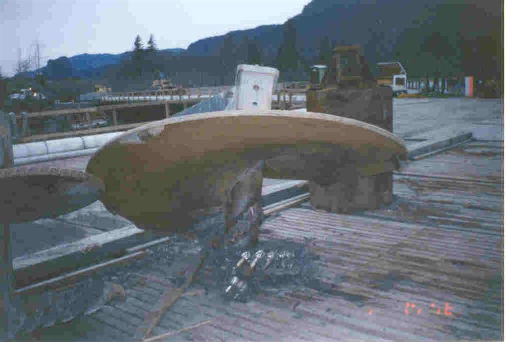

No,no,no! I was talking about the pipe piles, (cans). See the middle picture I posted before? The red crane with the blue boom on the left side of the picture was being rigged up to drill. The drill had a 750-HP diesel engine!

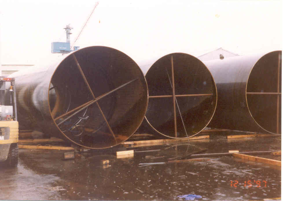

Here are some pictures of the drills we used. The large hole saw was used to cut the rock.

Biggest I ever drove. 10-feet in dia. All of them had to be welded on to. Can't remember all the lengths, but the ones farthest off shore were driven over 200-feet into the river bottom then drilled out, and filled with concrete.
Drilled out.....or....pumped out?

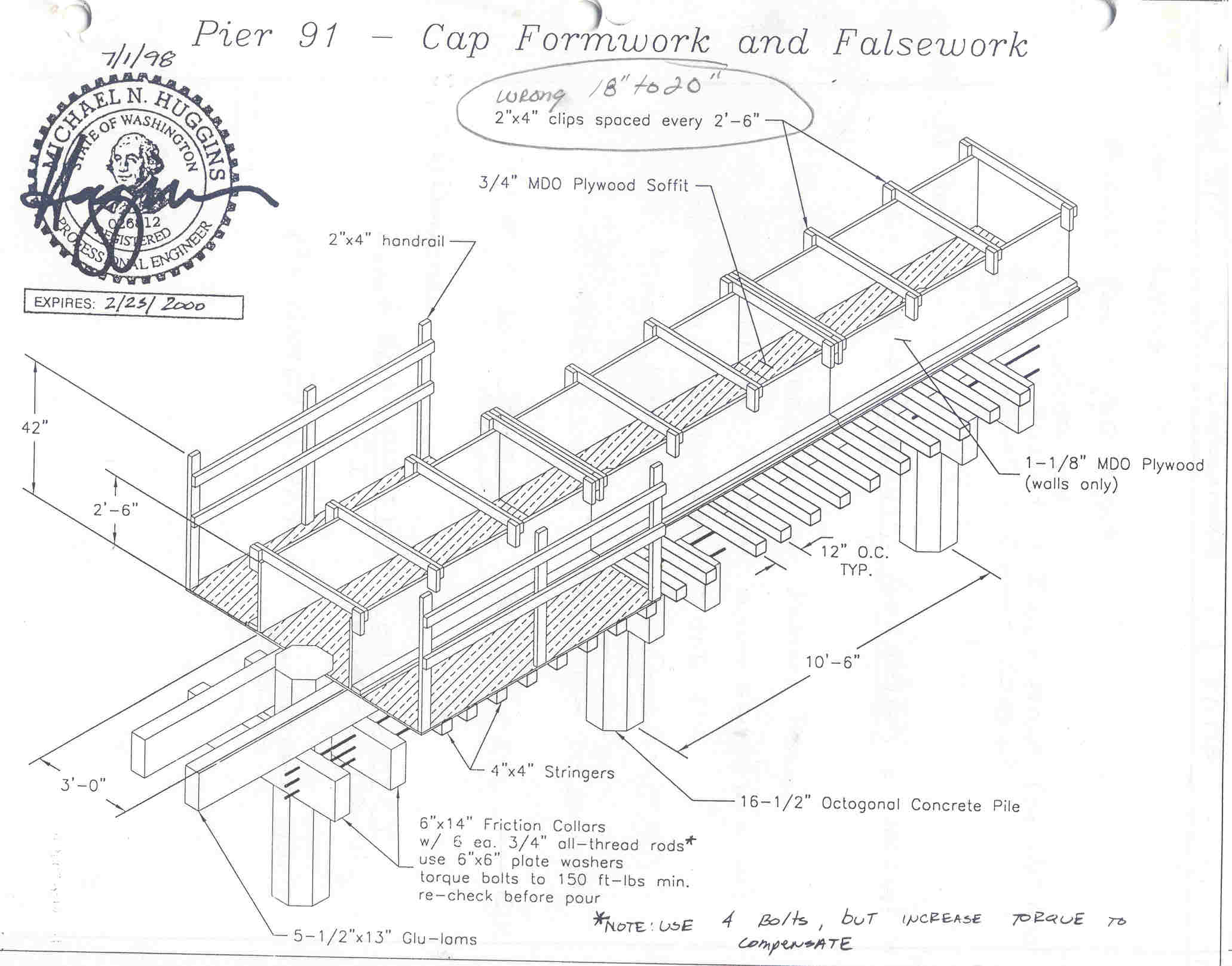

Here is how concrete container ship docks are generally done in the north. The deck is usually precast deck panels that have rebar sticking out the ends that are welded together.
In the south the deck is generally cast in place.
The second picture is at the Port of Oakland California, cast in place deck.
