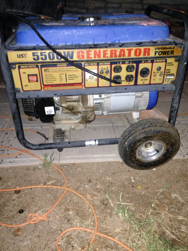

Ok.i just read the conclusion of 2x 12-2 romex would be better. Then could've used it after the job to wire the stalls. Anyway, got in my car earlier to pick up some wire.sat there . Read some more replies about generators and looked on Craig's. Found one (UST (5500W) for $350. Got down to $250. Went down there wouldn't start. Gave him 200. Got it home and it purrs and powers the welder. Thank you guys for the insights and knowledge. You rock. View attachment 389797
200$ for a 5500w genny? NICE
Very nice find!
