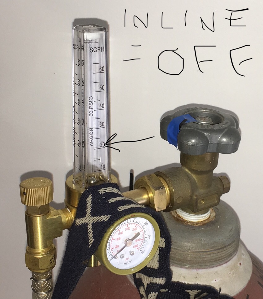

Here's a shop tip.
Put a piece of blue tape on the valve knob. Inline with the regulator signifies that the gas valve is CLOSED. That way I can glance from afar and KNOW That I closed it. When you open it, leave it in a different position (other than the "closed" position).
557199d1528176793-welding-gas-off-shop-tip-gas_cyl_off-jpg
If you back-seat, with some luck the closed position and the open (back-seated) positions are different for your cylinder.

I would do it opposite this, as for most valves, when the indicator is inline, the valve is open.

The other day, before closing the door for 5 days.....I glanced across the shop at my argon tank. The blue tape was inline with the regulator. Didn't have to walk over there and verify its closed. My current thought is this method is a keeper.
