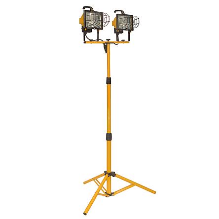

Extra light can really help you see what you are doing, autodark helmet or not. I have used a plain old halogen worklight to throw more light on the subject when needed. Makes a huge difference.

It amazes me, how many fab shops turning out a lot of product have light not much better than a candle.

As a general comment about light.. 75 years using eyeballs issues to me at birth, had cataract surgery 4 years ago when I could not pass Calif DMV vision test for DL... After surgery passed test with no glasses, 4 years later passes test again with no glasses... Only use 2 diopter glasses (cheaters) for reading and added 2 diopter lenses to helmet.... BUT BIGGEST HELP has been turn on a light!.... Admit it as we age vision goes, adding a lot of light helps everywhere.... If you really can't see go to a optometrist or ophthalmologist to find our why...
