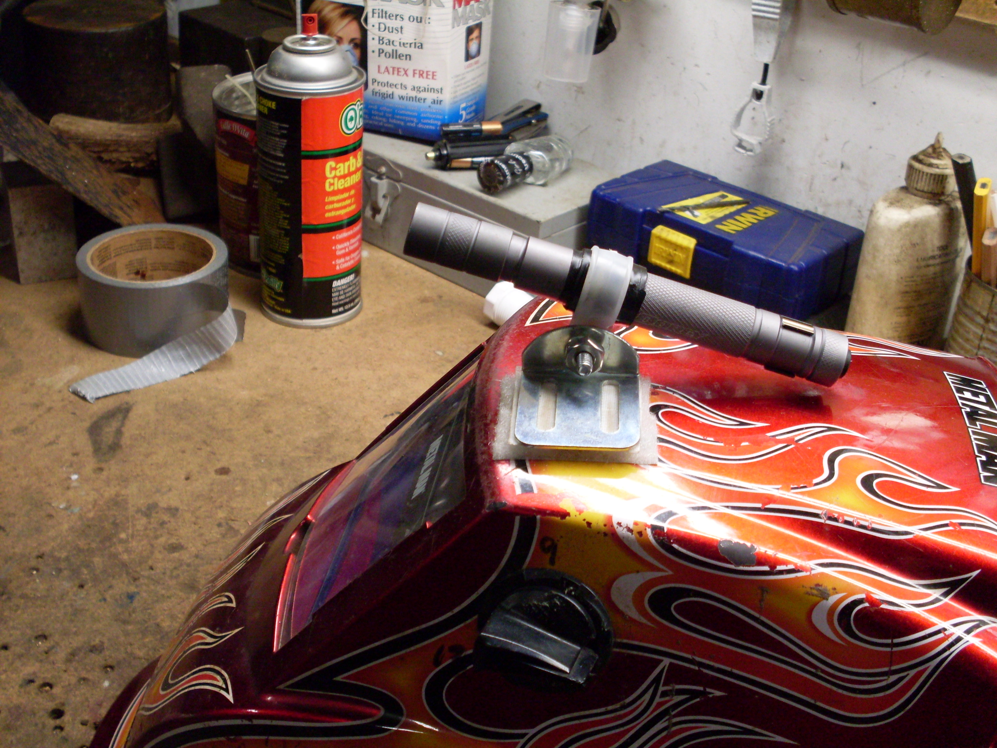

Several THings to help old eyes....First is new plastic protectors over lenses...Makes world of difference.... Also use white paint stick to highlight seam for weld.... Insert magnifier lenses (cheater) into helmet any way possible...
This is what I am now playing with for helmet headlight... Is just small LED flashlight with focusable beam ability, not nearly enough light, but helps... It held in place with velcro as I not ready to drill a lot of holes in helmet for experiment the are not proven yet...
Really think headlight style need to be a really bright headlight (500 lumens+) with corded battery pack one can clip to belt so weight is not on helmet...
