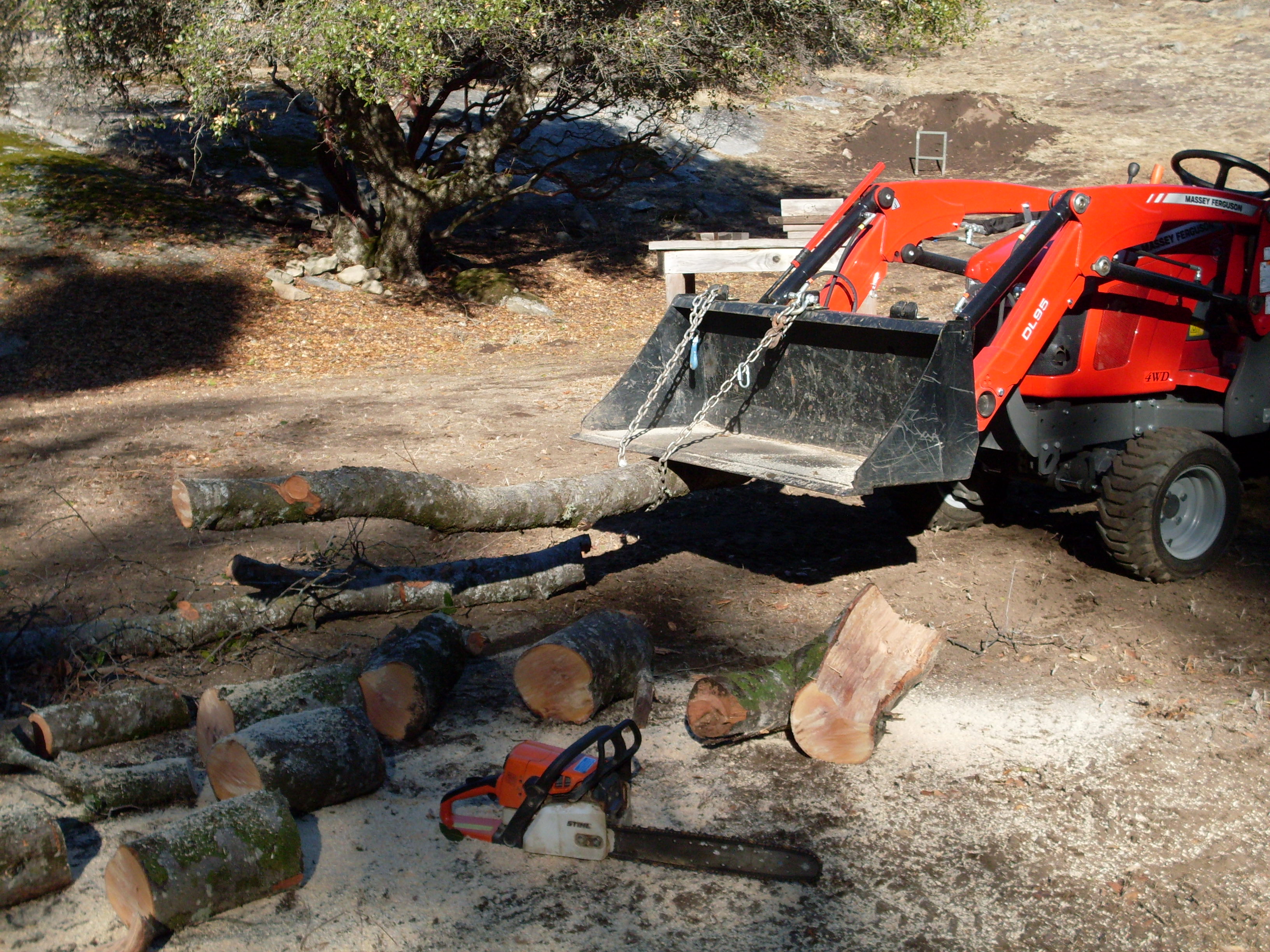

I have 4 hooks welded across my bucket top, and they are handy as a pocket on a shirt. Here is some of the "light duty" stuff I use it for...
The inboard pair are right in line with the FEL arms, and the outer pair on the bucket corners.
I also haul around my burn barrel by setting it in the bucket floor and wrapping a single chain around the barrel so it can't tip forward out of the bucket.

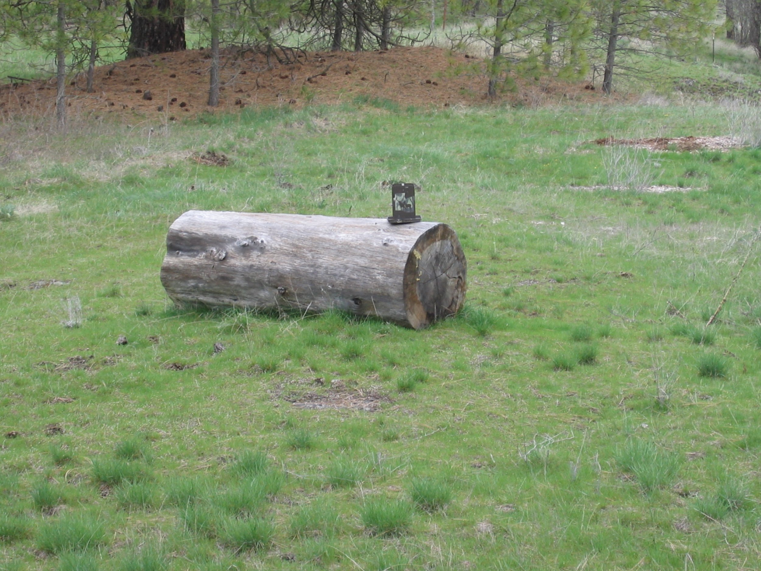

ponytug ........ Before I got my grapple. Ten foot chunks of pine tree trunk. Brush. Rail road ties.
This chunk - 8' x 34".

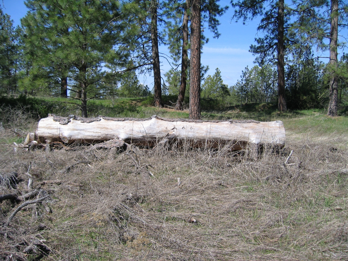

Which was cut off this 16' section.

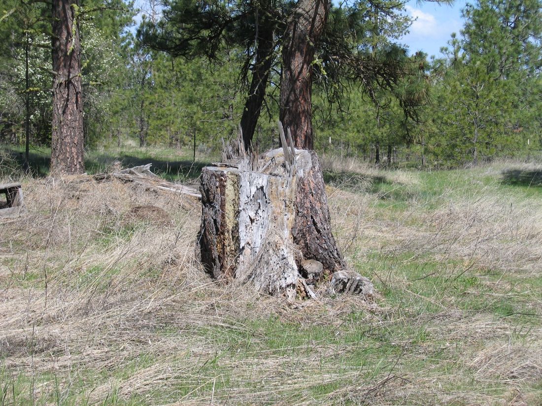

And this is the stump. One of my ancient Ponderosa pines. 38" on the butt x 110 feet tall.
