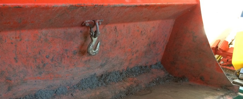

   / Welding Hooks to a front end loader #36
I have 3 weld on grab hooks on my bucket.
One in front of each loader arm and one in the middle of the bucket.
The center hook is by far my most used.
I don’t have a center hook. I hook to each side and drape the chain down the center of the bucket when I want to lift. This distributes the weight in line to both lift arms, not in the bucket center (weakest part).

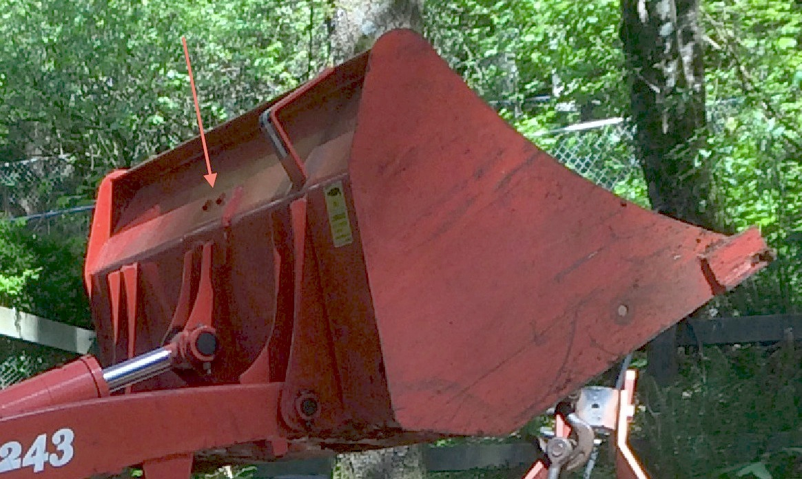

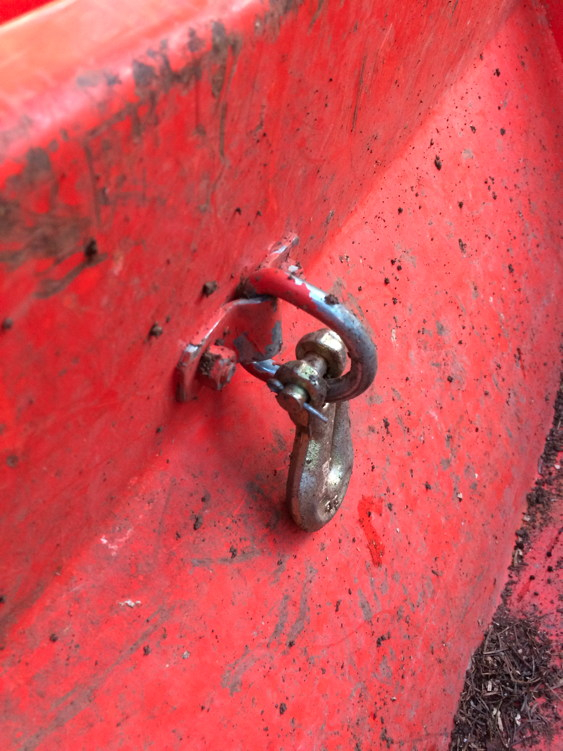

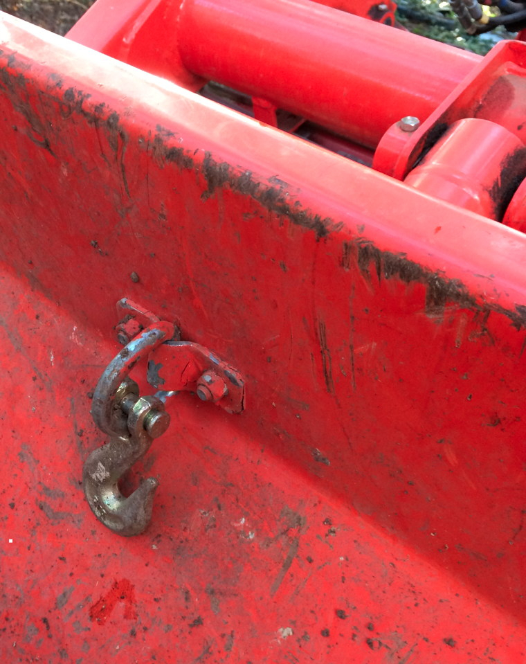

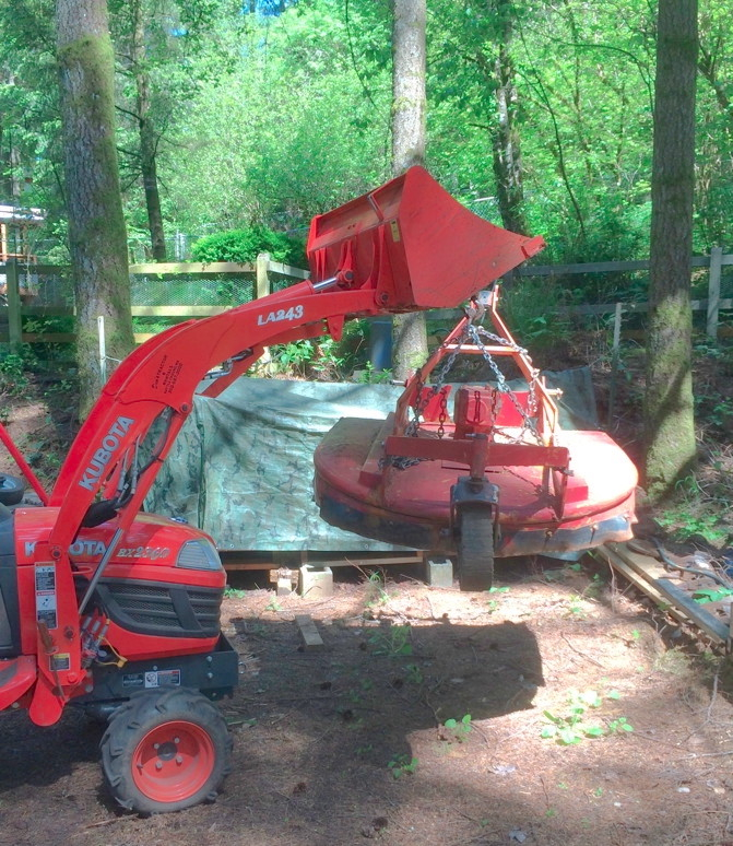

   / Welding Hooks to a front end loader #37
Center only on my BX. That's where the cylinder reinforcement is located.
buckethookD.JPG buckethookB.jpg buckethookA.jpg buckethookC.jpg BXcraneMower-s.jpg
Bruce
