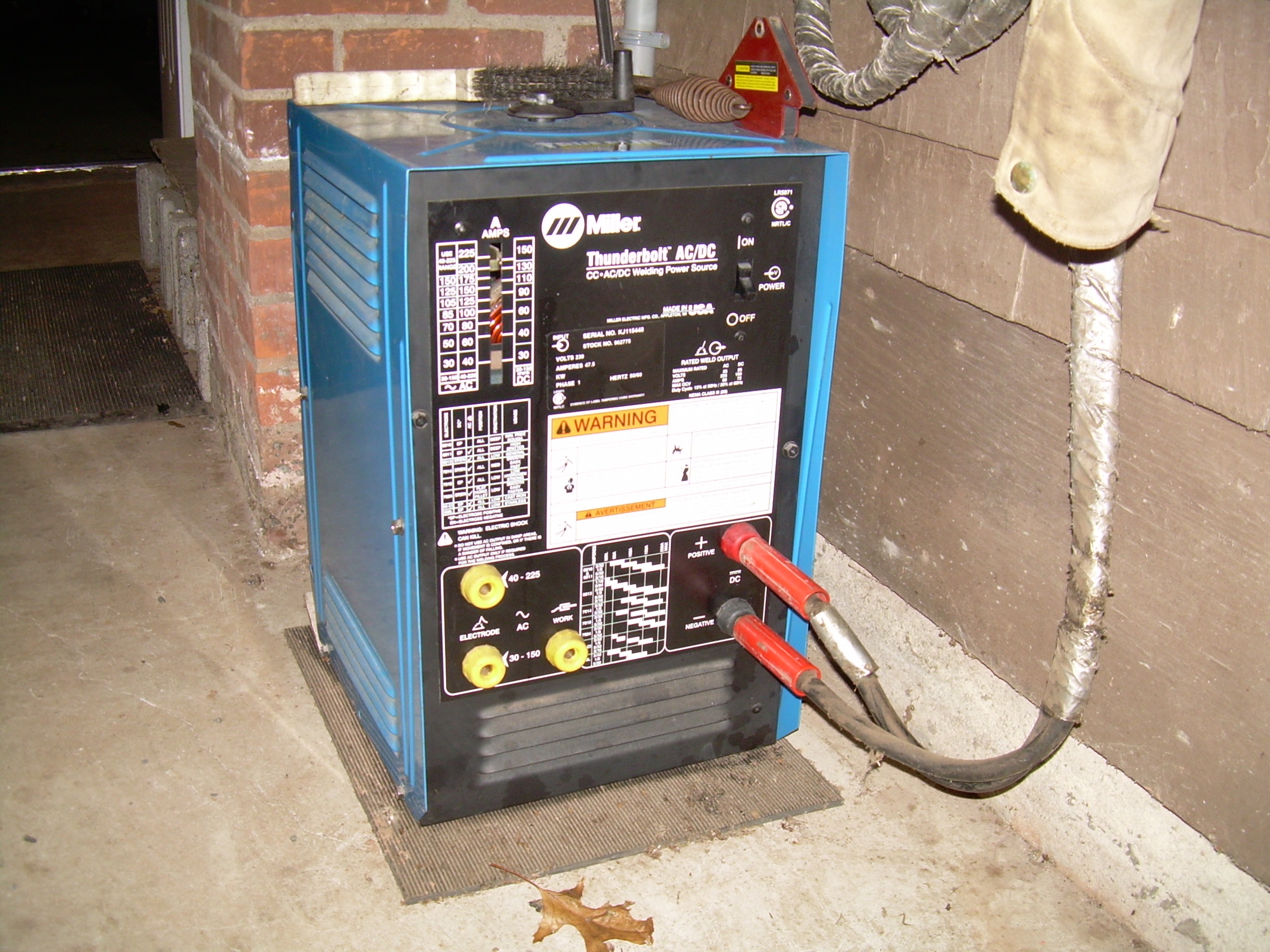

As far as the AC kills talk, that must be the reason behind the warning label on my new to me machine, it's a Miller ac/dc, it's the bottom of the miller line but is called, by Miller anyway, "light industrial" I would seriously consider this machine for the one welder stable.
Anyway, right on the front of the machine above the AC lead outlets/plugs it says basically never use AC unless absolutely necessary (paraphrased) I now figure must be due to that greater shock hazard, whether real or perceived.
I think about all those times with my AC only buzz box, I welded my old plow trucks back together laying on the ground in puddles of water and slush, with home made, spliced and taped up leads :eek:
It's a wonder I'm still around.

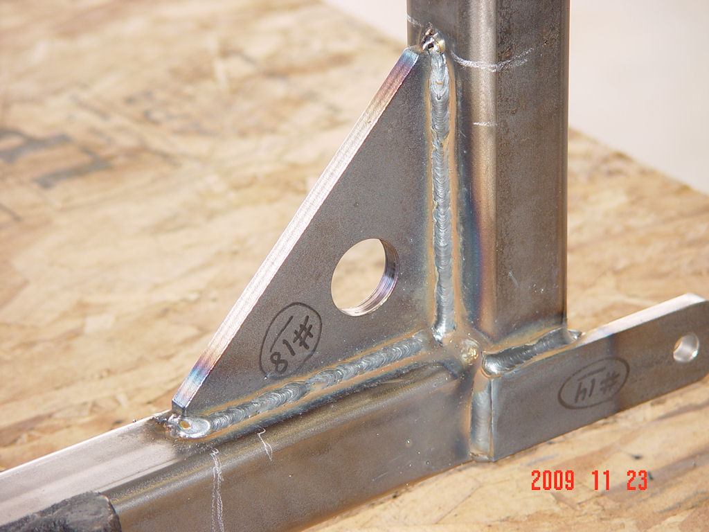

I went through a similar process when i built my shop. I wanted a welder I would not "outgrow" and one that would be simple to use. I settled on a Miller 180 Auto-set. It is a 220 V unit. Attached are pictures from the third time i used it. I used a stick welder 20 yrs ago when I was in an auto mechanic class, other than that I have no experience.
I have welded 5/16" thick metal fabbing new 3 pt stabilizers with no problems. I love this machine and am always looingk for projects.

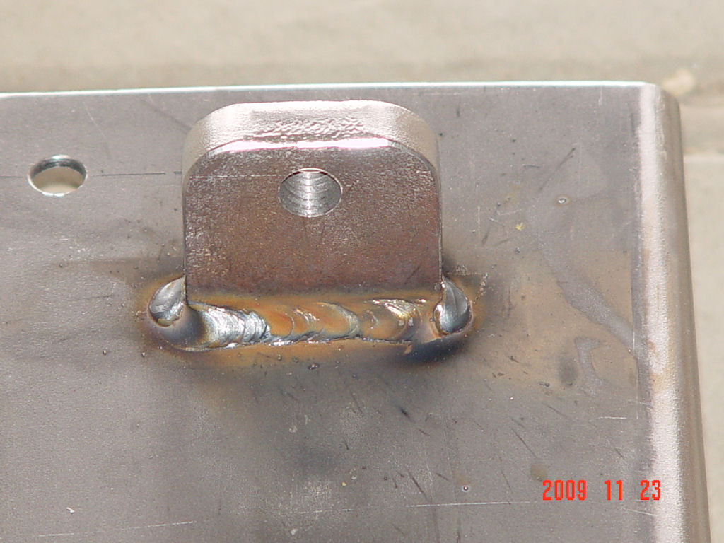

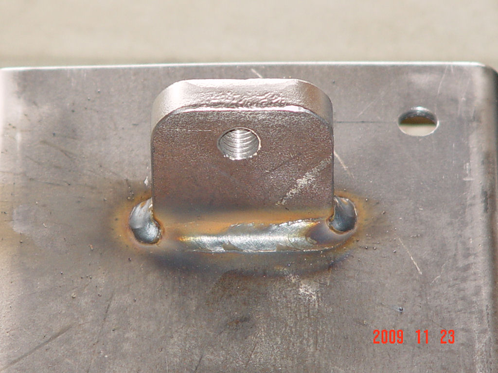

I have a Miller 210 that I like very much, and I'm self taught at welding. I bought my welder from the local Airgas branch and they included a spool of Airgas-Radnor 0.030" wire. I use shielding gas. I ran out of wire on the weekend and gave Home Despot a shot and they had Lincoln's SuperArc L-56 0.030" wire. What an immediate difference in weld bead using the Lincoln that I won't waste my money on the Radnor stuff again.
The first photo shows the last weld made with the Radnor wire, the next shows the first weld made with the Lincoln wire. The last photo shows a bead run with the Lincoln wire. I never could achieve that consistency with the Radnor wire. Using good quality wire has given me renewed confidence in my welding abilities.

Nice looking welds you have there, not much spatter at all. I'm soon due to pick up a spool myself, I may give the Lincoln stuff a try. Any wire that meets the same specs SHOULD be of similar quality, but it doesn't always work that way. We need to remember that any spec is a MINIMUM requirement, any improvements in the wire quality above that level isn't always reflected.

Both of these welds look professional, You can easily see the attraction of wire feeds, but they have to be 220 volt for serious/heavy work, like you would find the need for in Farm, construction field etc.
I call it caulking with molten metal, it comes out so nice.
