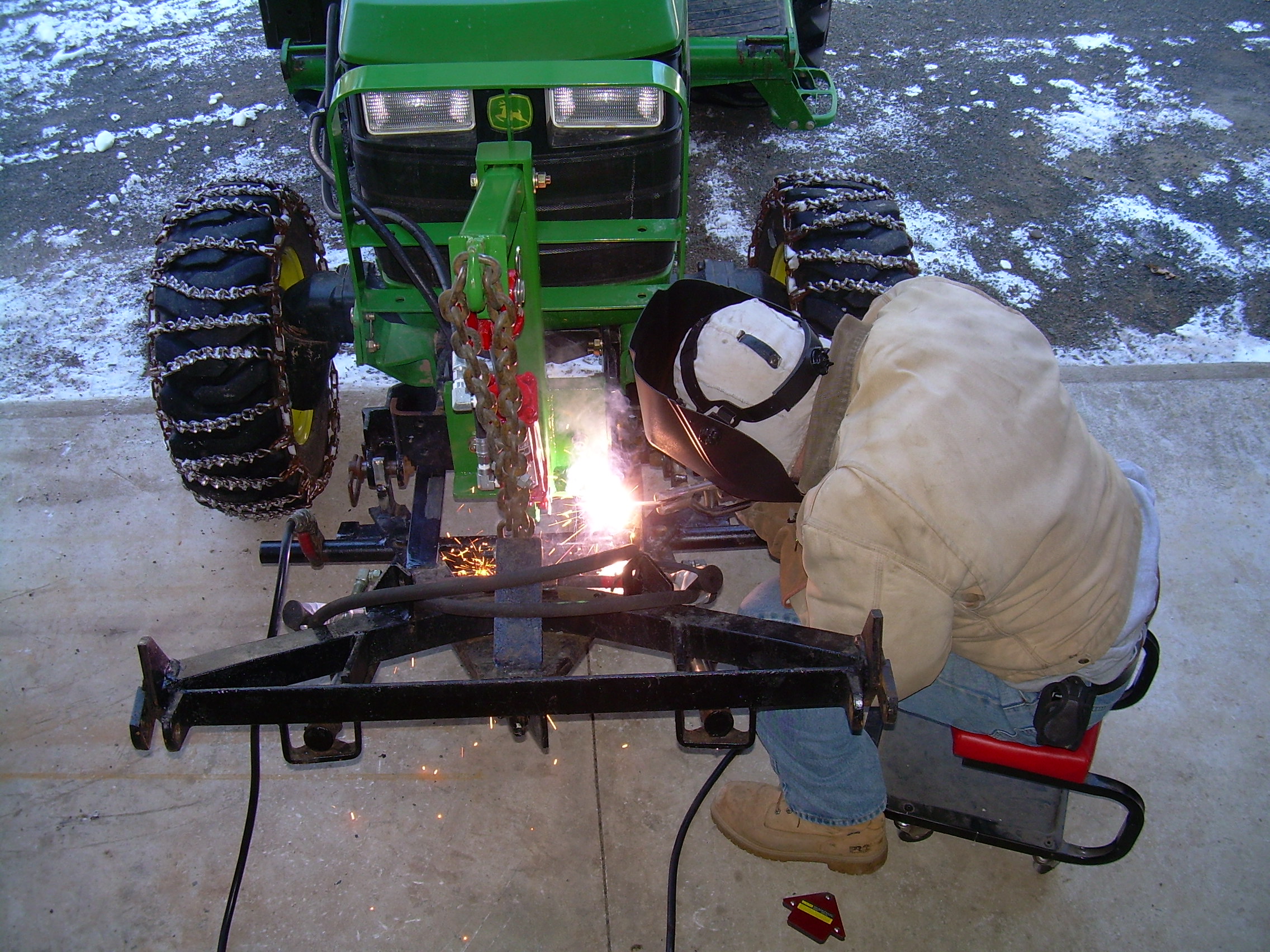

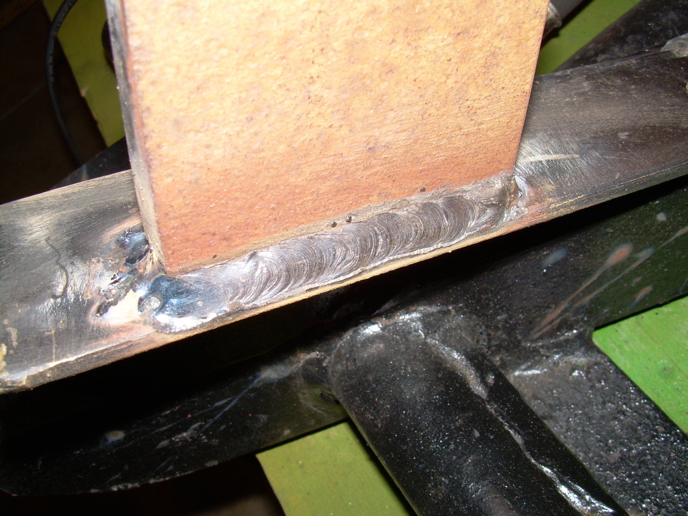

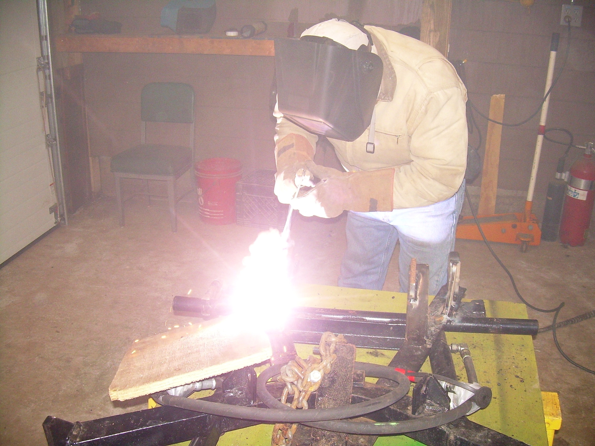

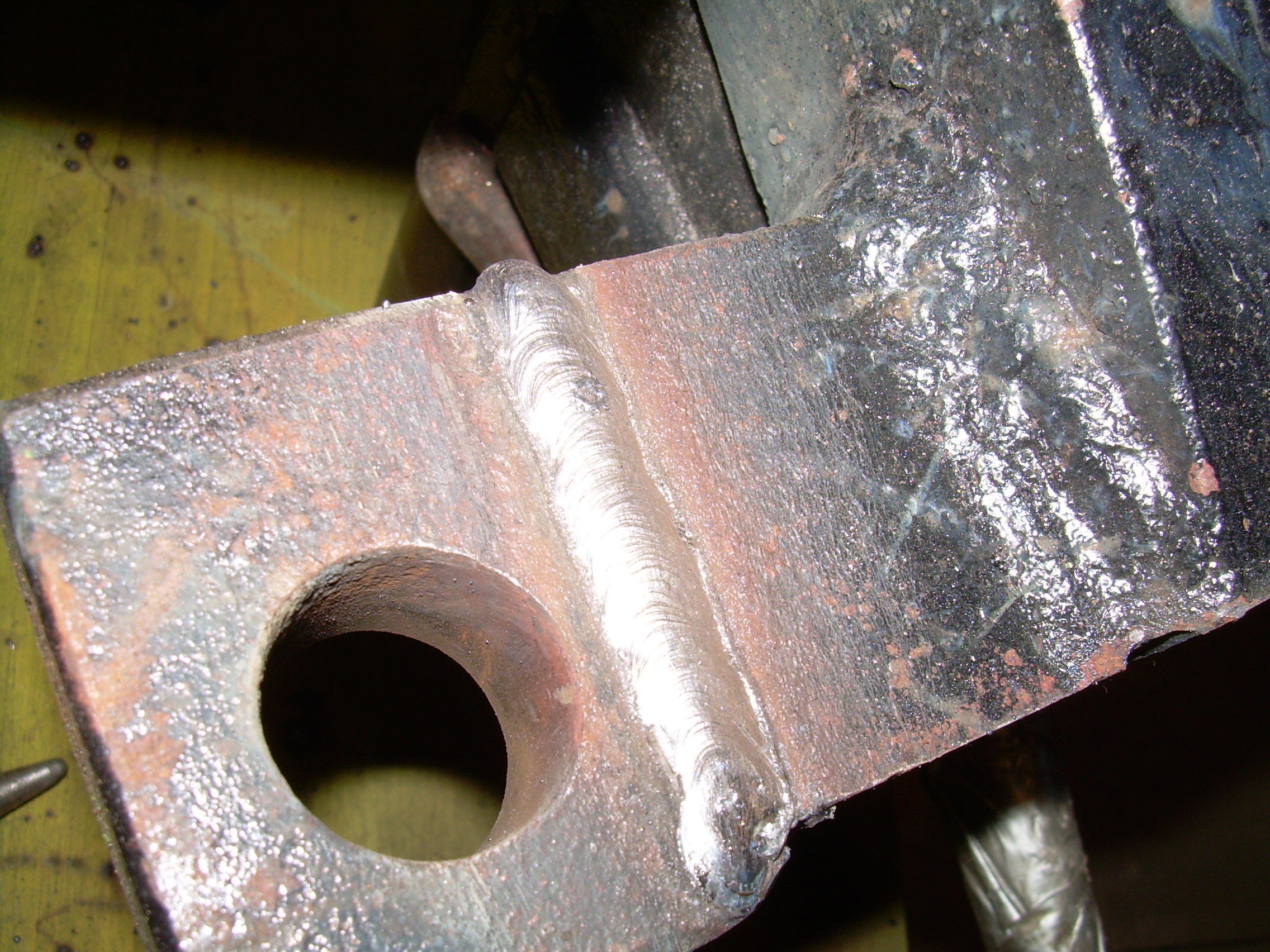

And almost forgot, before starting that storey, I just wanted to show some pics of me welding today on my snow plow, with the DC welder I'm finally able to show some of my beads :)
This is 3/8 to 1 inch material, 1/8" 7018 EP ~140amps DC.
JB.

Nice weld, youv'e had some practice.

Nice welds JB and I'm glad you weren't seriously hurt by your drum welding experience.
