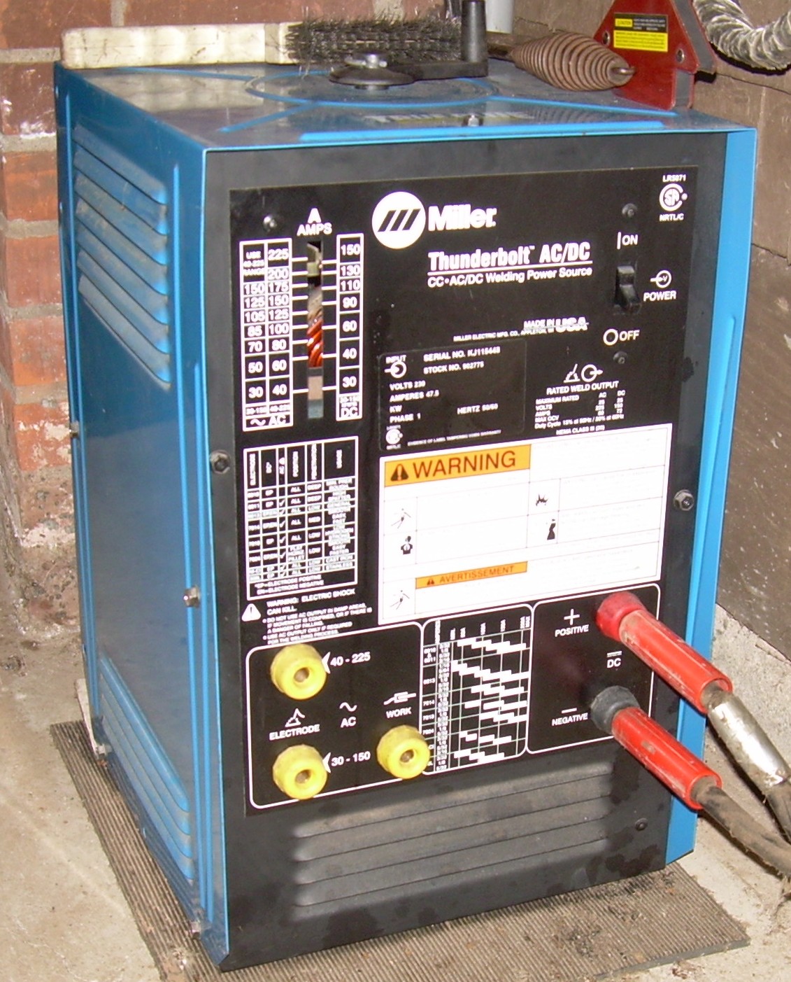

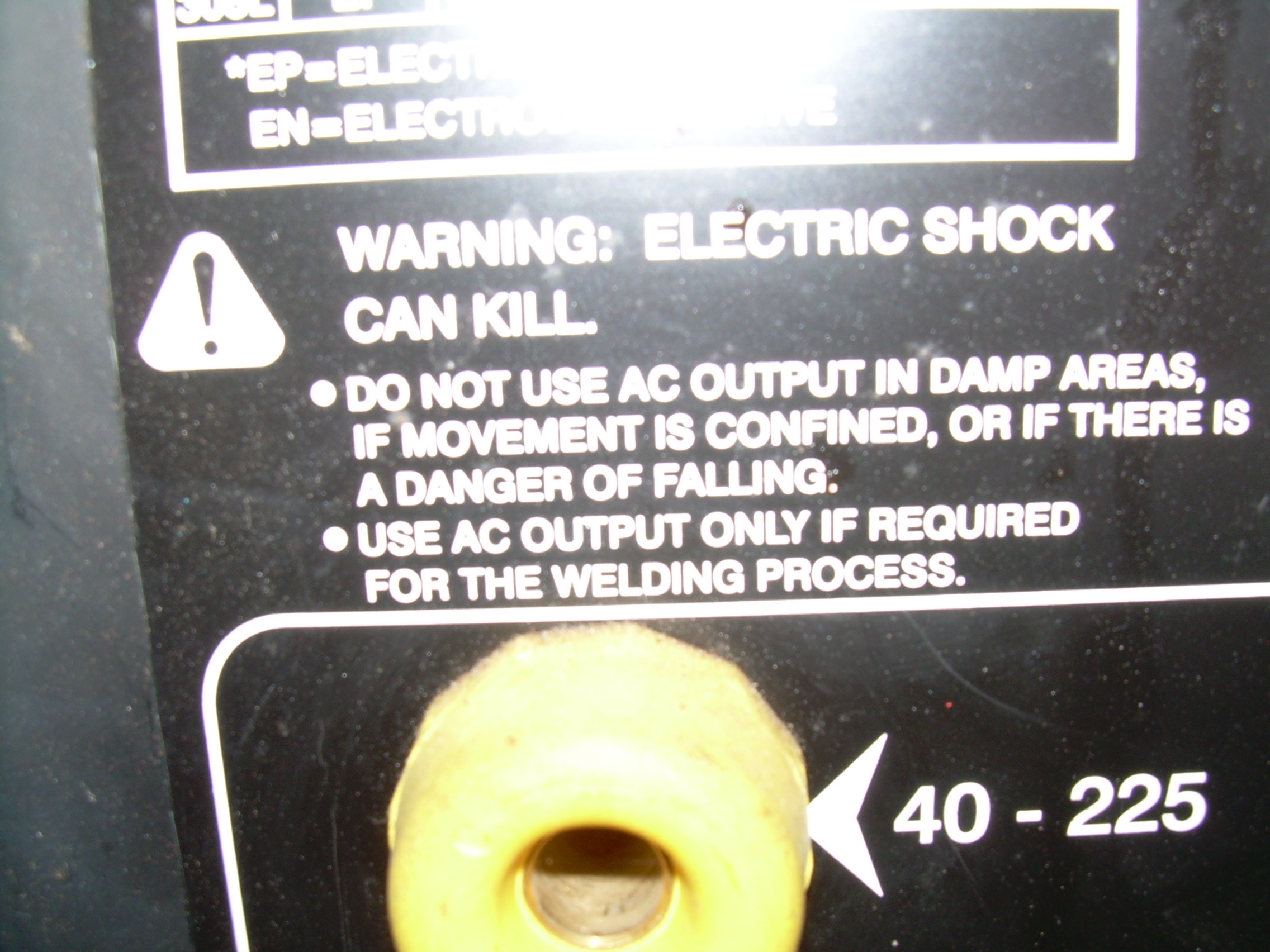

Not to hijack OP's thread, but I enjoy the welding discussions as do many other TBNers I believe, maybe there should be a welding forum :)
Anybody know why on my new AC/DC Miller, the AC amps go to 225 but the DC amps max out at 150 A?
Are DC amps "hotter" than AC amps?
Also a pic of the AC warning label.

That would be due to the rectifier.
"Hotter" ? Well, kinda/sorta; deposition doesn't happen on the other half cycle of AC, but "cleaning" does.

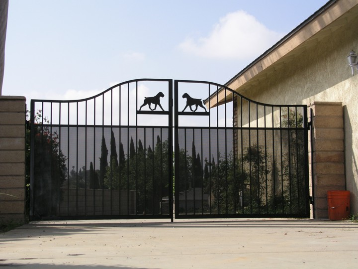

However you proceed, welding is perhaps one of the most rewarding skills you can develop, both financially and the accomplishment aspect. I was mostly self taught, on a nice little Miller 135 (120v), with help from a neighbor who is a commercial tig welder. I currently use a Hobart 187 (185amp) mig and love it. Its big enough to fabricate implements, multiple passes at times, and good on light stuff, bodywork, too. Attached is a picture of a gate I built from $200 worth of steel tubing, as an example of what can be done. With the money I saved from doing this myself I purchased a plasma cutter (another handy gadget for the metalworker).
