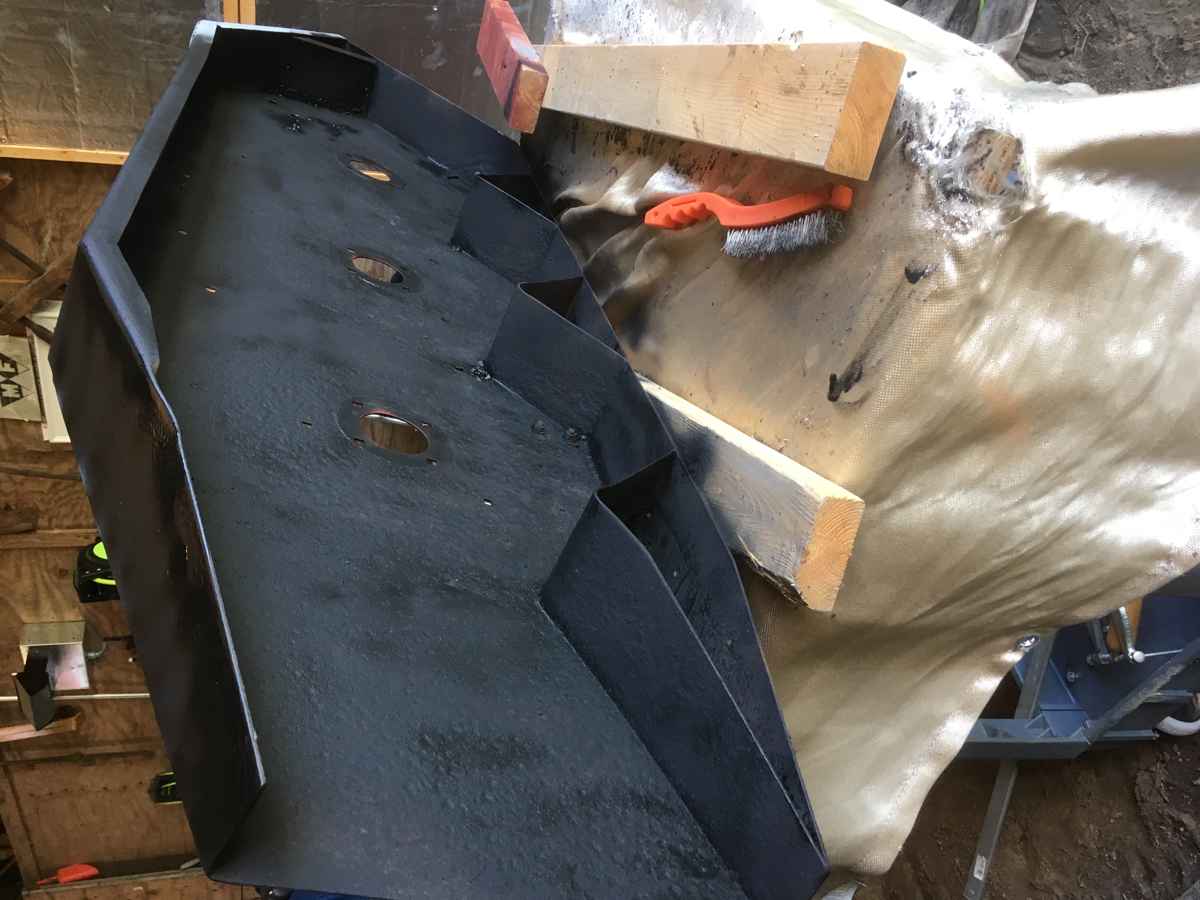

one of the areas that still needs some attention is the bottom right corner, where the two square holes are. There is an attachment/option that plugs into those two plastic grommeted holes. Maybe a flag or corner indicator like big trucks have up on their front?? Two prongs push in from the front and hold it in. Need to look at the parts diagram and see what goes there. Otherwise it looks pretty unfinished. I had no desire to try to cut square holes in metal. Round ones are in my pay grade... Little hold down clip goes in those holes, will cover top part but bottom probably could use a little piece of metal.
Going to likely give it a rest today, will start again tomorrow early and first make a bigger patch. The more I looked at that little square patch the more I had visions of one side disappearing when I welded it on to the deck. Bigger patch is uglier but...

I finally had to lay down a bead I couldn't grind off, and it didn't do too badly.
Hard to see, far corner of deck internal shrouding had rusted into almost nothing; I just so happened to have
a piece of metal cut that fit in just perfectly. Scraped the surface junk and crud out, air blasted it, and
then did fine with a 7014 1/4 at 90 amps.
Not sure why, likely the speed I go (like a bad golf swing which I don't know how to play) seems to make the larger rod at 90 amps go
a lot easier than the 3/16 at 75 amps. Seemed to have less burn through problems, was putting down more material quickly enough.
Filling holes is sure hard. Plus the material often still has a hole in it after I've ground it. Likely why most folks just weld and don't grind...
Saved the best for last. Heavy metal to heavy metal. Two thick pieces need to get welded, then I'm done welding on this deck. Have to buttress one piece with angle iron; on both decks the wheel support either ripped out there or was repaired previously by welding so it seems that the factory did not make the wheel mount strong enough. Plus wing mowers tend to run into things...
Well, it will be strong when I'm done. More pics to come.
