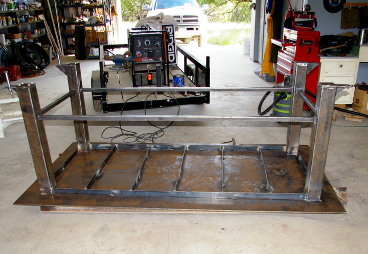

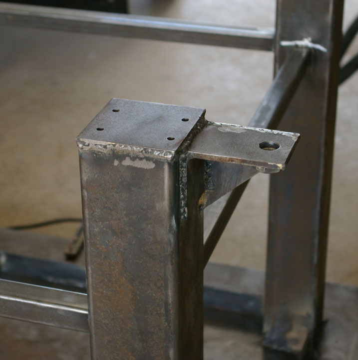

Finish welding began. My approach was to finish the legs one at a time. First the leveller/brake was welded in place, then the caster mounting plates, the spreaders and finally the external stiffeners.
The wire feed welder didn't like it to much when the temperature went over 90 and I exceeded it's duty cycle, so it shut down. Not wanting to waste time waiting on the wire feed recycle, I cranked up the Hobart and started finish welding the stiffeners to the table top.
You may notice that there are no close up shots of my welds. If you don't understand why. just go back and read the first post.
By the end of the day, two legs were finished and about half of the stiffeners. This baby will be finished this weekend. Waa-hoo!:thumbsup:
Still haven't figured out how I'm going to turn this thing over without damaging something or killing myself. Any suggestions?
Harv, you can see that 24' workbench in that last pic. That is why no deck under the table.

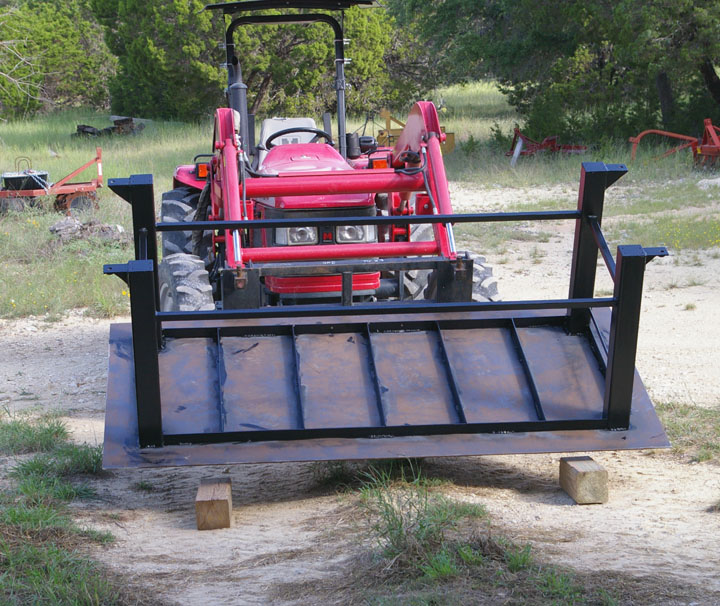

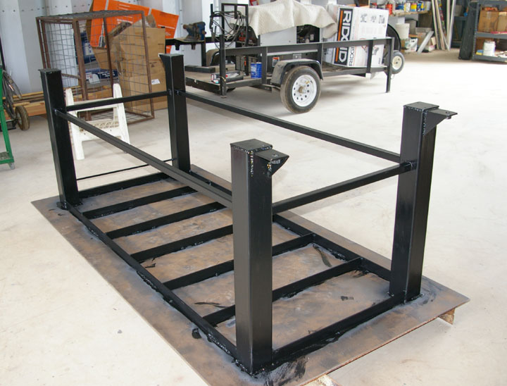

#37

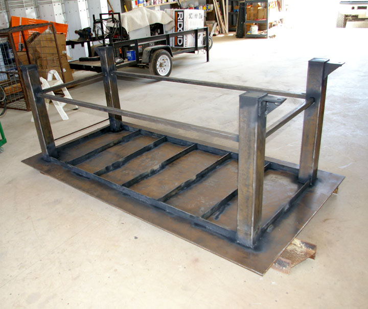

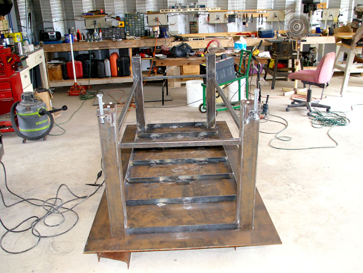

The welding is finished. Once the welds were cleaned they were primed and the frame painted with Rustoleum black, satin. Using the words of that great TBN philospher, Eddie Walker, "The grinder and paint really help a lot in hiding my lack of welding skills." ;) http://www.tractorbynet.com/forums/...81191-barebones-mule-your-suggestions-11.html
The bar to hang clamps was added and I drilled and tapped two holes to mount a six outlet extension. Then all I will have to do is run one extension cord to the table.
Tomorrow is the big day. SWMBO, the tractor and I will turn this critter over and we'll see if all that welding warped the top.
We are going to use Harv's suggestion and take it out on the dirt to turn it. Cross your fingers and wish us luck.

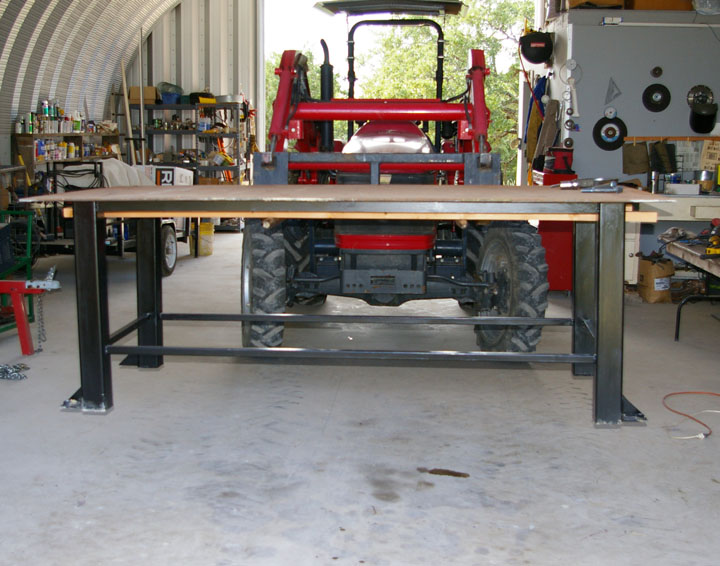

We managed to get the table turned today. Don't know what I was all that worried about, it went without a hitch. Of course, by backup was SWMBO and our Mahindra 4500. Piece of cake.:rolleyes:

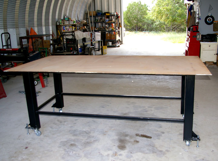

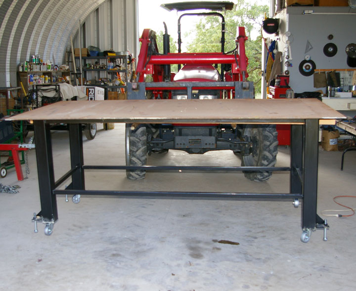

While the Mahindra held the table, we installed the casters and 6 inch bolts into the legs. Then came the first test. We set the table on the floor and to our great relief, nothing collapsed or broke. :)
The next test was to see how easily it rolled on the floor. Again, to our great relief and pleasure it moved as though it was on ice. :D
Finally, we turned the leveller bolts down to act as brakes. With just a quarter turn more on the bolts after they made contact with the floor, the table was solid as a rock. :thumbsup:
