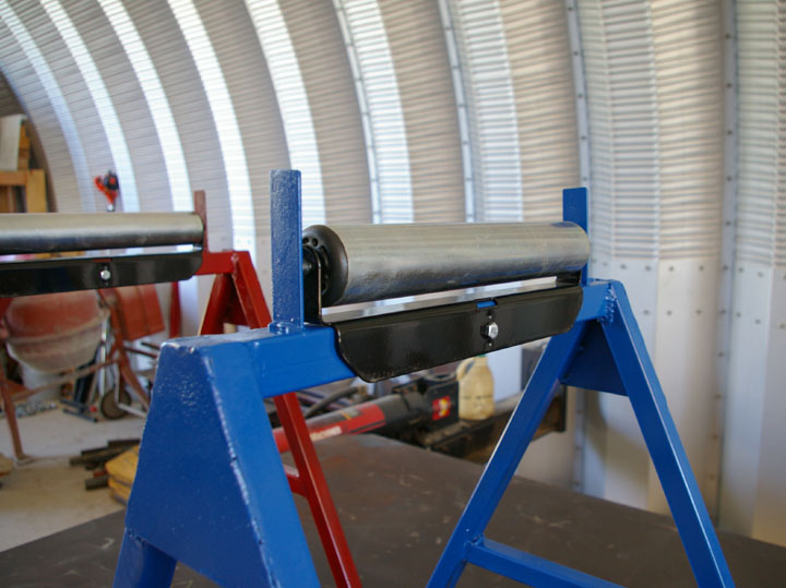

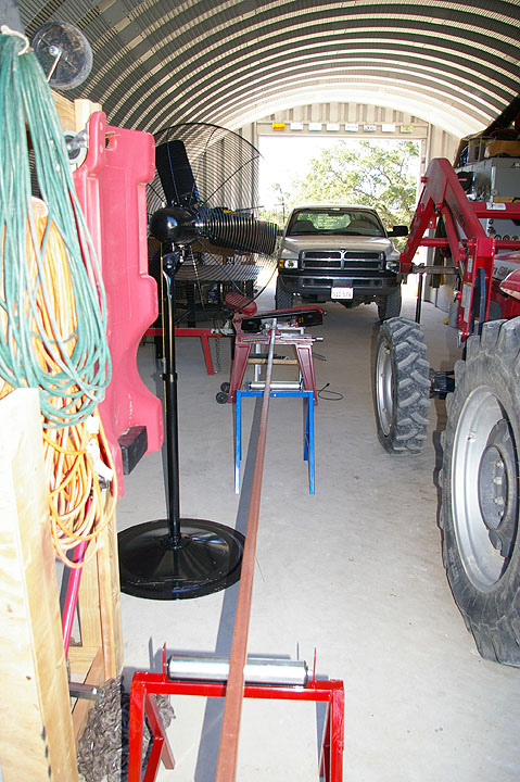

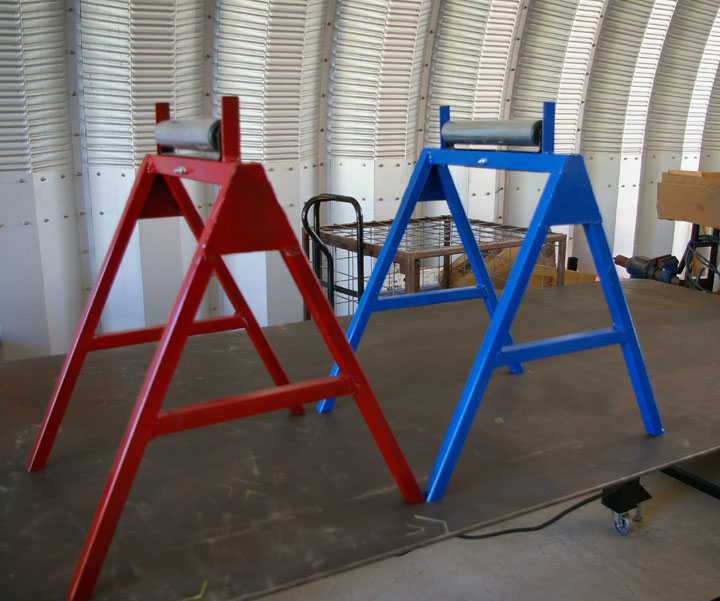

The first projects to come off the table were two roller stands. I already had one, without a roller, that was picked up at an auction and used everytime I used the HF bandsaw. That bandsaw is another HF tool that does not suck. Especially when it has a good blade.
SWMBO picked up two HF roller stands for me, 132 Lb. Capacity Roller Stand on sale for $14.99 then discounted another 20% with a coupon to $11.99. The rollers were removed and used for the project stands.
Just in case anyone is wondering why the HF stands were not used instead of building two new stands, well, they are just too tall.
Added a couple of pieces of 1" flat stock to keep things from falling off to the sides.
The finishing touch was to paint them, one red and one blue. The old one was painted white. Why the patriotic paint jobs you ask? The answer is twofold: The paint hides my amateur welds and; it makes it easier for my "helpers" to know which stand to move when they are asked to move one.:rolleyes:

Good job on the stands... and on the table. A welding table is one of my "Someday" projects.
FWIW, Another good source for rollers is a treadmill. Usually there's a good, heavy duty roller on either end of the belt. Used treadmills are pretty easy to find. There's lots of good stuff in them, rollers, rubber belting to line tool drawers, DC motors, linear actuators, and lots more depending on what the next project is.

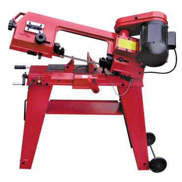

Dargo, sorry to hear you had so much trouble with your bandsaw, but I don't think we are both talking about the same saw. This is the one I think is a good one. Horizontal/Vertical Metal Cutting Bandsaw

You are correct; different saw. Bummer. I suppose you don't want the POS I have. :laughing:

I have the same bandsaw weldingisfun has, and mine toasted the motor on the first use.
I have heard some HF tools described as "do it yourself" tools, meaning you have to be willing to modify and work on them and this was the case with this saw. But with a decent motor, it is now working well and I have used it on a lot of projects.
   / Welding Table Build #60
I picked up one of the HF saws last year when I decided cutting parts with a reciprocating saw was too much work. I found it on Craig's list, one of my favorite stores. The thing was covered in some kind of red coolant and lots of metal cuttings, pretty filthy. The guy said he got it from his brother but never used it. Well, I covered the motor with a plastic bag, sprayed it down with de-greaser and power sprayed it. Then I replaced a few missing screws and fired it up. It didn't cut too well, but I found the guy had the blade on backward. The blade was showing some wear, cracks and such so I replaced it with one from TSC. While I was going over it I replaced the gear oil and guide bearings. I'm lucky enough to have an Industrial Bearing store a few blocks from work. The 6 bearings cost about 12$. I got it cutting pretty square and have been using it without a problem. One of the best finds I've had.
