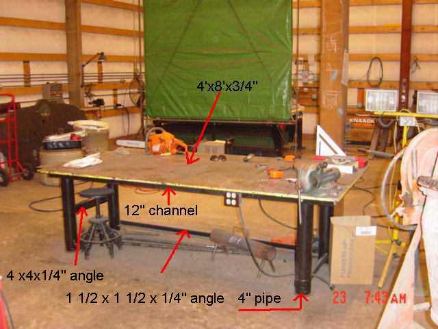

When I built my welding table I used what I had. The frame is what I used to unload my Miller Trailblazer 55D. I built it the same height as the flatbed I had at the time, used a come-along to pull the welder on an off the truck. I needed a plate to go on top of the frame, so I called one of my buddies who was running a job not to far from my house, ask him next time he was in the yard to grab me a 4' x 8' x 3/4-inch plate. Not wanting to go all the way to Seattle to the yard he just went down to the local metal yard and bought me a plate.:cool2:
I kept on reading the posts down to here. I wish I had a shop like yours; maybe someday. I work in a 10 X 20 garage tent in front of my garage. In this weather I use halide lights and a diesel salamander burner to work. I love that bench. Mine is only 2' X 4' 1/2" plate but better than nothing. Found it at a garage sale for $50.
