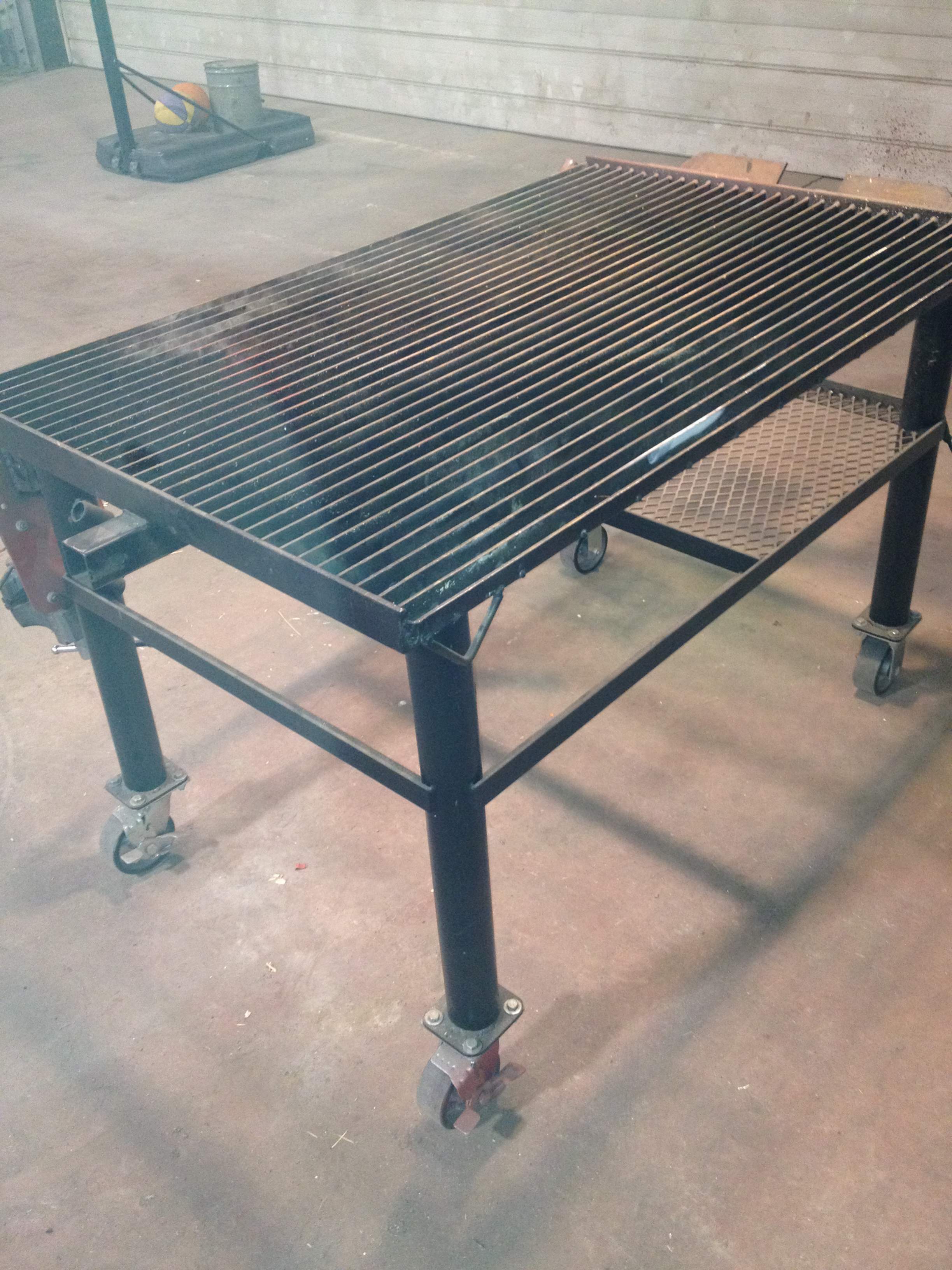

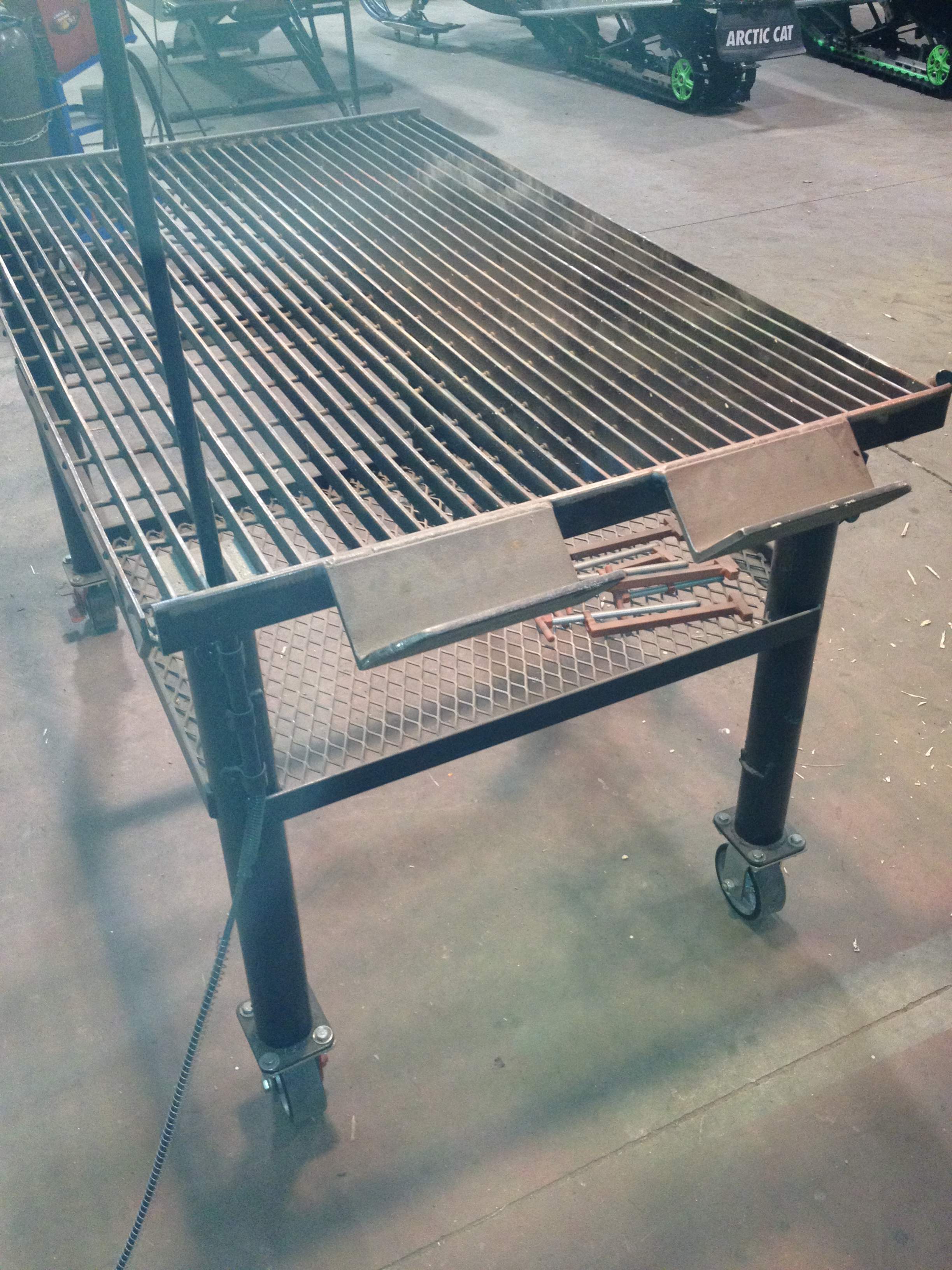

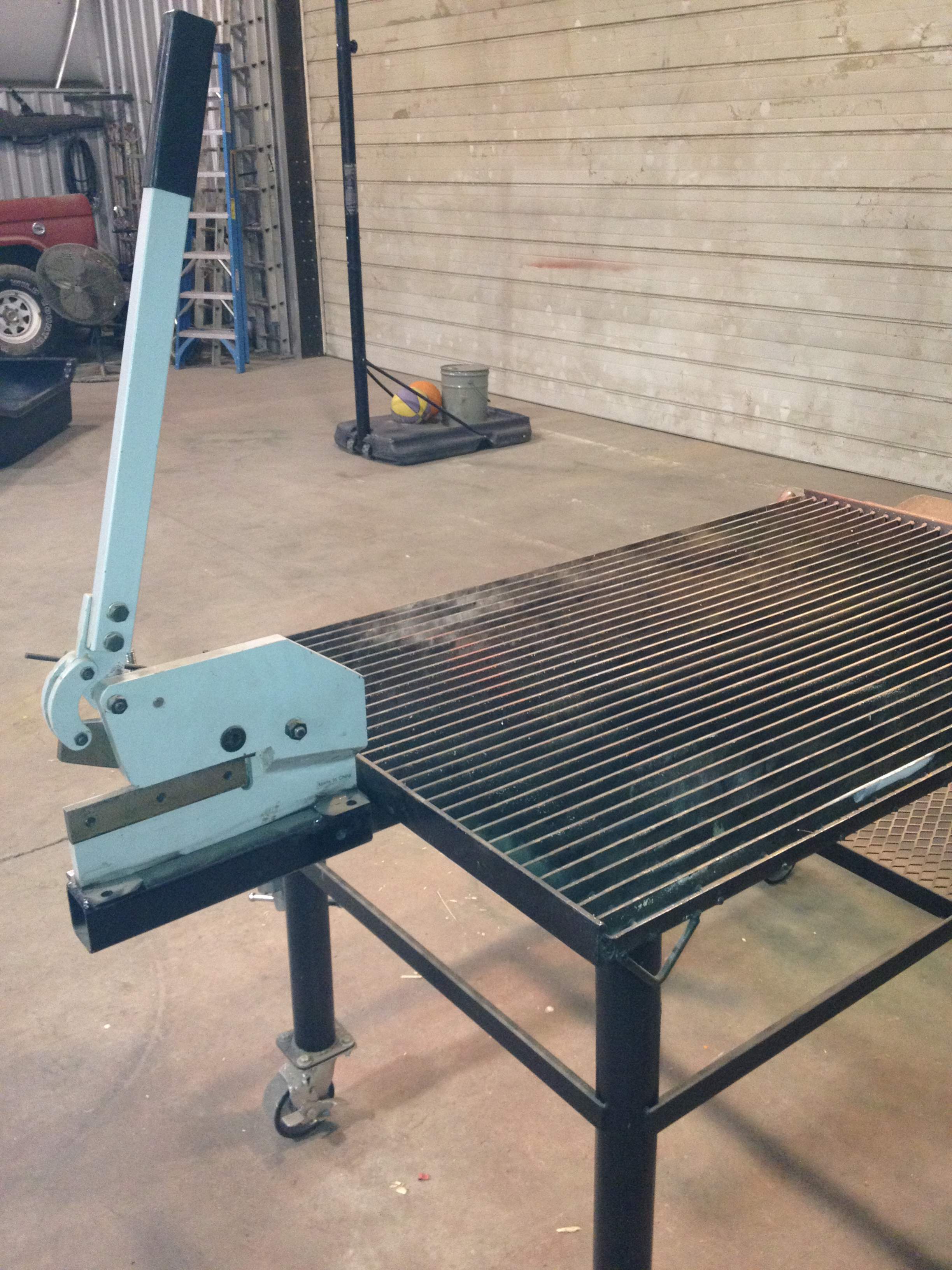

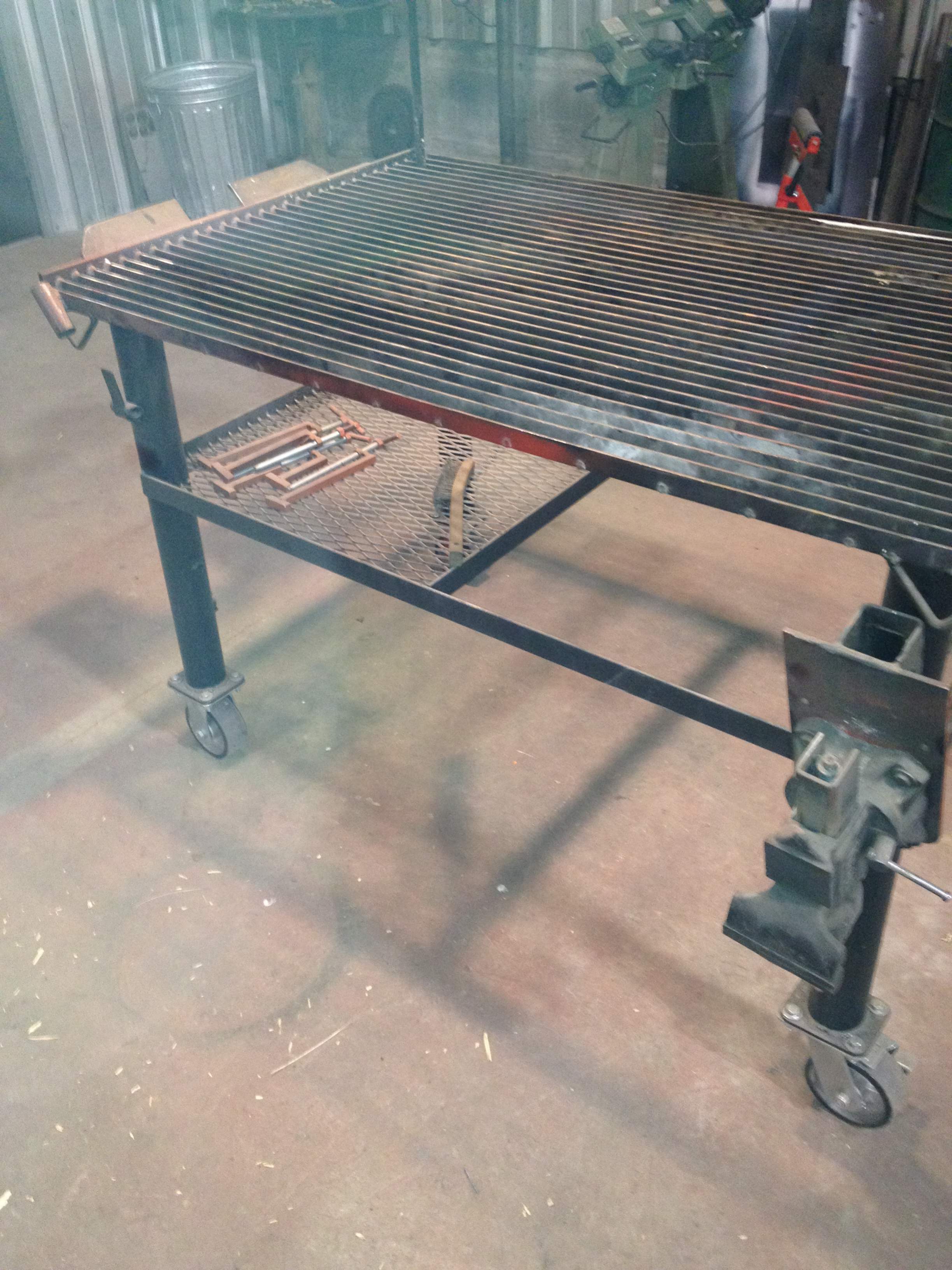

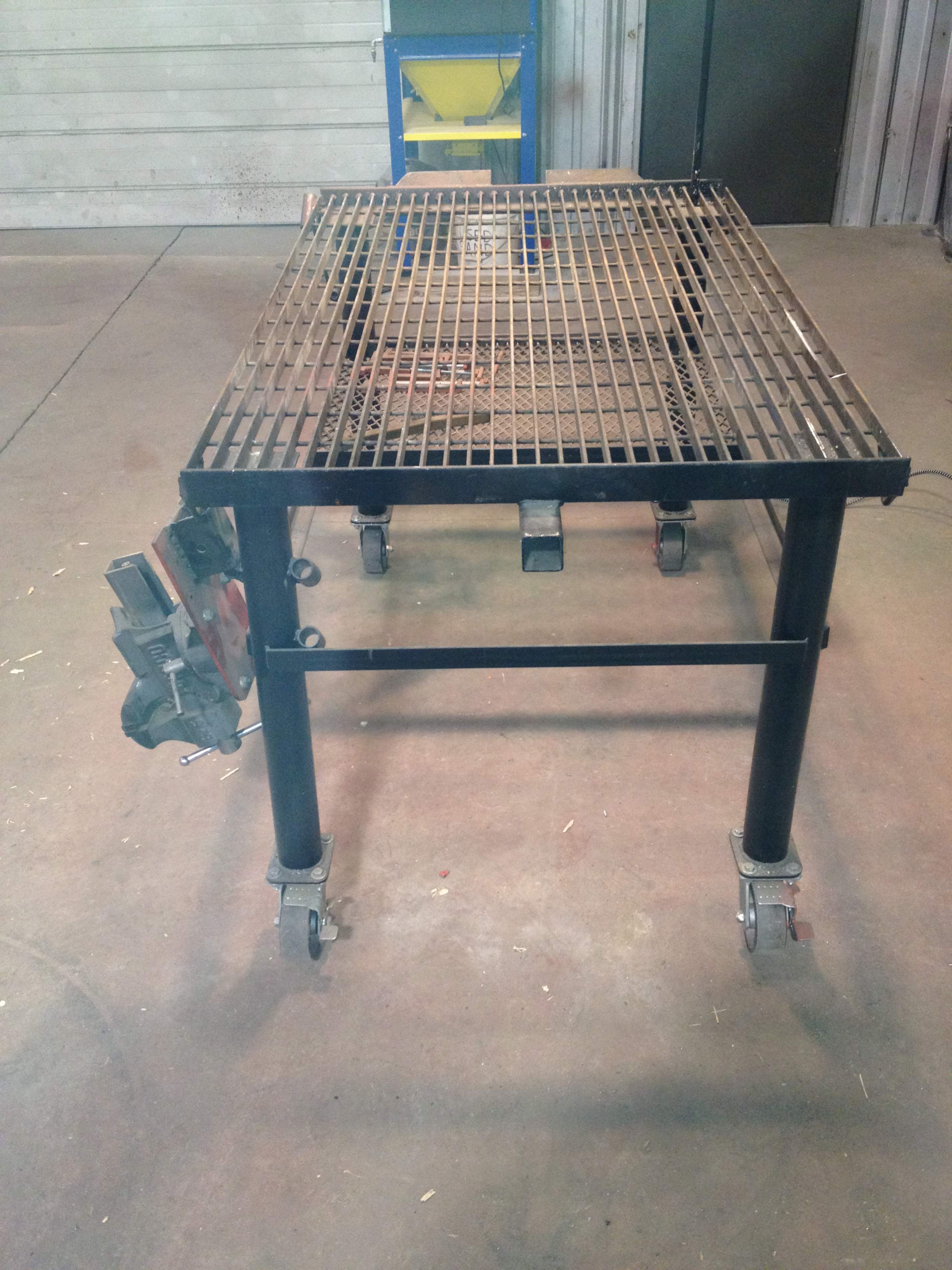

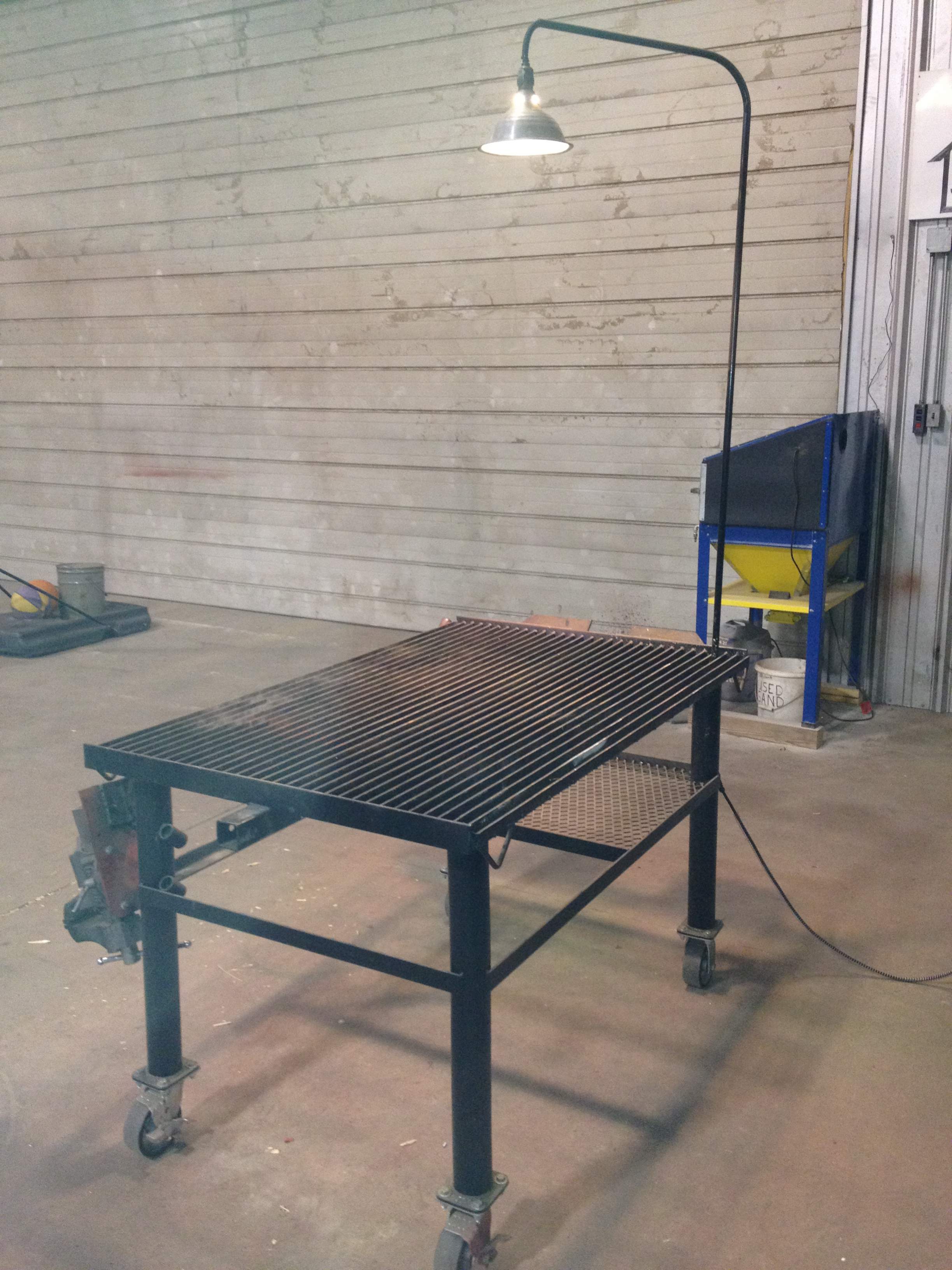

Here's mine. Got the grate from the old high school welding shop for 20 bucks. Had some 3" heavy wall tube laying around and added a 1/2 bottom shelf with expanded, overhead light, and 2 pcs of 5" angle iron with the V open for clamping and welding round parts. Added some 4" castors to move it around easier. Also added square tube to hold either a small vise or my hand shear reciever hitch style. I built this the same height as my main workbench so it does double duty holding long steel or wood projects.
Nice thing about the expanded and the grate is all slag and junk falls thru to the floor.
I bet that light is nice. That's a problem for me when welding... shadows.

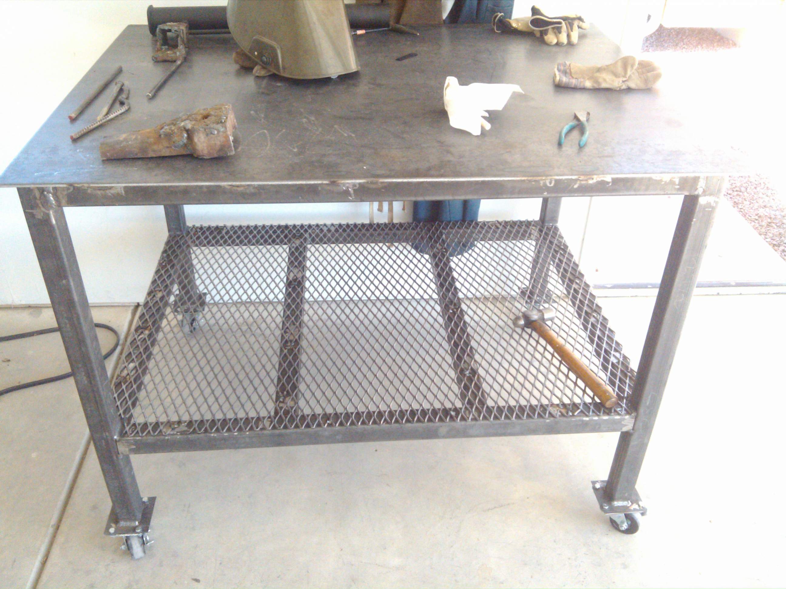

Here is a table I made that really makes it worth making. Before making I did everything on the floor.

I really need to get wheels on my welding table. I had been afraid that it would roll away and be a pain that way, but seeing so many wheeled tables on this thread without complaints makes me think that maybe it wouldn't be so bad. My shop is small and nothing gets its own space. The welding table will be a lot easier to move with wheels.
   / Welding Table Ideas #25
I can't imagine doing everything on the floor. I'm using an old metal clad door on sawhorses until I get more experience.
Your table looks very nice :thumbsup:
Ken
