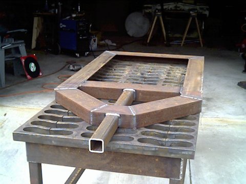

I went to a metal fabrication shop and asked about purchasing a piece of 1/2" thick steel plate for a welding table top. He has a pattern cutting macnine which cuts out numerous duplicate pieces out of a sheet of steel....the resulting scrap just happens to be an excellent piece for a table top.
We went out back and took a look at the scrap. The piece he showed me was 1 1/2" thick (Yeah!!! Big Stuff). I immediately agreed that this would be satisfactory and had him cut me off a piece 3' by 7'. It's big and heavy and with all the holes in it, it allows you to clamp things almost anywhere....not just along the edge. And, the price was right...$50.00 (scrap steel price).
I built a table out of 3"X5" angle as well as 2" square tube and used 6" steel wheels. Works like a charm.
Had to use a fork lift to put it in the back on my van and an engine hoist to remove it and place it on the table.
I've been extremely pleased with it.

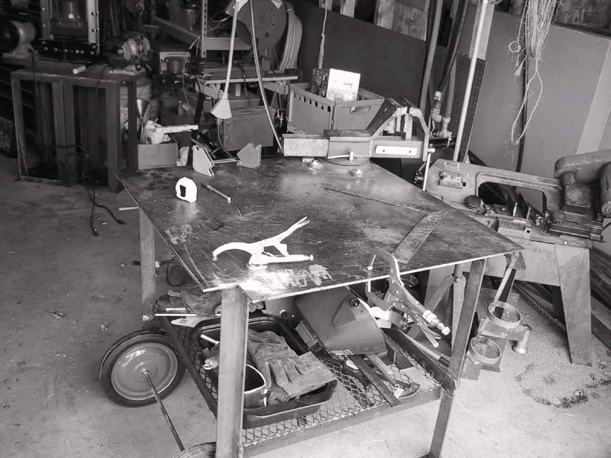

Here is a welding table I made from scratch. I got about $90 of material in it. The top is 1/4 " thick and 3 X 3 ' square ; the edges are free so they'll accept clamps. The legs are moved back about 5" for the same reason. The squared notch on the corner is real handy, both for welding and grinding.
On the side opposite the wheels put a trailer hitch ( 2" reciever that will accept a 1- 7/8 ball) Then make a 2 wheel cart (kind of like a dolly) with the 1-7/8 ball sticking up that will fit under the hitch when upright and lever that end of the table off the ground when rotated downward so table can be moved around. /forums/images/graemlins/cool.gif
