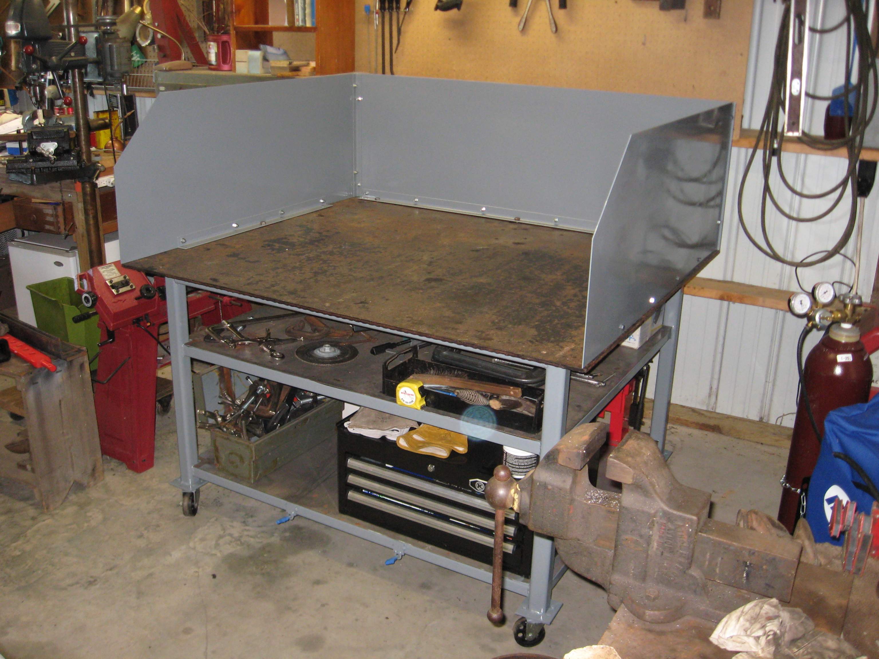

#20
Added some side shields to the table I built last winter. Used 1/8 inch sheet for the sides and 1 1/2 and 1 inch angle for the attachment. They are HEAVY.
My shop is kind of tight on space and I didn't like the idea of welding spatter and grinder debris landing on everything around the table.
Incidentally, I used a Harbor Freight metal cutting circular saw blade to cut the sheet and it worked great.
