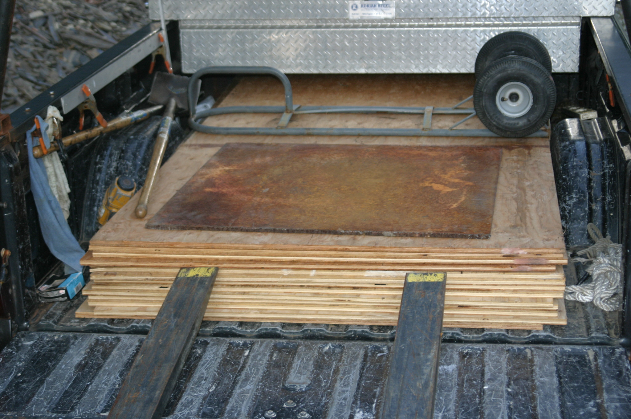

Heres a pic of my welding table I put together a few years ago I got a good deal on the 1/2 "steel plate from my local steel supplier.It's only 3 ft wide by 6 ft long I have a small garage but it's a big improvement over the portable strong built table (folded up just to the right in pic) I had been using.

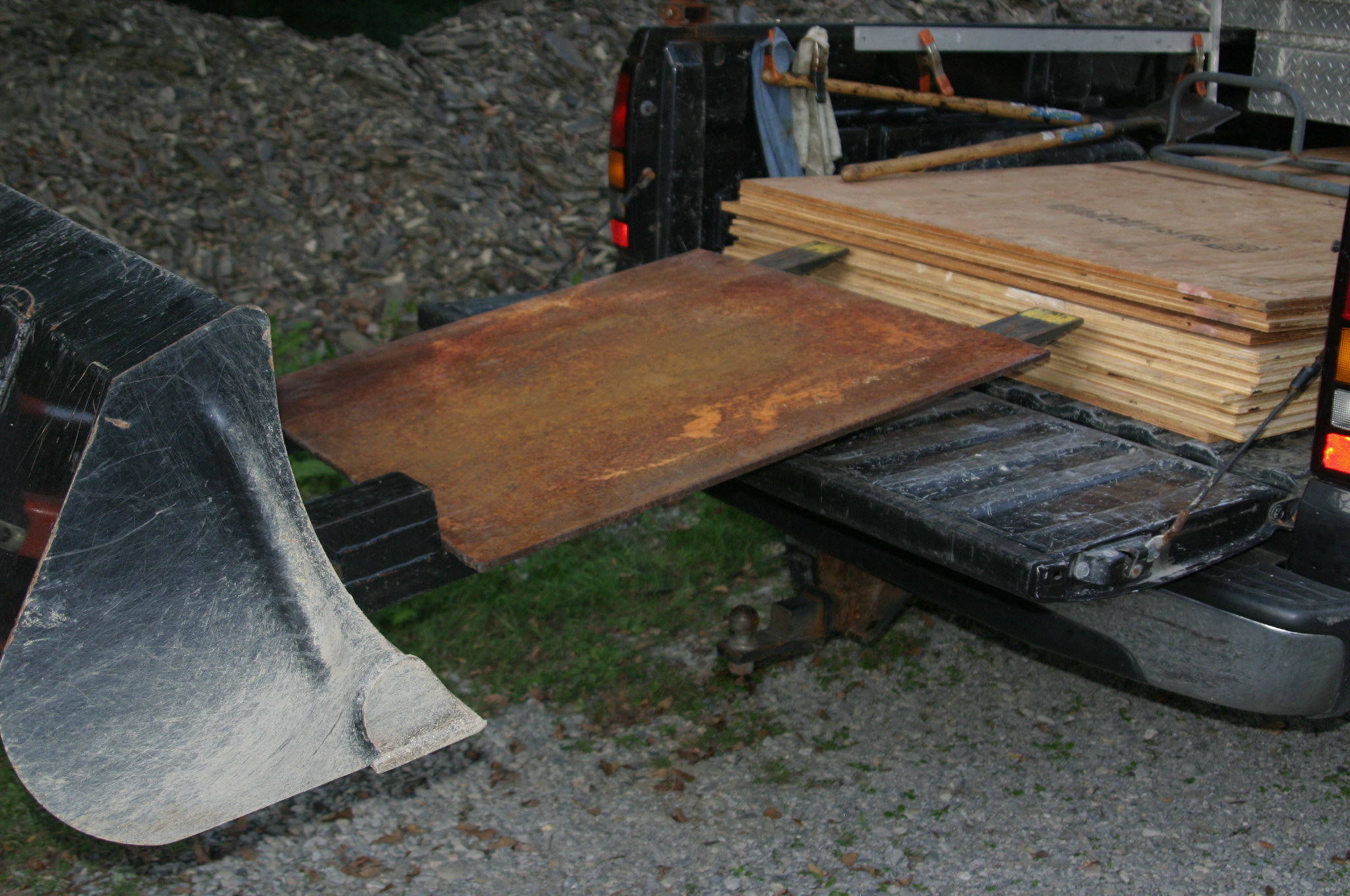

Gizmo2 its 32" inches high......I used 1/8 " square tubing for the legs and frame.I was a little concerned about the steel plate it was warped but luckily the heat from the welds drew it down and it sits fairly level now.I used my tractor with forks to set the steel plate on the tube frame. If I recall I think the hardest part was doing the welds on the under side of the table top.I probably should have set the steel plate on the floor and then welded it to the frame but I wasn't sure it I'd be able to flip the table back up right without damaging the concrete garage floor that suckers is heavy.:)
