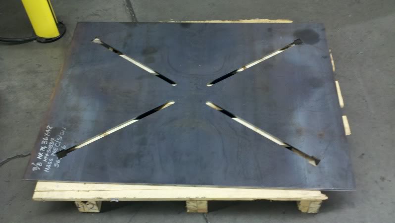

Heres a pic of my welding table I put together a few years ago I got a good deal on the 1/2 "steel plate from my local steel supplier.It's only 3 ft wide by 6 ft long I have a small garage but it's a big improvement over the portable strong built table (folded up just to the right in pic) I had been using.

Prefect table size. How high is it? I am getting ready to start the build of another new one for myself.

Gizmo2 its 32" inches high......I used 1/8 " square tubing for the legs and frame.I was a little concerned about the steel plate it was warped but luckily the heat from the welds drew it down and it sits fairly level now.I used my tractor with forks to set the steel plate on the tube frame. If I recall I think the hardest part was doing the welds on the under side of the table top.I probably should have set the steel plate on the floor and then welded it to the frame but I wasn't sure it I'd be able to flip the table back up right without damaging the concrete garage floor that suckers is heavy.:)

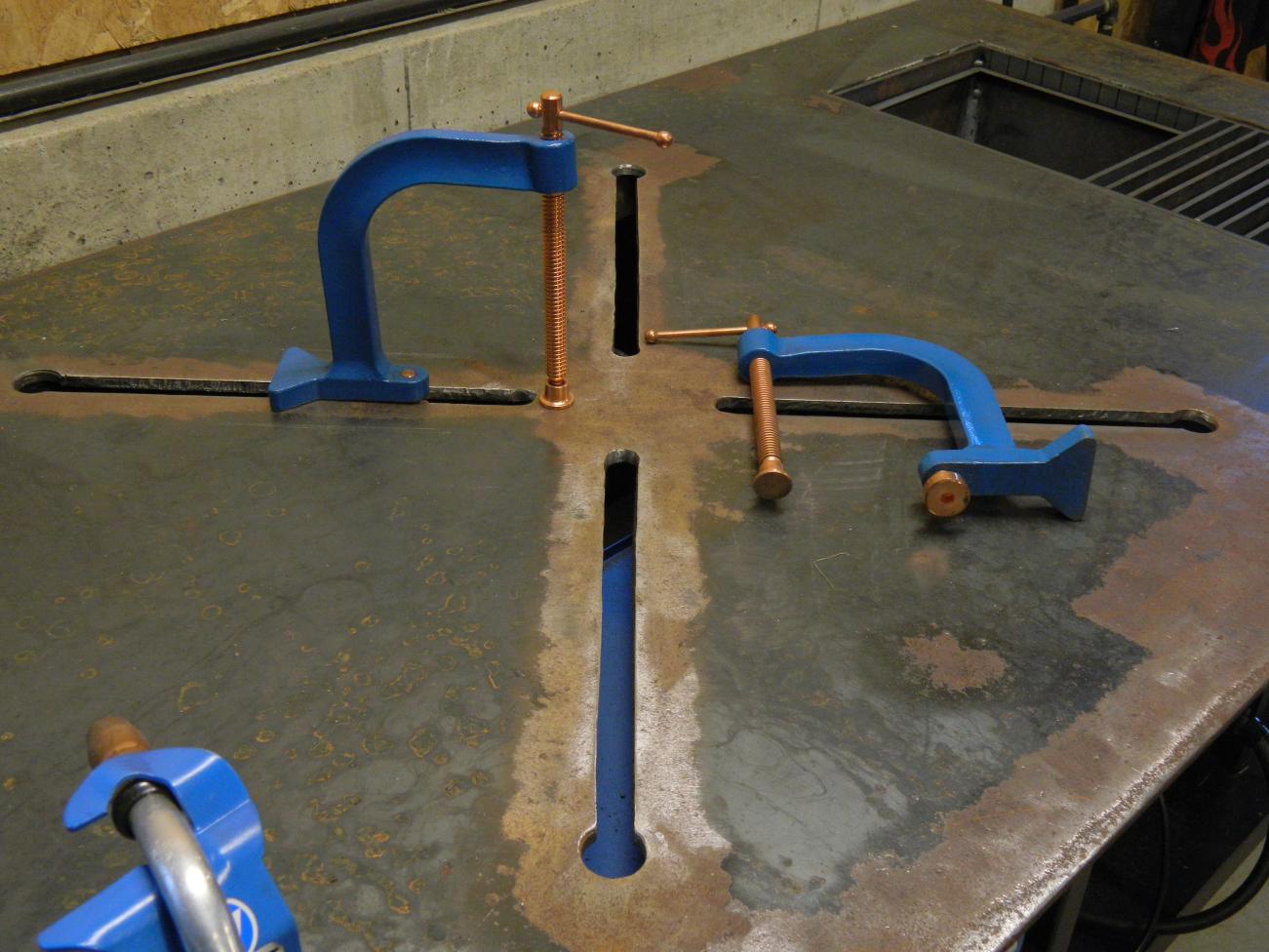

I think over did mine... 36"Wx72L 35"H with 4x4 legs and 1/2" top.
SO I HAVE TO KNOW WHAT GAUGE AND OR THICKNESS DID YOU USE FOR YOUR 4X4 SUPPORTS AND CROSS MEMBERS I AM PLANNING ON MAKING A SIMILAR TABLE AND WOULD LIKE TO GO CHEAPER ON MATERIAL IF POSSIBLE, DID YOUR TABLE HAVE ANY FEEL THAT IT COULD TIP OVER WITH SUCH A HEAVY TOP PLATE AND CASTER WHEELS? BY THE WAY I LOVE YOUR TABLE BEST I'VE SEEN YET, CONGRATS..
/ Welding Table #92
Wow. Now that's a welding table. Nice work. If you could do it all over again, is there anything you would change the second time around?
