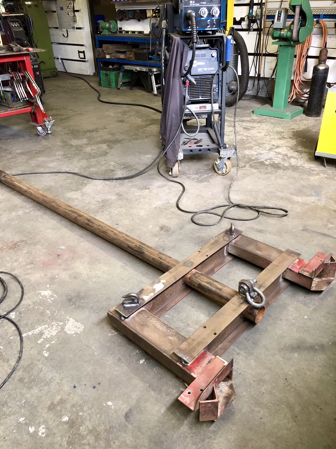

Back to the OP. I stick welded (SMAW) the last hooks I installed using 7018 rods, mostly because stick welding is my favourite process.
I could have used dual shield (flux core arc weld -gas) which is REALLY fast but I’m retired and saving 3 minutes for three hooks isn’t a deal breaker.
