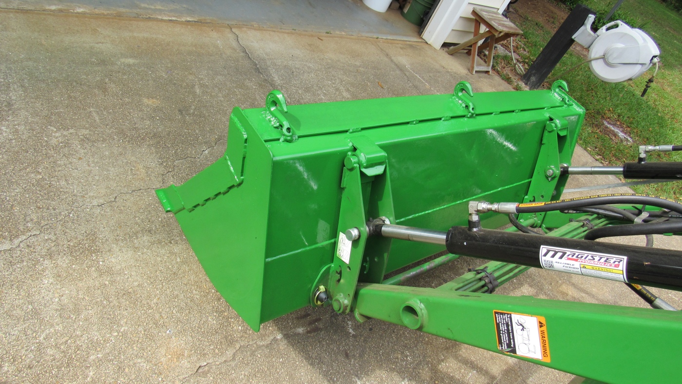

You old welder looks to be in pretty clean shape.. Crank that bad boy to 125 amps DC with some 7018 and you would have those hooks on in no time.

I welded my hooks on to a piece of plate then bolted the plate on the bucket .

I welded the hooks and reinforcements on my bucket with it on the tractor. Made it easier to get to a good working height while I welded. I used my Lincoln SP100 120V mig. No problems with electronics or strength as far as I can tell.
I would be concerned about inadequate penetration.

The answer to the question is arc, not gas. But a mig or flux wire is capable.

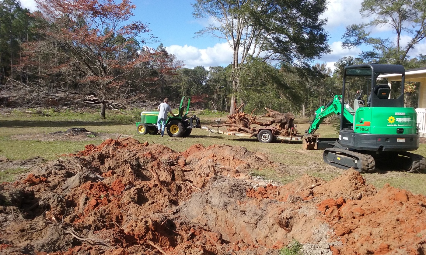

Yee have little faith. I've been welding with this machine for 26 years and ain't had one break yet. I welded a 36" thumb on my New Holland 575E backhoe 3 years ago and have worked it every week without any sign of fatigue.
I built this utility trailer with it the same year I bought the welder and it still hauls everything I throw on it. I accidentally bent it a little with these stumps and putting down force on it with the excavator but I was able to straighten and reinforce it where it bent. NOTHING BROKE!

Yep, good old ark and crank up the amps for a good job.
If the surrounding metal glows a bit you know you have good penetration.
