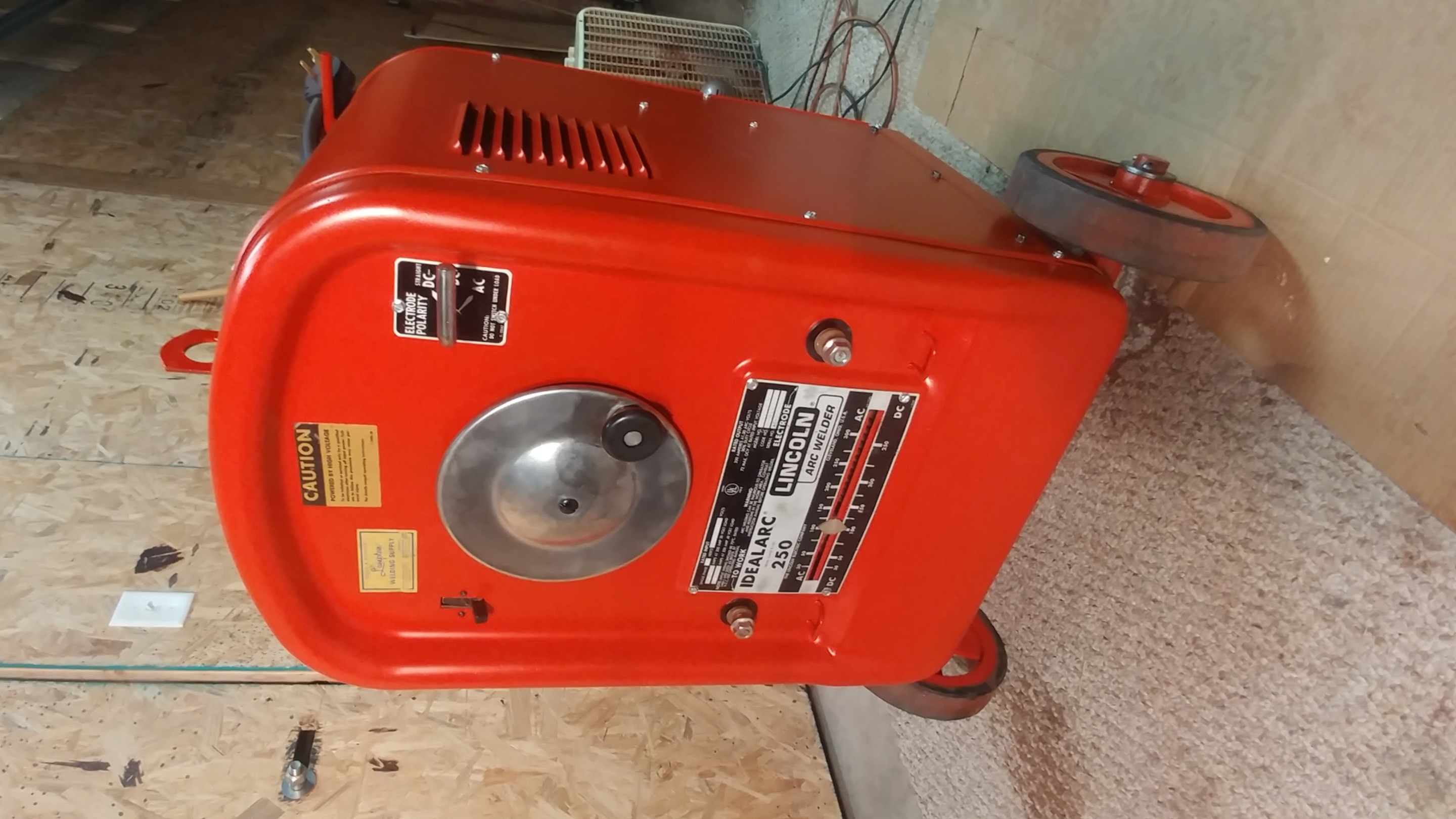

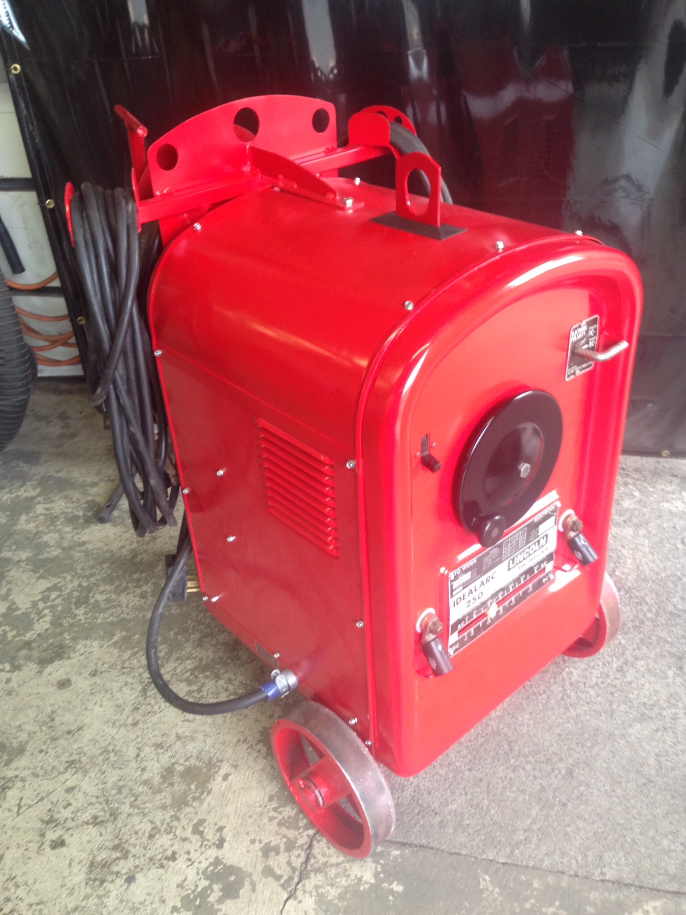

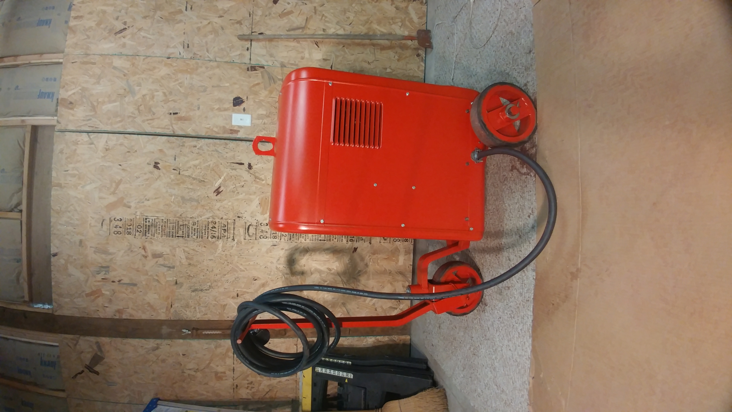

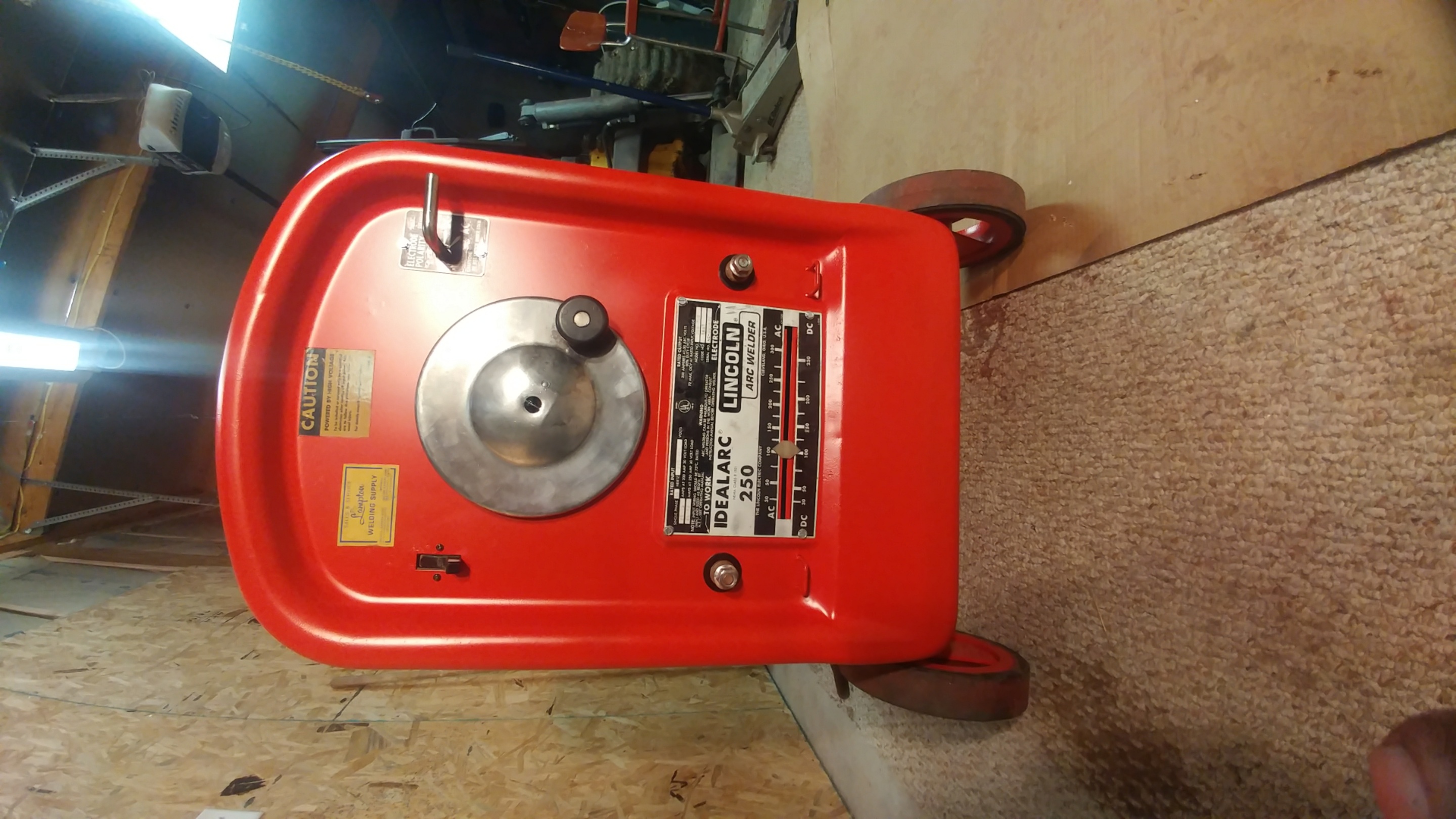

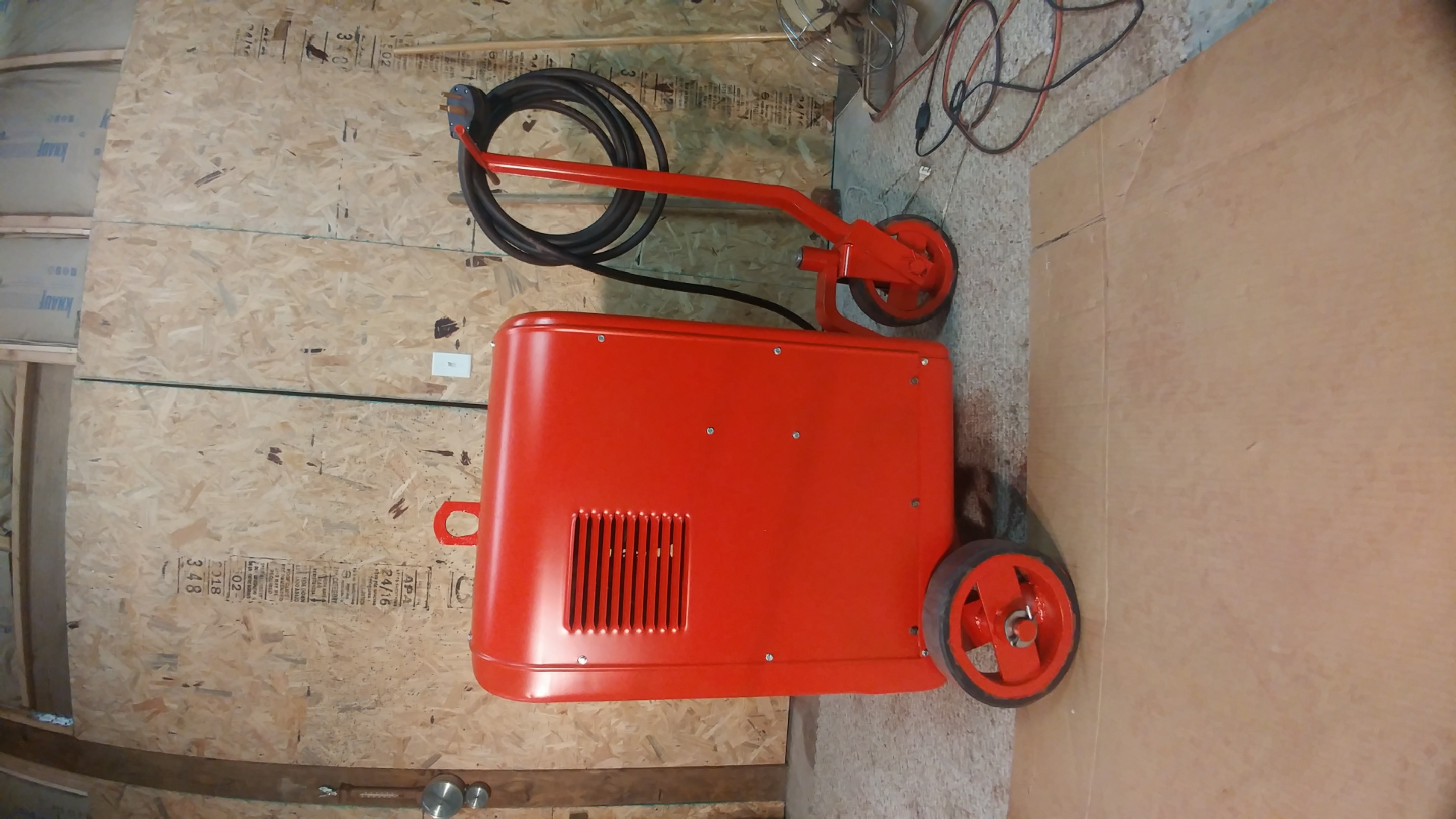

I had to check the shop to see if my welder was still there. LOL
   / Welding to FEL Bucket --- Gas or Arc? #29
ive got some pictures of that cable mgmt in some other pictures i just havent gotten around to fabricating that part yet HA!!! nice welder i debated whether to go with black on my dial or not couldnt decided what i liked better
   / Welding to FEL Bucket --- Gas or Arc? #30
I went black on the dial because I was too lazy to polish out the scratches.
