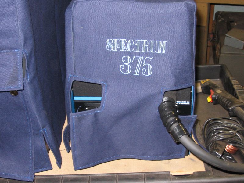

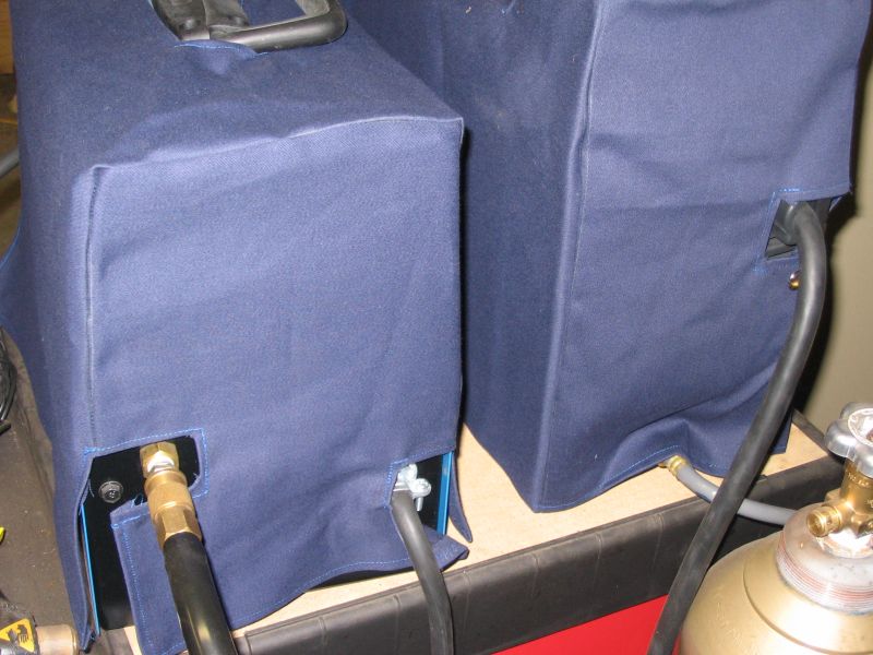

Hosskix said:
I've already looked into getting a cover for the welder and tanks, but in all likelyhood it'll be parked under a shed most of the time and if it's raining, I ain't welding!
If you want a heavy duty denim fabric cover for your welder, there is a poster over on the Miller and Hobart boards that custom makes them. He also sells on Ebay but I don't know his username. I bought 3 of his covers for my MM251 mig, Spectrum 375 plasma cutter, and TA185 tig machines. His username on the welding boards is Fun4Now. He makes quality stuff for a reasonable price.
The pics show the Spectrum and TA185. He had to send me another one for the Spectrum since Miller changed front panel designs in early 2006.

Miller makes a cover for that machine, it looks just like my Bobcat.
