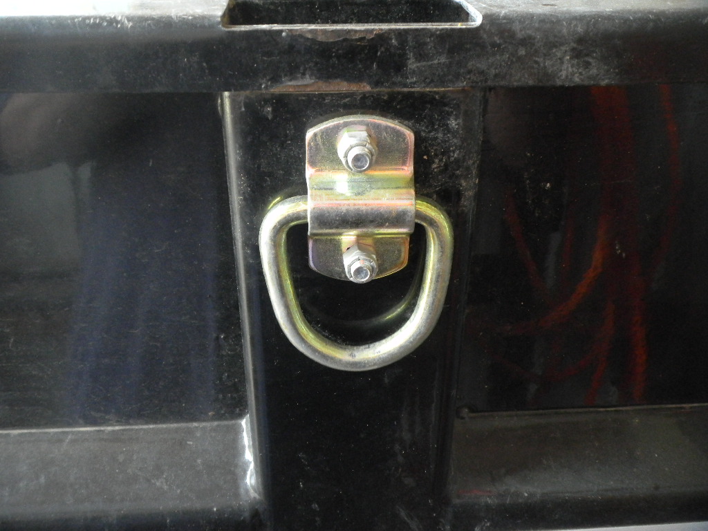

Which would be stronger the welded on trailer D-rings if weld is about 1'' on each side of bracket vs bolt on D-rings with 2 bolts 1/2'' grade 8 course thread or would they be about the same? Does the welded one become part of the trailer and not a weak point?

How thick is the material you'll be welding to/drilling thru?
/ Welding vs Bolt on #4
Very relevant for understanding what sort of Working Load Limit the mounted ring will have when done. Does this play in when considering whether to weld or bolt on?

Material thickness does enter into the decision. If there's sufficiently thick material, the bolts will have enough bearing area that they don't yield the sides of the hole. Good bolted joint design would also suggest that the part of the bolt that bears against the hole is a smooth shank; not threads. Other good design practices: as smooth a hole bore as you can manage - reamed, if you can. Also, hole size just a tad bigger than the bolt shank will reduce bearing stresses, too. And don't forget to put thick, flat washers between the nut and the hole! I have hooks bolted to my FEL and they have handled some good sized loads - I've maxed the 724kg loader lifting logs with them. I never apply a jerked load to them - at least not intentionally. They rely on static friction of the clamped joint to stay put up until the point they start to slide, then dynamic friction takes over, and it's much less helpful. Before you know it the clearance between the bolt and hole have disappeared and now the bolt and the metal on the sides of the hole start loading in shear and compression. That's when a smooth hole, smooth bolt shank and large contact area keep everything from going "DOINK".

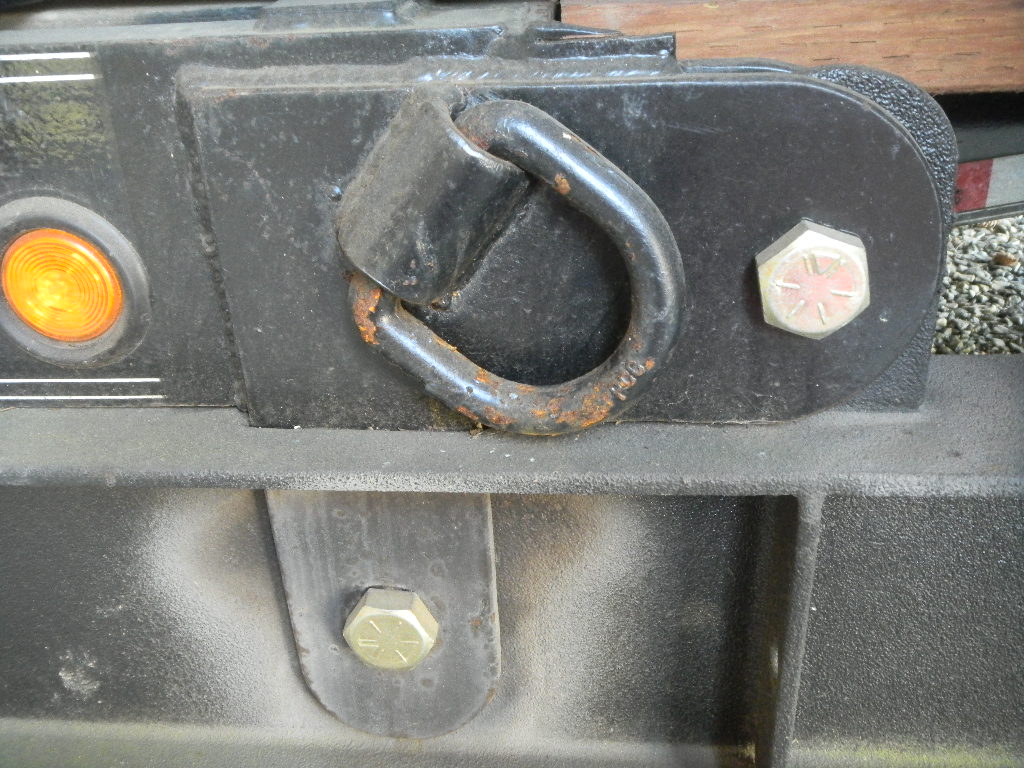

Here is a bolted D-ring on my dump trailer.

Your pic raises another question... I would expect, especially giving consideration to Baby Grand's comments on "process", that the bolt head should be against the D-Ring plate and not the nut end of the assembly. How much difference in bearing capability could this make?
/ Welding vs Bolt on #12
No difference at all in my opinion.
I placed the bolts inside the stake pocket, I figured it was easier than trying to thread the nut on the bolt, with the nut on the inside of the stake pocket. I used fender washers on the heads of the bolts, because the stake pocket material is really thin.
/ Welding vs Bolt on #13
I wouldn't expect a difference, either. But, Baby Grand made a point about reaming the hole (so it was smooth) and placing a smooth shank bolt instead of threads where it passes through the hole... So, I'm wondering how much load bearing ability one loses because of having threads that can come in contact with the edges of the bored hole.

with two 1/2" gr8 bolts having a tensil capacity of ~45k lbs and a shear of 35k lbs and welds being just as strong (if done right) or stronger, Me thinks other things will bend/break before the attachment method of choice.

That was the point I was trying to make before I got all sidetracked on design - for the loads that an FEL would see, a bolted joint should be just fine.

Sounds right. Having them the other way around would help if it was loaded to the point that everything starts deforming and the flange starts prying the nut from one side, but that shouldn't ever be an issue in this application. In this case, which ever arrangement lets you torque the nut more carefully is probably best.
