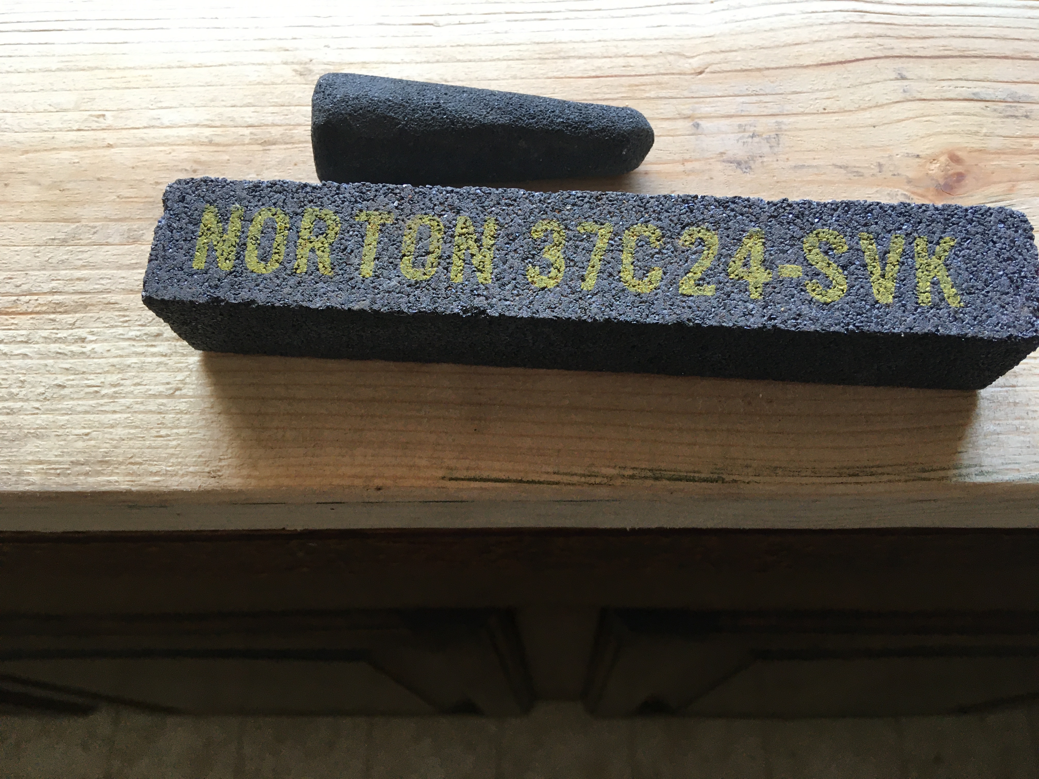

Those bed frame irons are high-carbon steel, and for that they are very prone to work-hardening in the cut with the friction-heat of saw teeth or drill bit pressure. (Metal Shop 101)
To saw or drill them use low speed high pressure and coolant vs 'lube' which is typically a worst choice if it's "oil". IMO&E, washer fluid &/or Windex are the kings of underrated home shop quick job coolants when tooling bed frame-type hot-rolled angles channels, H-extrusions.
I still use an abrasive cut-off wheel. Common error is to force the cut. (Its a grinder, not a saw.) This can load up a wheel on some metals (soft steels, alum, yellow metals). Use your dog turd (rounded/abused wheel dressing 'stick') to touch a spinning wheel and keep the grit open. If a grinding wheel ever slows down on you, then you ain't no grinder, either!
When I bought my abrasive chop saw years ago the rep showed me how to use a light controlled CHOPPING motion. In addition to not overheating the disc I think you get less blade deflection which is the cause of “out of square” on deeper cuts.
I really don’t think many people use this method but I have to this day with virtually no problems. 40 years of use on the farm with only a broken spinner handle on the vise, blade replacements and regular BJ’s for the motor. Nothing to complain about.
Good idea on the dog turd. It never even occurred to me. I have one for my belt sander. What a dumazz!
View attachment 640547 View attachment 640551
Do you ever use a "coolant" like washer fluid on regular mild steel or do you go back to the oils?
