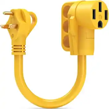

Looks like this , Will this plug help? Both welders are champion 4000watts, strange one is a 4 wire and other a 3

/ Welding with 4000watt generator #8
Nope, that splits the 220 to 120.
If your welder has an actual plug you need the adapter to get that plug to the generator, probably this one? Just look at the plugs you've got, there's a lot of 220v variants.

Frig it, Atleast I can weld 5/64 , adapters are like 80$

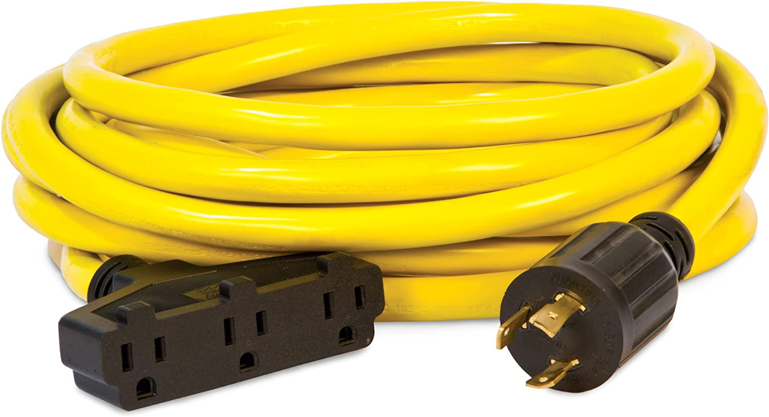

Id need this one for the generator i'm using , Is it worth it?

If i could weld 3/32 id buy it, thx
