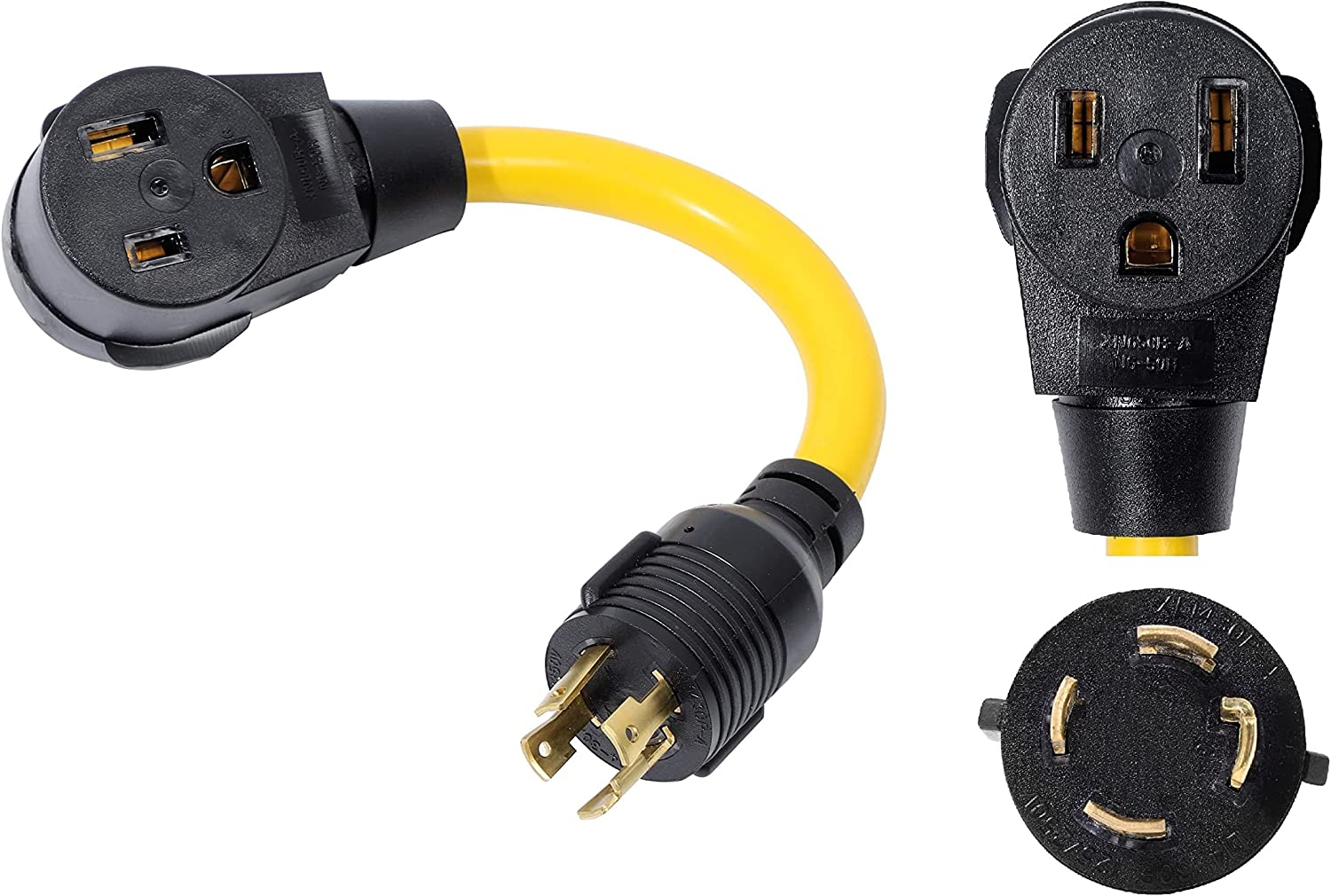

If you run 240 volts, the #12 would work at 100 feet because your welder only needs 18 amps when running on 240 volts, and the 12 gauge would still keep voltage drop below 3%.
As far as parallel operations, unless your generators are IDENTICAL INVERTER types, there is no simple (or safe) way to accomplish that.
There's no need for parallel operation ANYWAY, because ONE of your generators with the proper twist lock 240 plug will let your welder do ALL IT'S CAPABLE OF... Steve

Thx... Il buy adapter and try

Found one for 45$ going to try
