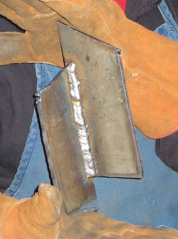

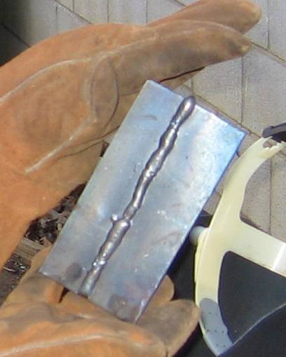

you are a pretty good welder,,[just looked at two,,up 7018 and overhead 6011 believe it was],,,,can't do any better up than that with 7018,,,,the overhead,,,to much gap,,and or not enough land,,etc,,,,you got to experiment with these gaps and such,,,,I always used about 1/16 gap and 1/16 land,,thats in inches,,,,cause I was a down hill welder,,down hill you don't gap it very wide,,you butt that rod up against bevel and push it in,[rod tip is actually touching steel,,or there abouts],,,what I'm saying to you is,,,vary your gap,,,experiment,,,,vary your land,,experiment,,,once you put root in,,you are done on backside,,its got to be 100 percent,,,if you take plates down and grind off root stick through,[penatration],,than you shouldn't have to grind off much more than flush to get to plain shiny metal,,if you can't do that,,than you need to change your set up,,,whip and pause will leave you with voids in root sometimes,,not acceptable to code,,,,thingy
You really do know your welding, this is exactly how it works and most folks wouldn't have a clue what you are talking about. Back when I went to college for welding part of the requirements for graduation was to get certified in a number of processes and positions. The two hardest for me were the root pass on pipe and all position gas welding of aircraft frames. Yes, we did weld aluminum Coors cans for fun!

AlanB said:
I should probably not speak for sberry, but he quoted arc welding rods on his picture names, so I would expect they were GMAW (Arc) welded.
6011 would conventianally be AC
7018 probably DC but could go either way.
In his first post me thinks the top 2, and the bottom pictures are wire.
Monte
Monte
I must first apologize, I wrote GMAW, and that is incorrect, it would be SMAW, (ARC) welding, not sure where my mind wandered off to but it must have wanted a little time alone :D
Monte, as to saying it is wire welding (which would be GMAW or more commonly called MIG) why do you say that? Or what makes you believe those are wire welds?
I guess the sberry is the one that needs to really answer the question though.
