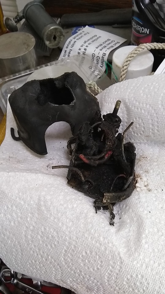

Looked out the kitchen window this morning and saw my well on fire. I had one non Kidde extinguisher on the wall and grabbed it. The plastic pin broke and wouldn't release the trigger. About that time I thought to turn off the breaker and the fire went out. Wasn't enough left of the pressure switch to determine the cause but a new switch and gauge got me back in business. I ended up cutting the pin out of that old fire extinguisher and hangin it back on the wall. Hate to throw anything away that might be useful. Won't take but a second to see if it will work next time I need one and another is always close by.

Bad connection = heat = fire.
Either the contacts or loose wires.
Or lizards? We'll never know now cause it was too charred to tell. Last service was December 2010. Funny thing was the pump ran right up to the end. I still had 50 PSI on the tank and wife was in the shower.

That's pretty much the only cause of electrical fires. Unless you have a short or overload and your overcurrent protection does not work. A bad connection makes heat but does not trip overcurrent protection, hence the invention of ARC fault breakers.
With the vibration of the pump, I would guess a loose connection over bad contacts.

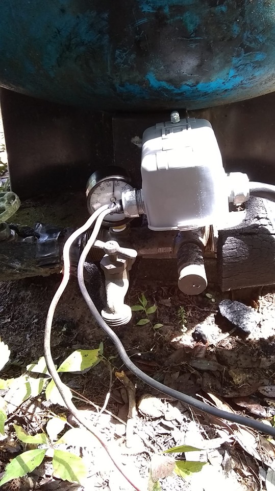

It was your pressure switch that was on fire,not the well. Switch looks like it's outdoors, they're not rated for a wet location, I don't believe. It might help to get it out of the weather.
Duh! You're kidding right? How many un housed wells do you think in this world?
This is the third pressure switch in 45 years. The second was just changed because I put a higher rate pump in.

It is a WATER well pump - how can it NOT be rated for wet locations? How about pool pumps?
/ Well Caught Fire #18
Well pumps aren't generally left exposed to the weather. They're usually in some kind of housing to keep the rain and Sun off, even if no bigger than a dog house that can be lifted off.

So what burns?
You would think if it was loose terminations, insulation would melt and eventually the copper (or aluminum?) conductors, circuit would open and that would be that. No?
Would "drippings" be hot enough to ignite plastic cover?
Or did some critter get in there and slow roast until it combusted and ignited?
