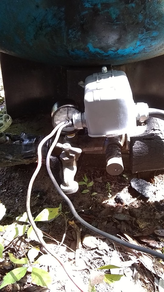

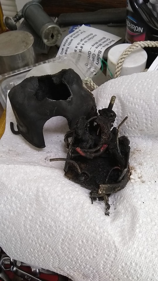

Looked out the kitchen window this morning and saw my well on fire. I had one non Kidde extinguisher on the wall and grabbed it. The plastic pin broke and wouldn't release the trigger. About that time I thought to turn off the breaker and the fire went out. Wasn't enough left of the pressure switch to determine the cause but a new switch and gauge got me back in business. I ended up cutting the pin out of that old fire extinguisher and hangin it back on the wall. Hate to throw anything away that might be useful. Won't take but a second to see if it will work next time I need one and another is always close by.
Test your bladder tank. The number one cause of a pressure switch burning like that is a failed bladder tank.
That causes rapid cycling of the switch and pump which overheats and destroys the switch and pump.
Thanks for the tip. I will keep an eye on it. It seems to be cycling normal but I haven't stood over it past one induced cycle by running the water at the tank. Pressure seemed to remain steady after it cycled off. I have a KWH monitor I can install at the breaker and check it.

Well pumps aren't generally left exposed to the weather. They're usually in some kind of housing to keep the rain and Sun off, even if no bigger than a dog house that can be lifted off.
Down here you rarely see a pump house. Doesn't get that cold for any length of time.
/ Well Caught Fire #24
It was your pressure switch that was on fire,not the well. Switch looks like it's outdoors, they're not rated for a wet location, I don't believe. It might help to get it out of the weather.
You may as well drop the subject,OP know's exactly what he is doing and why he is doing it so you are not going to convince him to inclose his pump. The humidity and temperature are high nearly year around. Consequently cool water cause's condensation on pipes and tank 12 months of the year and humidity stay's 100% inside house. As it is,sun keep's equipment dry. Tractorguy can also be stubborn when folks try and tell him what kind of snowplow he should buy and how he should store it.

In my area the pumps are in the well, and the pressure tank and switch is in your basement.

Sorry about your well fire. BUT - the fire extinguisher that the pin was stuck in would quickly be discarded. No way, no how, would I want to trust a fire extinguisher again that had failed me once before - for whatever reason. They're simply too cheap, but too valuable when you need it the worst. Buy a new one.

I have an underground concrete pump house. Everything in there is covered in sweat at certain times of the year. I don't think my pressure switch could get wetter if left out in the rain. In fact, the plastic cover would protect it from rain and keep it dry. In the pump house, it will be wet, inside and out. The switch has never failed due to moisture, only hard water scale.
