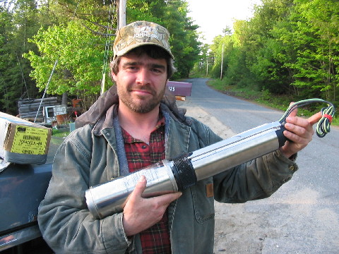

ok the next place i want ot take u guys is the pump curve page for the pump that gman is the proud new owner of /forums/images/graemlins/grin.gif /forums/images/graemlins/grin.gif it's at sta-rite.com and we are looking for....
got to sta-rite then got \products/residential /then\water systems/ then\submersibles/then\ j series / then \literature/then\4"- 5&7gpm/then git page 5 and bring that back here /forums/images/graemlins/grin.gif /forums/images/graemlins/grin.gifor u can bring the whole literature (8 pages back!!!!) whatever u want dude but that's yer "signature 2000 series" 7gpm pump!!!! /forums/images/graemlins/grin.gif /forums/images/graemlins/grin.gif /forums/images/graemlins/grin.gif
and here's a pic of that little fly junkster buzzin round my house!!!!!!!! /forums/images/graemlins/grin.gif /forums/images/graemlins/grin.gif /forums/images/graemlins/grin.gif /forums/images/graemlins/grin.gif
   / WELL DONE!!! FER ALL TBNER'S AND BETWEEN GATOR BOY
#38
Re: WELL DONE!!! FER ALL TBNER\'S AND BETWEEN GATOR BOY
the motor that is on your pump david is a franklin electric 230 volt 1//2 hp. model 2445059004 that runs at 60 hz and draws 5.0amps and is a single phase 3450rpm motorit is themally protected and has a built in lightning arrestor to boot /forums/images/graemlins/grin.gif /forums/images/graemlins/grin.gif it's jist like mine cept iv'e got a 3/4 h.p. notor that pushes 5 gpm and with your water level your pump will push jist about !!!!!!! 10-11 gpm!!!!!! thats between 600 and 660 gallons an hour...think you'll b able to water some trees with that ????????? /forums/images/graemlins/grin.gif /forums/images/graemlins/grin.gif

You have been a busy boy. The pump looks great! Is it cool up there? I see you wearing a jacket -- it's 90+ here today.
I don't think I need to set this puppy 180' down, I would think 100' would probably suffice.
