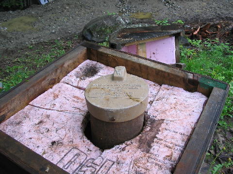

lmao....sorry bird i had to go back and figure out what junkman was talkin about but when i did i bout fell out of my chair....sssshhhhhh it's 3:50 am and couldn't sleepso went ot git a glass of water and the pc.just beckoned....gotta be careful i don't wake the better half...junkster i don't think i'll git back ot sleep at all now as am wide awake ....yer killin me ...sorry bird!!!!!!!!he jist had me rollin /forums/images/graemlins/grin.gif /forums/images/graemlins/grin.gif /forums/images/graemlins/grin.gif
just for those that wanna know...tonite i should be finishing on the pitless and the well cap vs. the well seal..and gittin techno too...3 phase vs. single..wire charts...distances ga's (gauges)
and hopefully with some of the great guidance and instruction of our well hero "gatorman!!!" /forums/images/graemlins/grin.gif we can get some graphs on here to and go into depth on gen's and 2/3/4/&5/wire pumps c yall tonite.. /forums/images/graemlins/grin.gif /forums/images/graemlins/grin.gif...TODD
oh yeah heres a pic of my well cap..

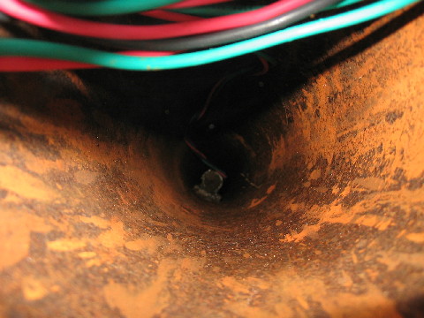

   / WELL DONE!!! FER ALL TBNER'S AND BETWEEN GATOR BOY
#59
Re: WELL DONE!!! FER ALL TBNER\'S AND BETWEEN GATOR BOY
and a pic of a pitless down in the well

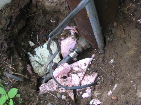

#60
and a pic of a properly installed (EXCEPT THE THING IS ONLY 1' DOWN AND WE HAVE A 4'-5' FROST LINE!!!!) PITLESS OUTSIDE OF THE WELL..HAD NOTHING TO DO WITH ME ...THE MORON THAT BUILT THE HOUSE (oops junkster..sorry i hurt yer eyes agin /forums/images/graemlins/grin.gif) improperly buried it ...cost us a week with no water this year!!! frozen lines and will talk about that at some time ..how to thaw line out /forums/images/graemlins/grin.gif
