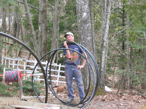

this is a pic of my bud jon having a hard time feedin the new well pipe 2 us because he was feeding the ingoing coil of new pipe from the bottom and had to go to him and recoil the roll and git it so that it would b feeding off of the top instead of the bottom which makes it easier on us while we feed it down the well pipe and tape the new well pump wire to the pipe at the same time...so jist picture the coil of well pipe round the other way and feeding from the top as we tape the new wire to it as he feeds it 2 us!!!

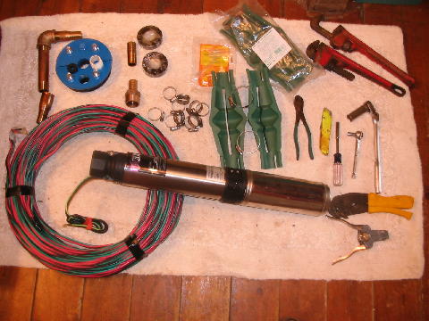

The way that I like to do the piping is to determine how much pipe is needed, which I believe we have done. With the length determined I like to unroll the pipe and measure and cut the desired length. With the pipe cut to length you can attach the pump to the pipe on the bottom end and the pitless adaptor to the top part of the pipe. I use the electrical butt splices with the shrink wrap specifically designed for well applications to connect the pump wires to the wire that will be taped to the pipe. I like to leave about 2 foot of extra wire on the bottom pipe down near the pump (tape it up so it is attached to the pipe and not dangling). This makes it easier if and when you ever have to change the pump. I like to tape the wire to the pipe about every 3 foot. At the top of the well you want to have about 5 feet of wire extending past the pitless adapter. This allows for easy connection to the wires that will be coming from the pressure switch. Once these wires are put together you simply tuck the wires down into the well casing so the well cap will fit onto the casing without touching any wires.
Before you begin to feed the pump and pipe into the well make sure you have a 1" pipe screwed into the top of the pitless adapter. The 1" pipe should be about 5' long. The whole idea is that once you start to feed the pump down you really don't want to stop because the pump will want to fall. This job is easier with two people but can be accomplished with one without to much trouble (so long as you have strong forearms).

OK guy's might as well start here!!! here is apic of the hardware that you wil need to put in a well!!!..including most of the tolls that will b needed /forums/images/graemlins/cool.gif /forums/images/graemlins/cool.gif /forums/images/graemlins/cool.gif
