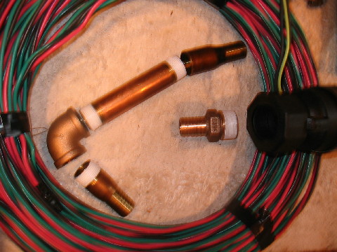

OK heres another pic 4 u guys ..this one is all the brass with teflon tape b4 being assembled!...when puttin on teflon tape always remember to go with the direction of the tightening thread...generally clockwise..when looking down on the threads...(unless of course u have left handed threads!! /forums/images/graemlins/grin.gif

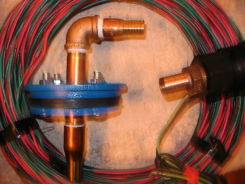

here is the pic of all the brass assembled and teflon taped up!!!!!!! get these connections really tight...and be sure to be liberal with the teflon tape /forums/images/graemlins/wink.gif /forums/images/graemlins/wink.gif /forums/images/graemlins/wink.gif /forums/images/graemlins/wink.gif /forums/images/graemlins/wink.gif /forums/images/graemlins/cool.gif /forums/images/graemlins/cool.gif

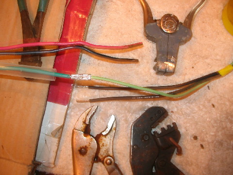

This first pic is of the neutral wire splice completed!!! First i used my crimpers to crimp..then a pull test which it failed!!!!
thus the vise grips and squeezed and flattened it down REALLY GOOD!!!!...flatten it out really good but not so tight that u literally push the copper through the butt connector...notice that i have the heat shrink on already...these are special splices which are like automotive type but are a lot heavier duty...first step i would suggest to put on all of yer heat shrink!!! that way (and yes ive accidentally done it) u dont forget the shrink and it's easy to do!!!
your run of the mill crimpers will not do this job properly but can b used to git the splice snug!!!! then hittit with the vgrips!!!! /forums/images/graemlins/cool.gif /forums/images/graemlins/cool.gif /forums/images/graemlins/cool.gif

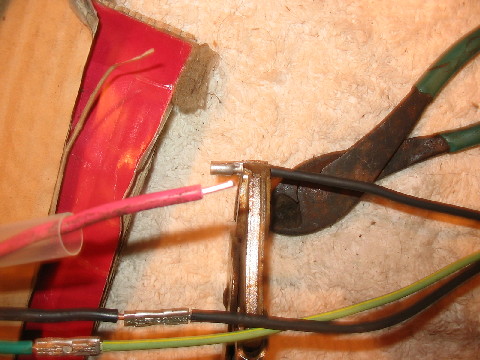

here's a pic of the vgrips at work!!!with one hot lead and the grnd already done!!!first crimpers..then v grips..i dont even bother with the pull apart test till the vgrips have done their work anymore!!!

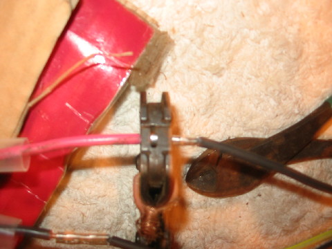

this pic os of the crimpers doin the last crimp on the last wire(hot lead)

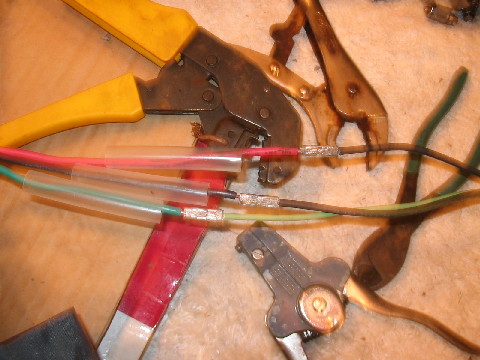

all three spliced...notice how the crimps are all staggered and the shrink is all on and ready to be heated!!! /forums/images/graemlins/grin.gif /forums/images/graemlins/grin.gif
