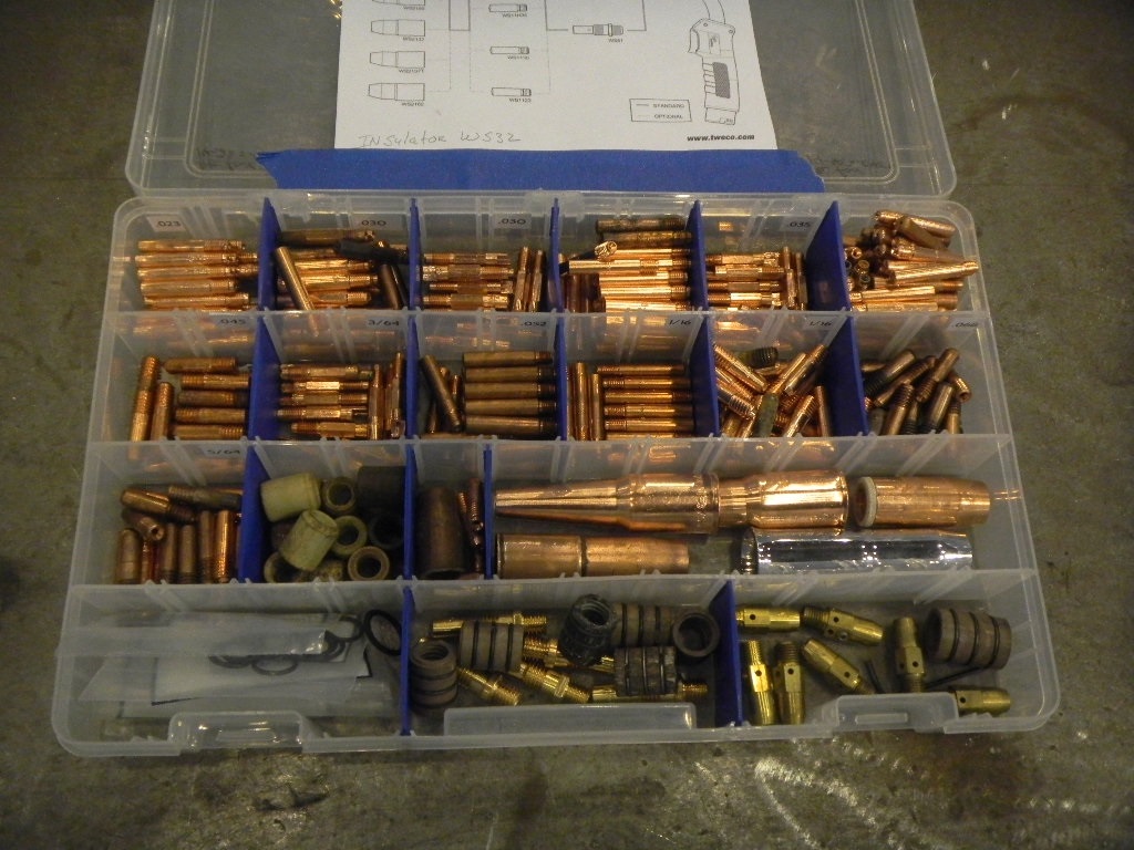

You need to return to AirGas and pick up some more supplies. ;)

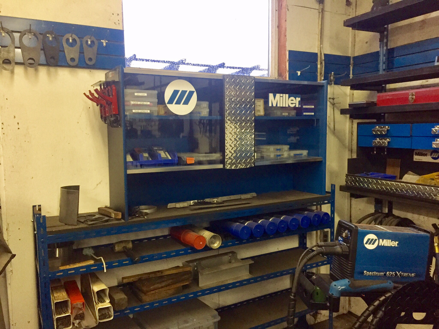

Wow! ,now there is some nicely organized supply cases. I recently bought a Miller X-Treme 12VS, I am worried I do not have a power source that will work.

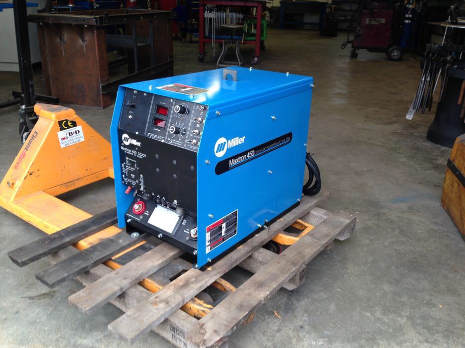

I see you are also from BC. I just recently sold this power source. It would have been nice for your suitcase welder (unless you needed an engine drive).

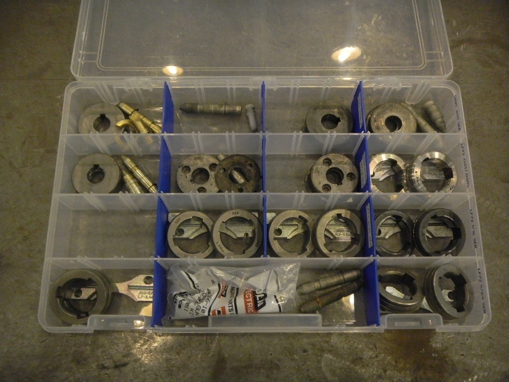

Tore down the Mig drive system (super easy I think). Found the 035 jammed in pretty tight on the guide rates for 025 to 035. It seems to have "scraped) a bit. Found the 035 to 045 guide in the parts box. Next the roller. It says 035. The spare roller says 025. The internet says the 025 should read 025 030 0n the front but mine only says 025. Gonna call.
So basically, getting a roll of 030 (11lb - 8" spool) and a small roll of 025 to have on hand. Also going to call Lincoln and ask them about rollers just to make sure I put this all back together right.

Carl, do your rollers only have a SINGLE groove? If double grooved, perhaps your spare roller is .030 on the flip side?
Personally I just run .023 - .035 - .045. Best check with Lincoln anyhow.
You can go crazy keeping all the combinations organized :(

JEALOUS on all of you guys. No, for my machine the rollers are one piece but I did find out the 025 is marked only 025 but does work for 030 as well. I got a roll of 030 and a small roll of 025. And changing the roll out is now looks a lot easier so pretty excited to get back to welding this afternoon.

You could PROBABLY run the .030 wire on the .035 roller also.
