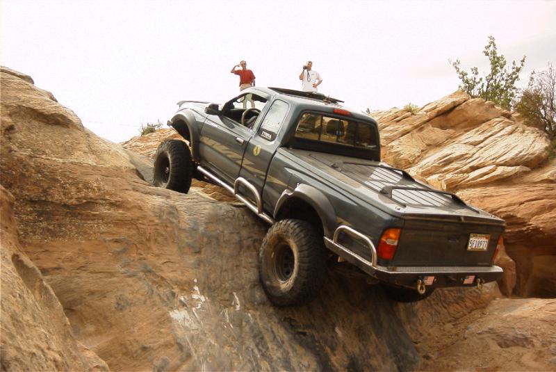

The other day I took my Toyota to work since we were having a freak blizzard. I left the house and it was snowing but the snow was not sticking to the ground. In less than 15 minutes the temperature dropped and snow was accumulating fast. There is a hill here with a JR high at the top and parents unloading kids causing traffic to back up. I didn't have my hubs lock in and having big luggy muds on, I couldn't get going again. The parking break was useless and I need to get out and lock the hubs while on a hill. So I took my briefcase shoved it under the front tire super quick, locked both hubs and hopped back in. This day I wish I had my other truck with the autolocking hubs.

How did you get that first rig out?? Do you still have that rig?? Can't tell for sure what it is??
   / Well that was fun. #20
Are you talking about the truck across the creek that I had to go get and drag back across? That's the difference between snorkel and no snorkel. I just hooked him up and dragged him back over. Lucky for him he shut it down before he hydrolocked the engine. We yanked the plugs, pumped the water out and he was good to go although I did have to loan him a dry air filter. On the same run, I had to drag another one that rolled his two and half times, all the way back to camp in the dark. He tried to follow my line with an IFS rig running a nose bleed lift and big tires. All tall and tippy like and suitable for the mall running only. After I rolled it back off of it's noggin, we had to use a farm jack to jack the roof up enough so he could get in it to steer. His truck was done for. Next morning, we dragged it back to the road, put it on a flatbed and we never heard from him again. At least he didn't die, only a small pine tree kept him from rolling right off the edge of a cliff. I don't think there were any buttons left on his seat covers. The Sierra is rugged country when you get up high.
Yeah I still have it and drive it. It's a 95 Toyota Tacoma that I've modified a lot. When I go to town people around here try to buy it but I'm not selling.
