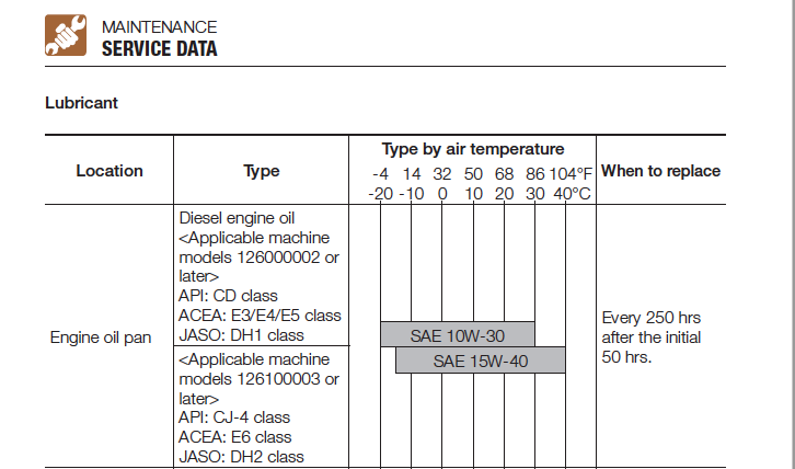

did you check the factory specs for replacement oil first?
15/40 doesnt seem to come up much anymore.

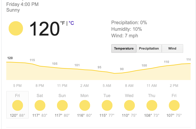

Ya I'm good - Also I live in extreme conditions for equipment. 120 degrees PLUS ambient temps, so you can imagine how much heat the engine is generating
