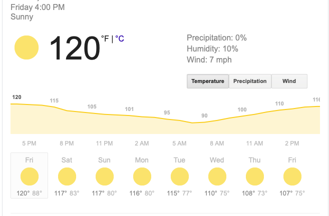

Ya I'm good - Also I live in extreme conditions for equipment. 120 degrees PLUS ambient temps, so you can imagine how much heat the engine is generating
120* :eek: I thought those temps were only in Death Valley. I looked up where Coachella is - just north of the Salton Sea, so I guess you might as well be in Death Valley.
