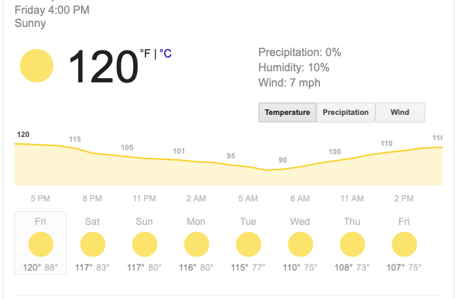

But another thought: The instant "blackness" of new oil in diesel engines can also be affected by how thoroughly you drain the old stuff out. IE, one half cup of residual sooty black oil left in the filter housing, pan, or block can make a fresh gallon of new oil look dirty right away once mixed back in. If your machine has a well designed oil system and you drained it out on a 120 degree day (YUCK, btw), I bet it drained very well and you got all the old thin junk out.

Last week I changed the oil min, my Excavator, after seeing the very thin viscosity oil the dealer had in the unit when I purchased it used. I replaced their oil with my favorite 15/40 oil mostly because of the temps here( been 117 - 122 all weel). Anyway, after running the machine for 10 hours in brutal conditions, I checked the oil and to my surprise, the oil was about as clean as when I put it it in. I did the old rub it between my finger "test" for viscosity and it was nice and thick unlike what I replaced which was as thin as hydraulic fluid.
