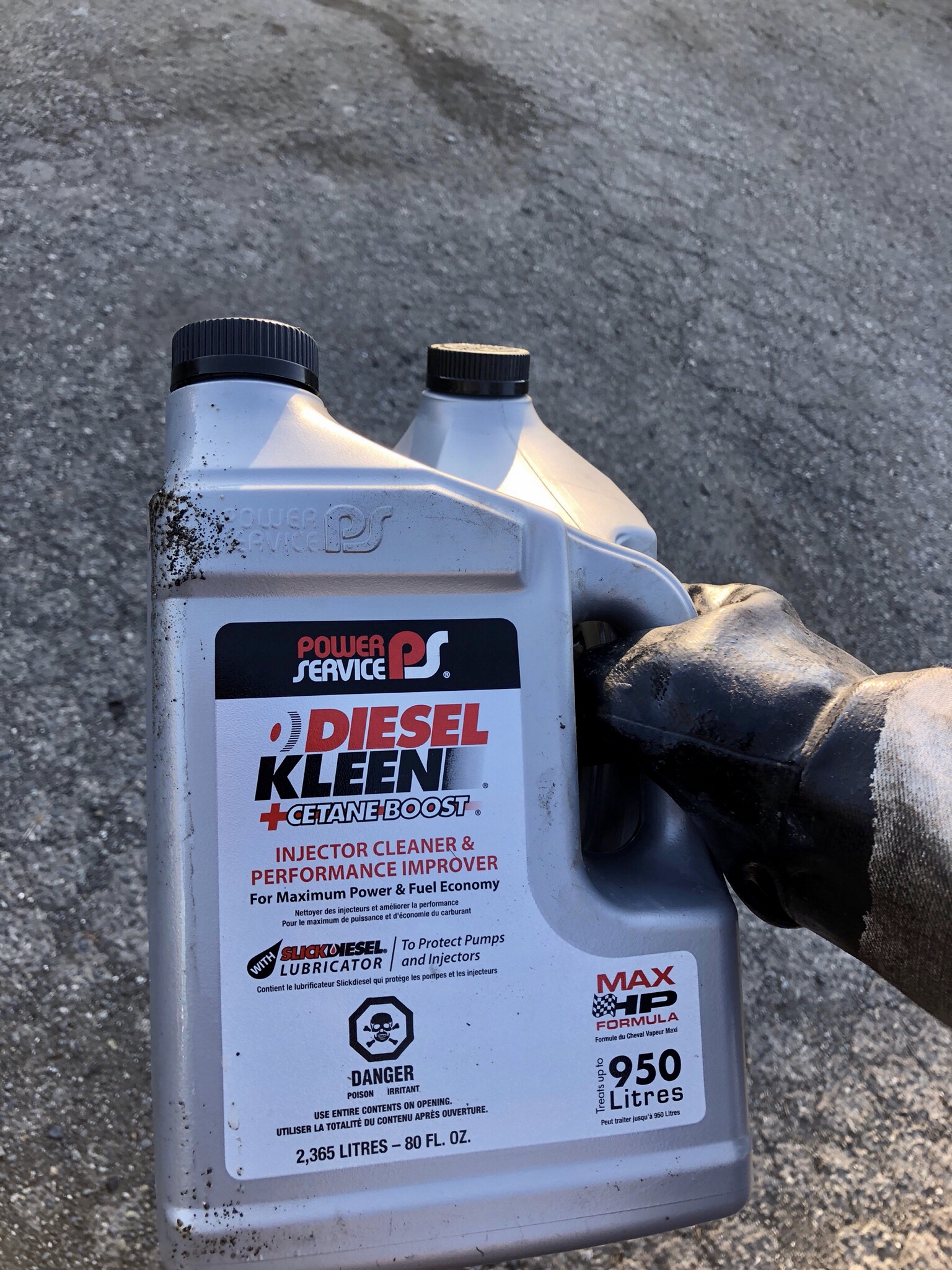

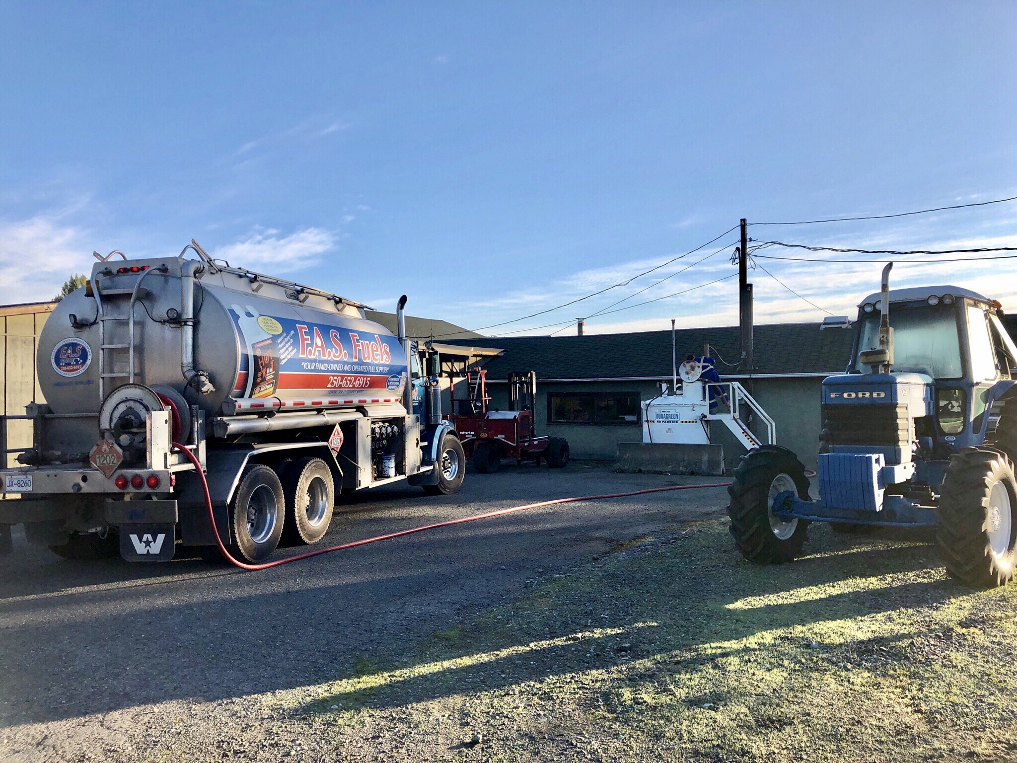

The last few years I don’t even have to think of Power Service anymore.
Whenever I get fuel delivered the driver dumps a jug in for me.
That way it gets done with every fill and I eliminates my OMS (old man syndrome) from trying to recall if I did it or not.
