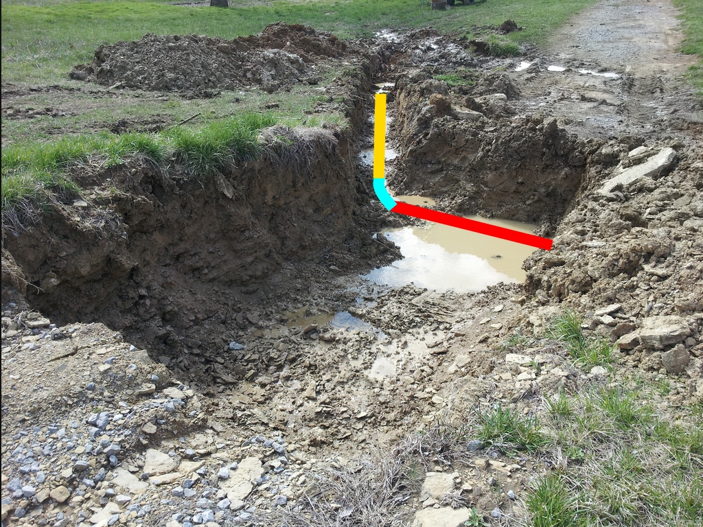

Hopefully I will not have to redo this any time soon, but live and learn! I have learned a lot in this process so far and everyone on this forum has been very helpful! Here is a pic today, I did a little more digging after this to smooth it out but this definitely relieved the water.

I think once you setup a french drain, covered with some type of fabric, along with a layer of larger rock mixed with some dirt - compacted to make a road base. Top it off with a few inches of gravel... you shouldn't have anymore problems.
With the amount of water you had, I would think about draining it twice. Use a 45* joint (in blue) with two drain pipes (red) tied to a solid pipe (in yellow). It would be best to try and locate where the water is coming from...

Here is what I was planning. My thinking was that I would run the perforated pipe at the lowest point.

That ought to work, just be sure to get deep enough to rid the ponding at the outlet, or it will eventually soak out on down the hill, following the path of least resistance.
