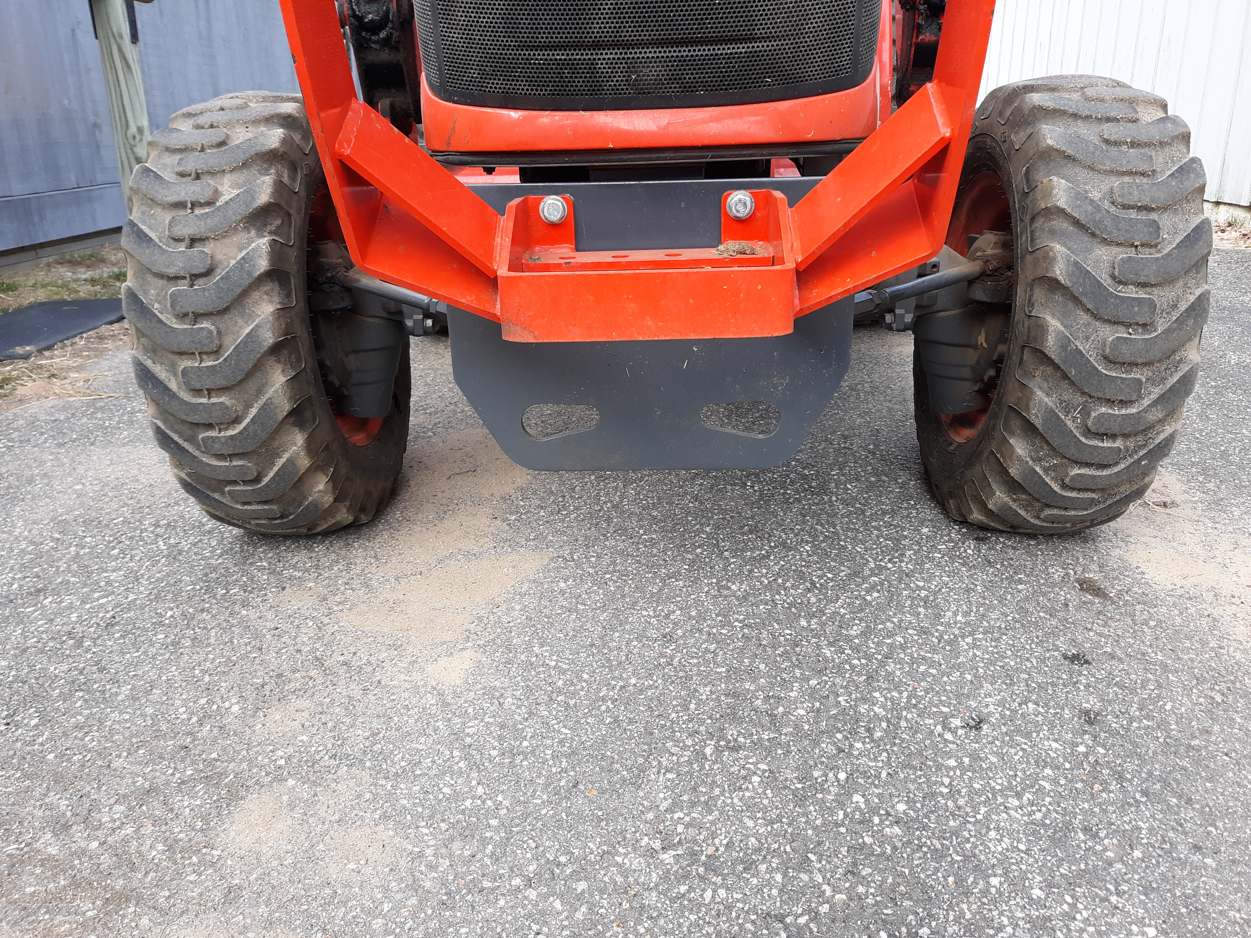

The front axle pivoting feature is provided by supporting the axle assembly by two hanger bearings. One also supports the front axle drive shaft.
The front axle differential case is lube by oil contained within the differential case by the seal I have marked in red.
The hanger bearings, while having seals, are lubed by grease and independent of the differential case.
Removing the grease fitting will reveal nothing of relevance to the differential leak.
Dave M7040
Thank you. So if that seal leaks gear oil, it would commingle with grease and leak gear oil , like what I’m seeing.
I just had an outer axle bearing replaced, not sure exactly which one, and I don’t want gear damage from loss of gear oil. I’m not sure if the bearing problem was related or a coincidence.
Sorry I’m not well informed as my friend handled all this and I don’t know details. But I would expect this drip will lead to a differential with no lubrication.

How hard is it (for a poor mechanic like me) to replace that seal?
   / What’s causing this drip? #13
Curbsider snake oil. Designed to hide problems, made to let you sell your vehicle quick on Craigslist.
Just wipe all the areas dry with a clean rag and wait for the leak to develop to identify the source. Right now it looks like the tractor was pressure washed and the loose grease was blown all around.
That is not loose grease dripping from the front axle trunnion. The front differential pinion shaft seal is leaking. The seal is fully shielded from dirt, dust and the elements. It should not be leaking. The oil contained in the front axle is the least expensive item in there by a wide margin. So whatever you do, make sure there is always enough of it in there.
It could be tricky because the front end of the tractor has to be supported to access the seal and the front axle needs to be supported independently as one of the hangers is being removed to access the seal.
If it were my tractor I would spend months monitoring the level and the degree of leakage and do nothing more until and unless the rate of leakage increased substantially.
A tractor or any vehicle without any drips is very rare after a number of years of service.
