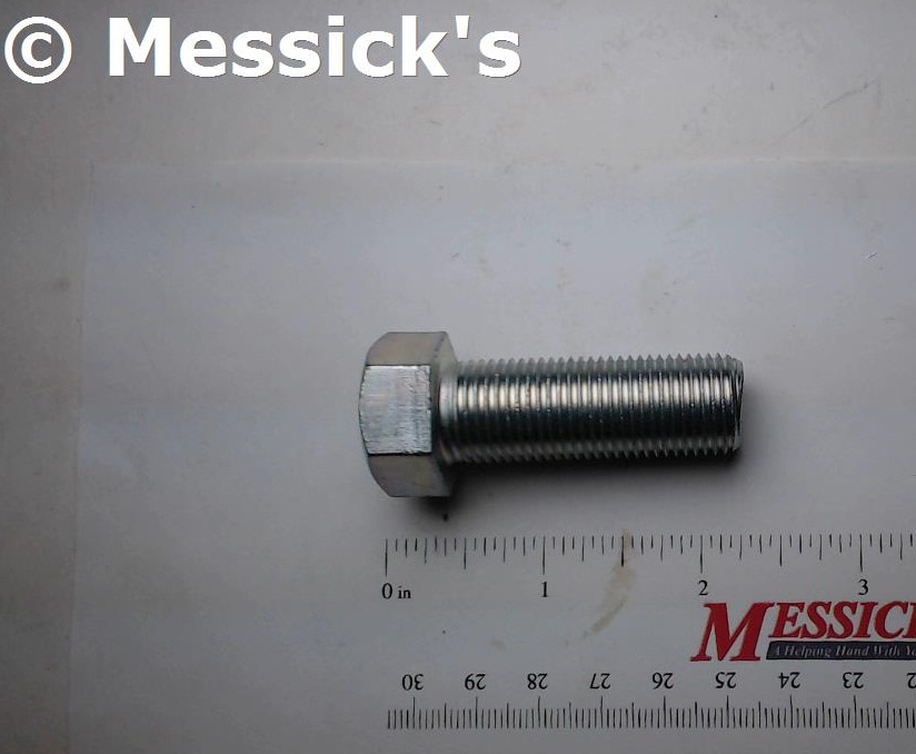

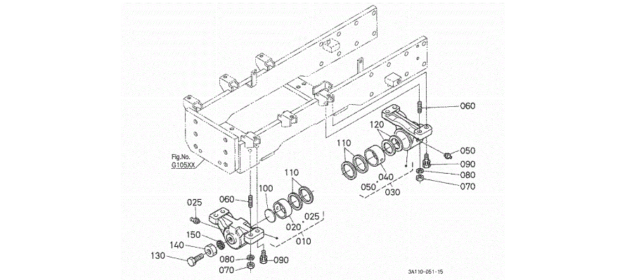

Look at the parts illustration in post #4.
There is no axle pivot bolt to adjust.
Dave M7040
Check again there is one look at the Messicks Parts 130 to 150
I surmised there was one, most Kubota Tractors has an adjustment bolt you set the axle pre-load with but I've refrained from arguing or pointing out Dave's mistakes, because no matter what it is, he's always right.

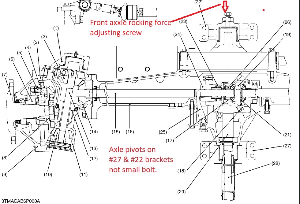

Flip aka 5030
If you took the time to read the thread from the beginning, you would have realized the issue for the owner was oil leaking from the front axle in the vicinity of the rear support and front drive shaft.
A suggestion was made it might help to eliminate the leak by tightening the pivot bolt.
My reply post was to show that the front 4WD axle did not pivot on a bolt as do some tractors but rather on large bosses forming part of the axle housing and the differential housing
Part #130 is not involved in supporting the pivoting of the front axle. It can do nothing to alleviate oil leaks from the differential area.
If you want to call a 2" long bolt a Pivot bolt ( see picture below) that is not what it is called: rather, from the M6800 WSM : If tightening torque is not within the factory specifications, adjust
the front axle rocking force adjusting screw (1).
All the above only in the interest of having accurate facts for all to review and decide on the merits.
Dave M7040
