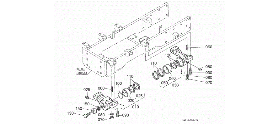

First thing to do is go through the manual and adjust the axle pivot bolt. It could have oil coming out of the front axle or it can travel down the front drive shaft tube from the seal on the transmission. Put 90 weight in all my front axles and a lot less seepage.
David
Look at the parts illustration in post #4.
There is no axle pivot bolt to adjust.

Check the oil level. How much oil to fill plug? Hours on the tractor? Consider changing to gear oil. Kubota mechanics recommend and I do this too.

Snake oil with almost a 5 star rating on Amazon, you have any idea how hard it is to get 5 stars on a product. I have used it on my front end outer knuckles 3 years ago and it's still working, if bearing are still tight the ATP AT-205 Re-Seal is a good choice, or if one likes to change seals every 300 hours that will work to.

Agree ... with the exception that I was well over 1000 hours when I used it several years ago.
No leaks since and over 2200 hours now ...
Good to hear from you again:) You have two times mores hr then I do wonder how you managed that. I had about 800 hr 3-4 years ago when my outer knuckles started leaking 1200 now, I dont mind wet but small puddles on floor bothers me so I figured if the bearings aren't gone and it's just seals its worth a try and did the trick for me to.
