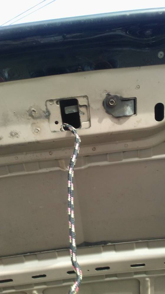

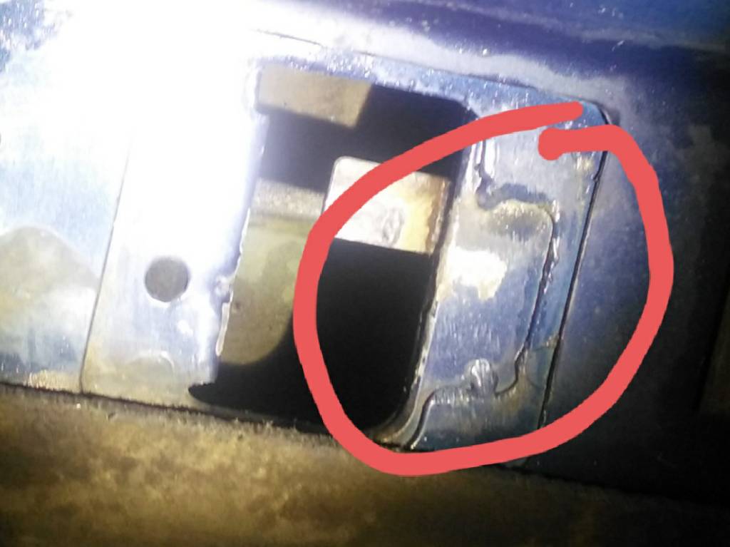

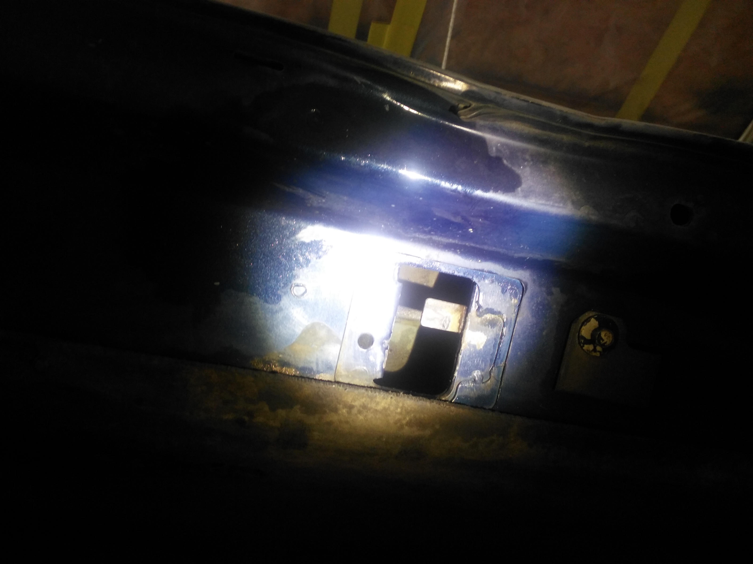

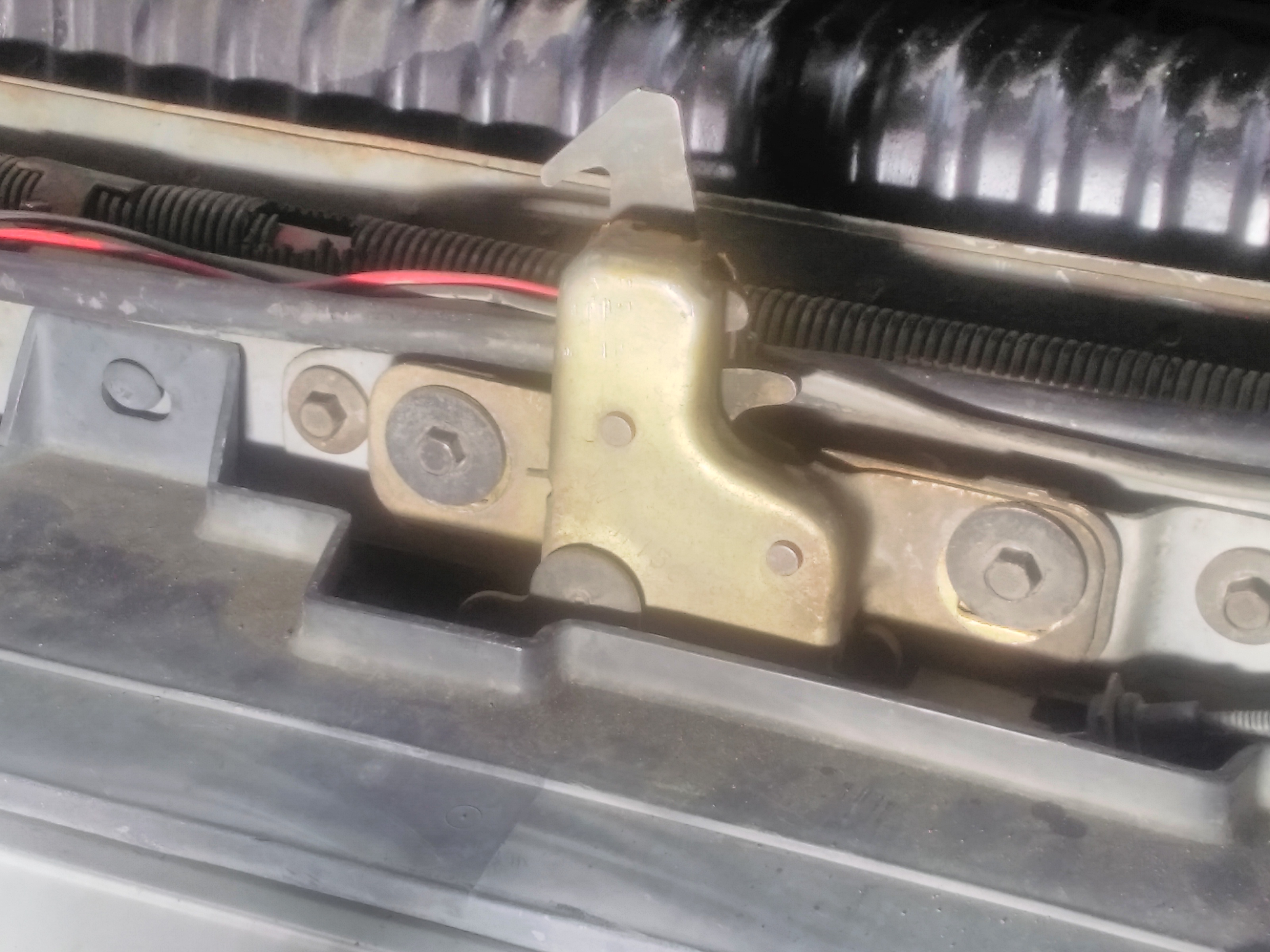

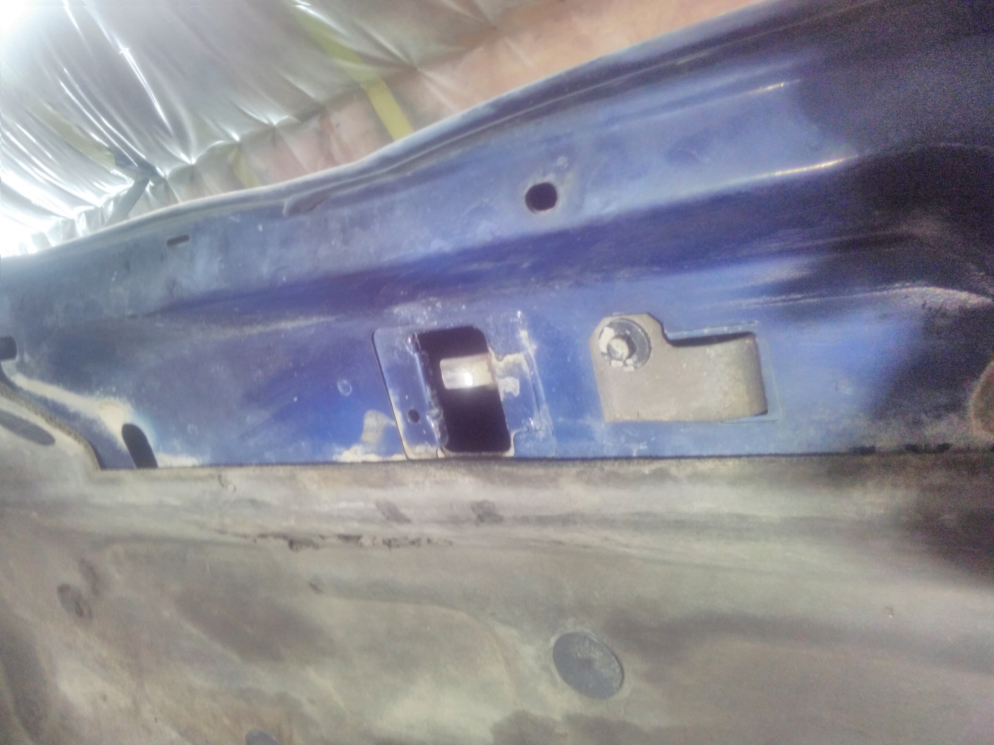

I am at Wits end, or maybe just Half-Wits end but I can't figure this out. 1991 Ford F-350: The hood won't latch and I can't tell if I'm missing a part of not.
I've spent hours on the internet and pouring through old Motors Manuals and can't find a single picture of the underside of the hood, to see what is supposed to be there. The latching part down by the radiator is fine.
Any photos or diagrams would be much appreciated. Thanks.
The striker rod, 'loop' is missing.
We have finally figured that out but still haven't been able to source one outside of a wrecking yard. I will have to make one.
   / What am I Missing? 1991 Ford F-350 hood latch #39
Yes sir, most are manufactured press welded to the hood.
You might be able to cut a donor out of a wrecked hood as opposed to buying a complete used hood.
