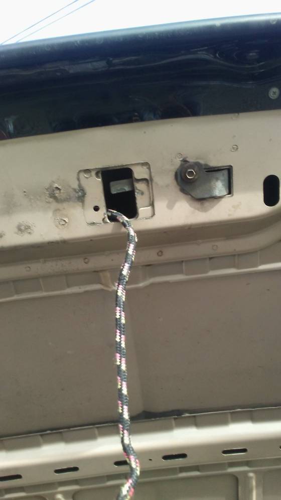

The thing that goes thru my mind, is on all of my 66 years, I have never had to replace one of those, Never seen anyone else replace one, or heard of replacing one. Of course that part of the hood arrives first in any kind of a frontal wreck, but usually the whole hood needs replacement not that striker. I am puzzled by what could have happened to the striker, unless someone took it off because they needed one to repair a wrecked hood or something. That is one part that just seems like it would last 10 car lifetimes. :)
   / What am I Missing? 1991 Ford F-350 hood latch
#46

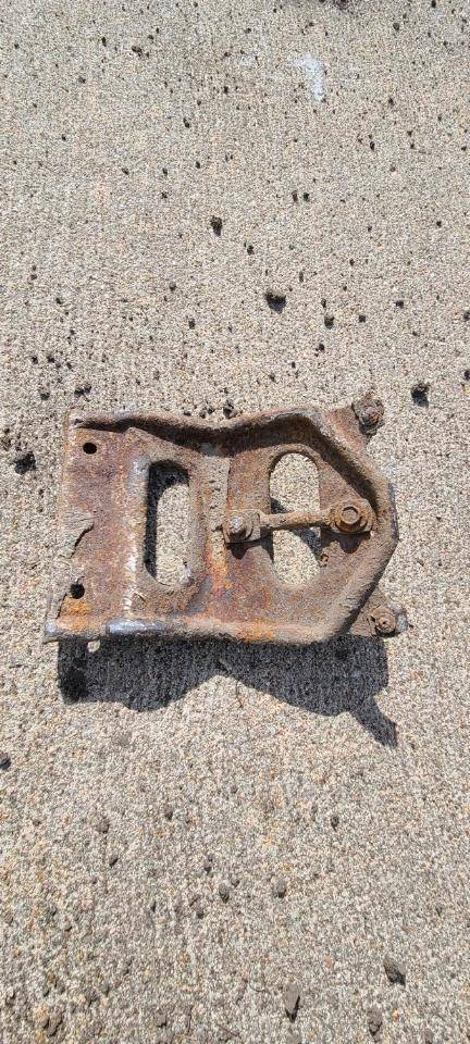

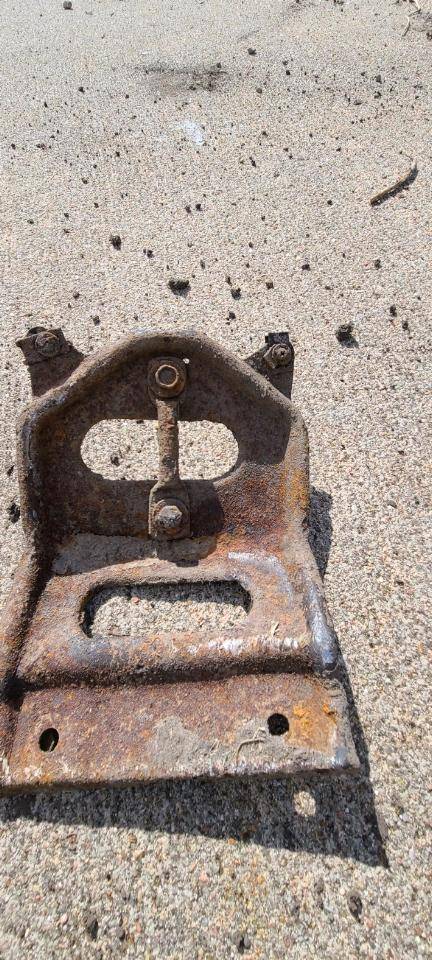

I think you are correct. I have never seen a broken latch striker either. Not the end of the world if I can't fabricate or locate one since it is not a on-highway rig but I hate having anything not working as it should.
   / What am I Missing? 1991 Ford F-350 hood latch #47
Oh, I agree wholeheartedly. I would want it fixed too and fixed right. I am just at a loss as to how it got the way it is. I have just never seen one of these parts missing. All I can think of is someone took it off for some reason.
   / What am I Missing? 1991 Ford F-350 hood latch #48
It's been a while since I've owned that body style ford, but I dont think anything is missing on the hood side.
The flat area with the witness mark is the latching area if i remember correctly.
It appears the leading edge of the hood has some damage? It doesn't take much to keep these truck from latching.
   / What am I Missing? 1991 Ford F-350 hood latch #49
How about if we take some good outside in the sunshine photographs of both the hood and the latch near the radiator so we all can get an idea of what goes where and how this thing is supposed to work..
   / What am I Missing? 1991 Ford F-350 hood latch #50
Here's a pic I found from a 92 F150 (same hood). The mark in the small recessed and reinforced area should be where it latches. 20180411_091905_da041c01107e4633b7b9a73dcab8820eb4576dd8.jpeg
