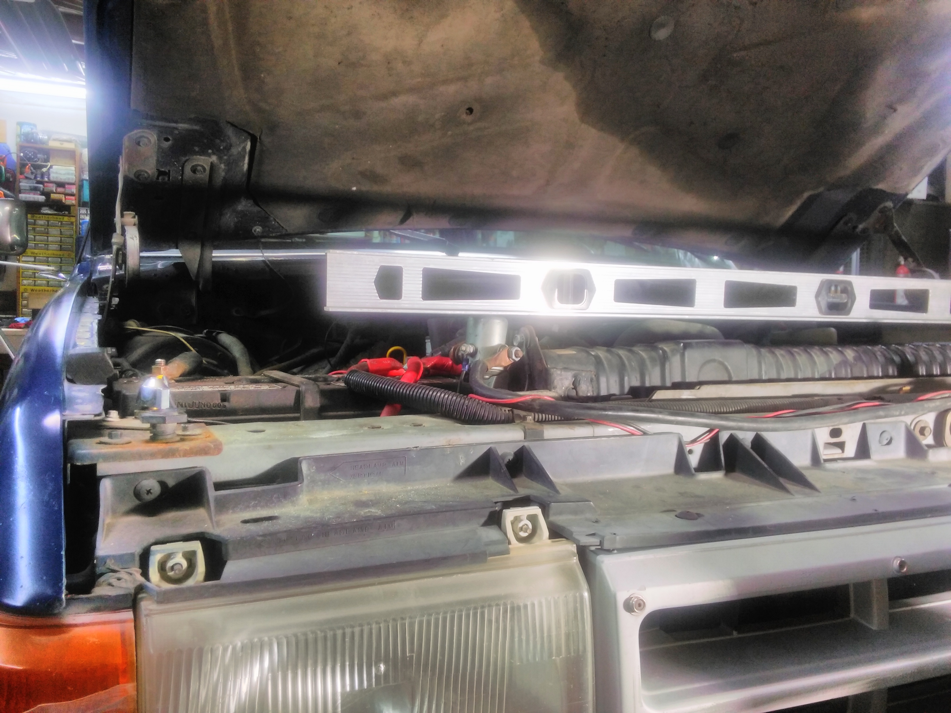

Makes no sense to me. Does the lower latch just catch on the edge of the hole in the hood?
Perhaps my snowplow solenoid is sticking up just a little to high (about 3/4" above everything else). The only adjustments I see for anything are at the lower latch. IMG_20201015_091037_hdr.jpg

Again... your picture & the picture in post #50 look exactly like my functioning hoods do.
You are missing NOTHING.
The latch hooks on the hood under the spring. NO extra pieces.
Thanks. I lost a lot of hair thinking on this. I will try some adjustments.

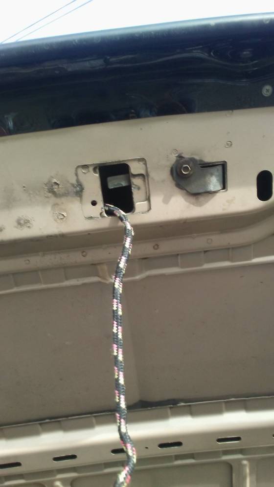

Here's a pic I found from a 92 F150 (same hood). The mark in the small recessed and reinforced area should be where it latches.View attachment 673145
Sorry. You are absolutely correct. I can't believe I didn't see this sooner. Thanks for not giving up on me and reposting.

I just moved the Latch out a little for the photo. It operates properly.
If the latch is staying in that position it might be sticking or the spring is broken.
Your latch looks cleaner then most I'm use to, maybe it was replaced and not adjusted properly.
When you close the hood does is go down all the way and pop back up or does it stop before it's closed? If it stops does it fell like its rocking on the latch in the center?

I just didn't want to looking for the non existent catch the rest of your life lol
